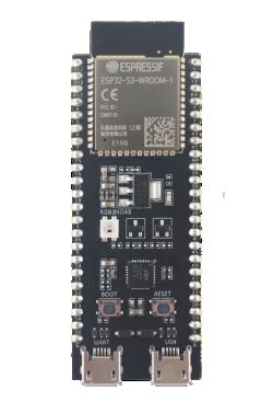

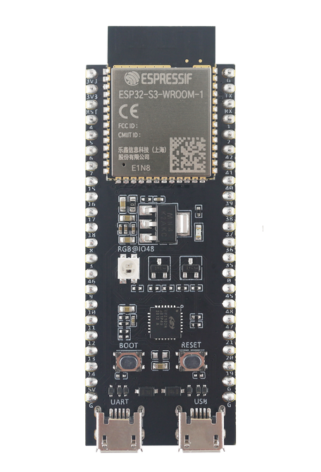

    In my opinion, the best place to start is with the ESP32-S3. It has everything that the other chips in the ESP32 family have. Of course, many people start with a 'traditional' ESP32, but mainly because of the low cost. The cost ESP32-S3-DevKitC-1 on ali is about 30 PLN (16MB FLASH 8MB PSRAM), in Poland about 50 PLN. This is the official Espressif module.
    ESP32-S3-DevKitC-1 board with USB-C ports, BOOT and RESET buttons .

    And how is the 3.3V supply in them, do these boards have a power supply
    The total current consumption should not exceed 0.5A (at continuous consumption). This is mainly due to the limited heat dissipation from the LDO in these modules. The module itself can draw 0.3A at 'peak', so there is little left for external circuitry.
    This applies to basically all modules in the DevKitC series.

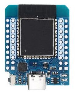

    if you search for a breakout module with USB-C take this: Wemos D1 Mini ESP32
    Which cheap and developmental ESP32 module to choose? Brief characteristics and opinions
    I like that because it has a small form factor and even though most of the important pins are broken out. A push button and GPIO controllable LED is available. You can supply the board with 5V (either via USB or directly). Low current devices can use the on board generated 3.3V directly.

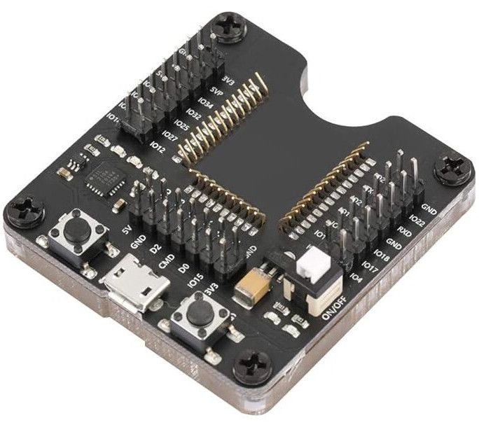

    otherwise if current in deep sleep is an issue use the castellated ESP-WROOM-32 directly. Current in deep sleep measured across 10k shunt: 6uA. Nice for battery operated devices as my: ESP32 based remote control or ESP32 WiFi display for inside and outside temperatures
    all 'basic' features are available:
    ESP-WROOM-32 datasheet
    both variants available for about 5€ per piece. I've seen the D1 Mini for no more than 3€ in our favorite Chinese Warehouse :-)
    UPDATE:
    forgot to say for development with ESP-WROOM-32 modules these adapters have proven to be very useful:
