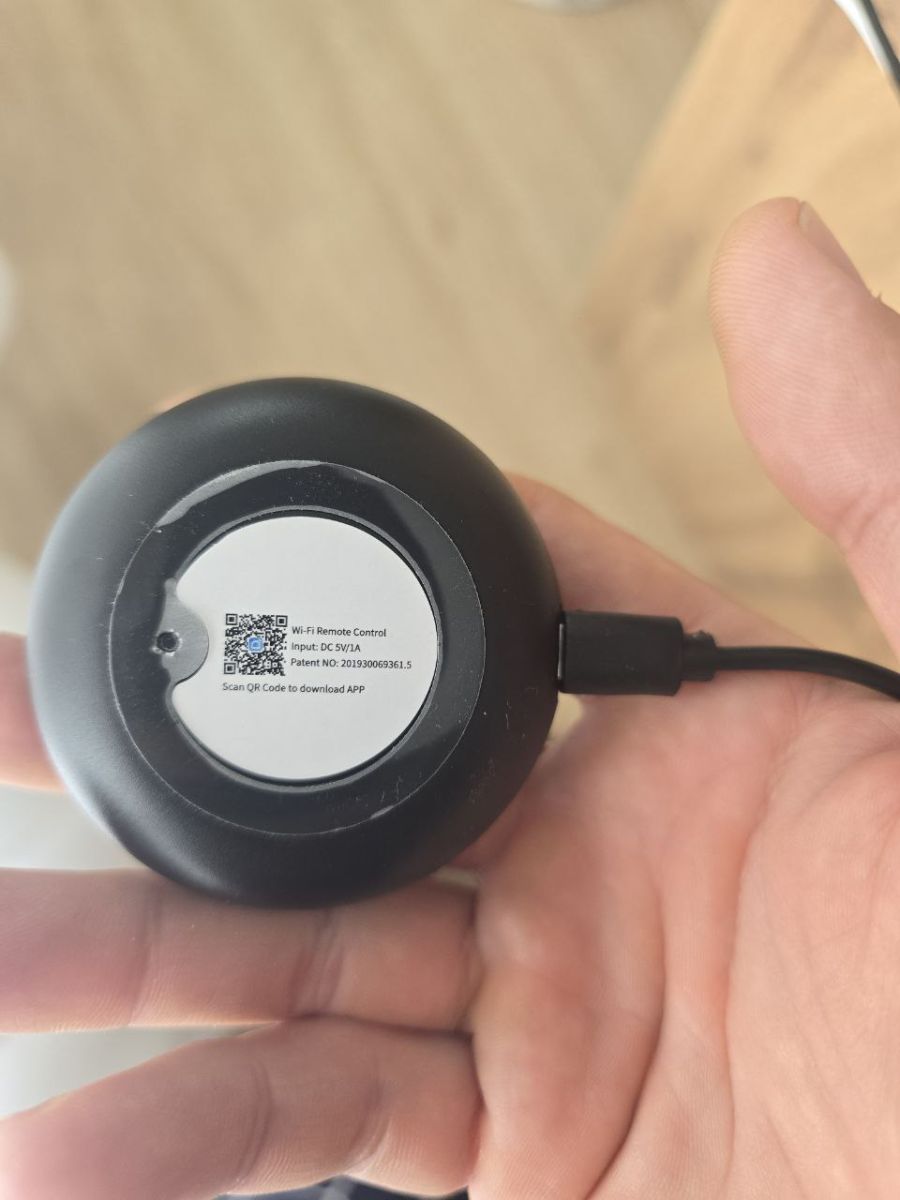

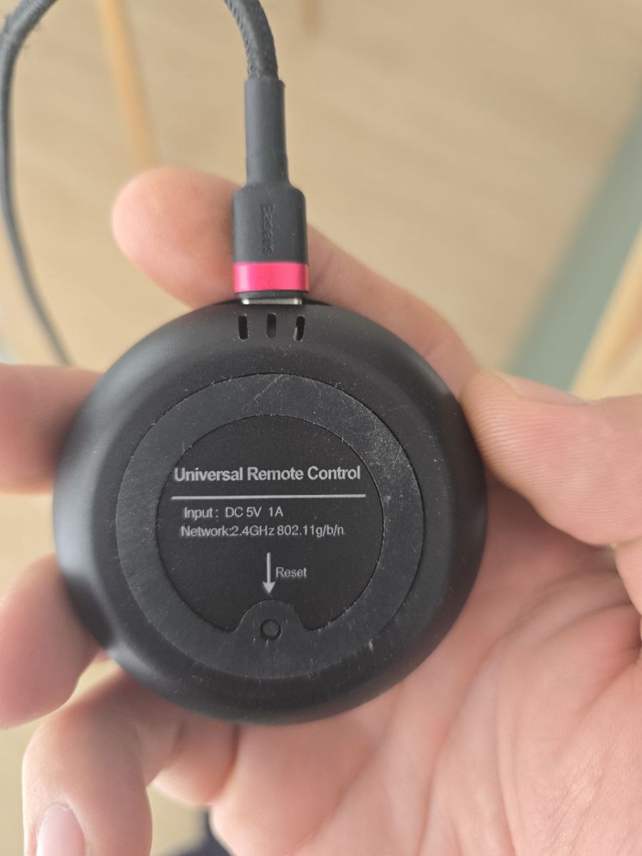

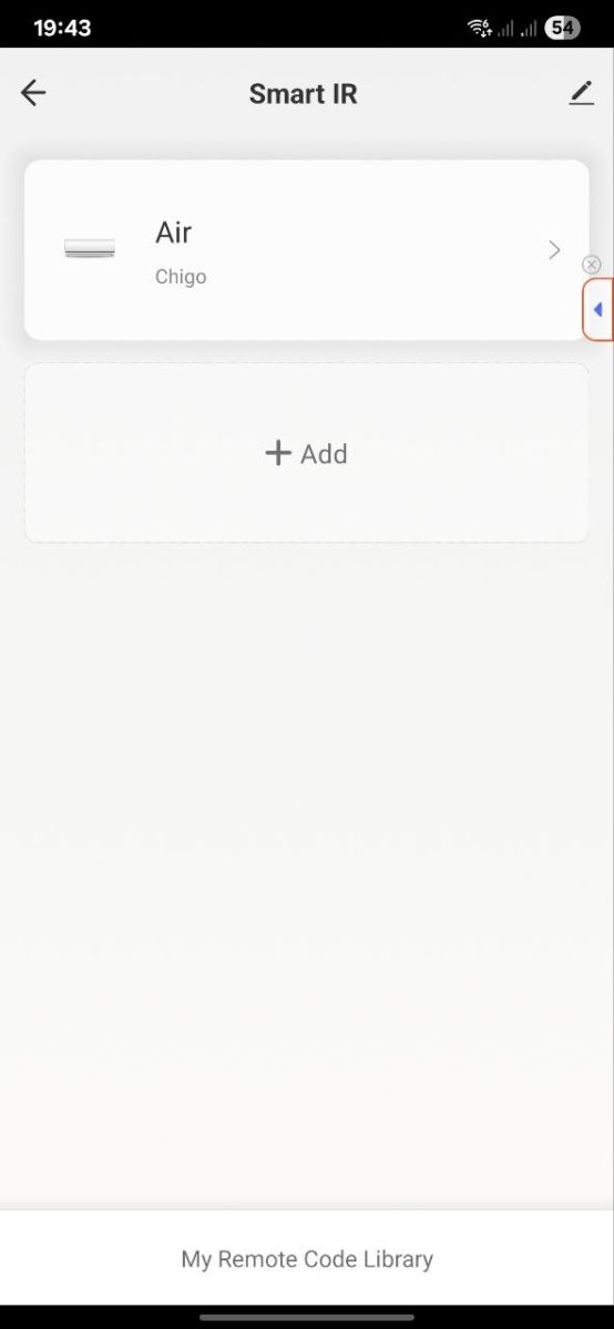

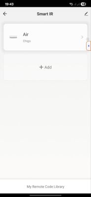

    Hello, i tried to learn my ir remote controller.
    my air conditioner NEOLINE (in tuya it - CHIGO) - from tuya work ok.
    Info:IR:IR GOODWEATHER 0 0 1
    Info:IR:IR GOODWEATHER,48,0x552436000000
    Info:MQTT:Publishing val 3f,0x552436000000,48 to homeassistant/ir/get retain=0
    Info:IR:IR MQTT publish IR GOODWEATHER,48,0x552436000000 took 3ms
    Info:MQTT:Publishing val {"IrReceived":{"Protocol":"GOODWEATHER","Bits":48,"Data":"0x552436000000"}} to homeassistant/RESULT retain=0
    Info:MQTT:MQTT client in mqtt_incoming_publish_cb topic homeassistant/ir/get
    Info:MAIN:Time 619, idle 118019/s, free 68480, MQTT 1(2), bWifi 1, secondsWithNoPing -1, socks 2/38
    Info:IR:IR GOODWEATHER,48,0x552434000000
    Info:MQTT:Publishing val 3f,0x552434000000,48 to homeassistant/ir/get retain=0
    Info:IR:IR MQTT publish IR GOODWEATHER,48,0x552434000000 took 2ms
    Info:MQTT:Publishing val {"IrReceived":{"Protocol":"GOODWEATHER","Bits":48,"Data":"0x552434000000"}} to homeassistant/RESULT retain=0
    Info:MAIN:Time 620, idle 108566/s, free 68480, MQTT 1(2), bWifi 1, secondsWithNoPing -1, socks 2/38
    Info:GEN:dhcp=0 ip=192.168.1.233 gate=192.168.1.1 mask=255.255.255.0 mac=4c:a9:19:be:1e:0f
    Info:GEN:sta: 1, softap: 0, b/g/n
    Info:GEN:sta:rssi=-61,ssid=Home_Z,bssid=24:0f:5e:00:52:66,channel=1,cipher_type:CCMP
    Info:IR:IR Unknown ffffffff,0x7E4997B4,99
    Info:MQTT:Publishing val ffffffff,0x7E4997B4,99 to homeassistant/ir/get retain=0
    Info:IR:IR MQTT publish IR Unknown ffffffff,0x7E4997B4,99 took 3ms
    Info:MQTT:Publishing val {"IrReceived":{"Protocol":"UNKNOWN","Bits":99,"Data":"0x7E4997B4"}} to homeassistant/RESULT retain=0
    Info:MAIN:Time 621, idle 116845/s, free 68480, MQTT 1(2), bWifi 1, secondsWithNoPing -1, socks 2/38
    Info:IR:IR Unknown ffffffff,0x85BCC9D0,99
    Info:MQTT:Publishing val ffffffff,0x85BCC9D0,99 to homeassistant/ir/get retain=0
    Info:IR:IR MQTT publish IR Unknown ffffffff,0x85BCC9D0,99 took 3ms
    Info:MQTT:Publishing val {"IrReceived":{"Protocol":"UNKNOWN","Bits":99,"Data":"0x85BCC9D0"}} to homeassistant/RESULT retain=0
    if I try to send - say "OK", no actions on contioner.
