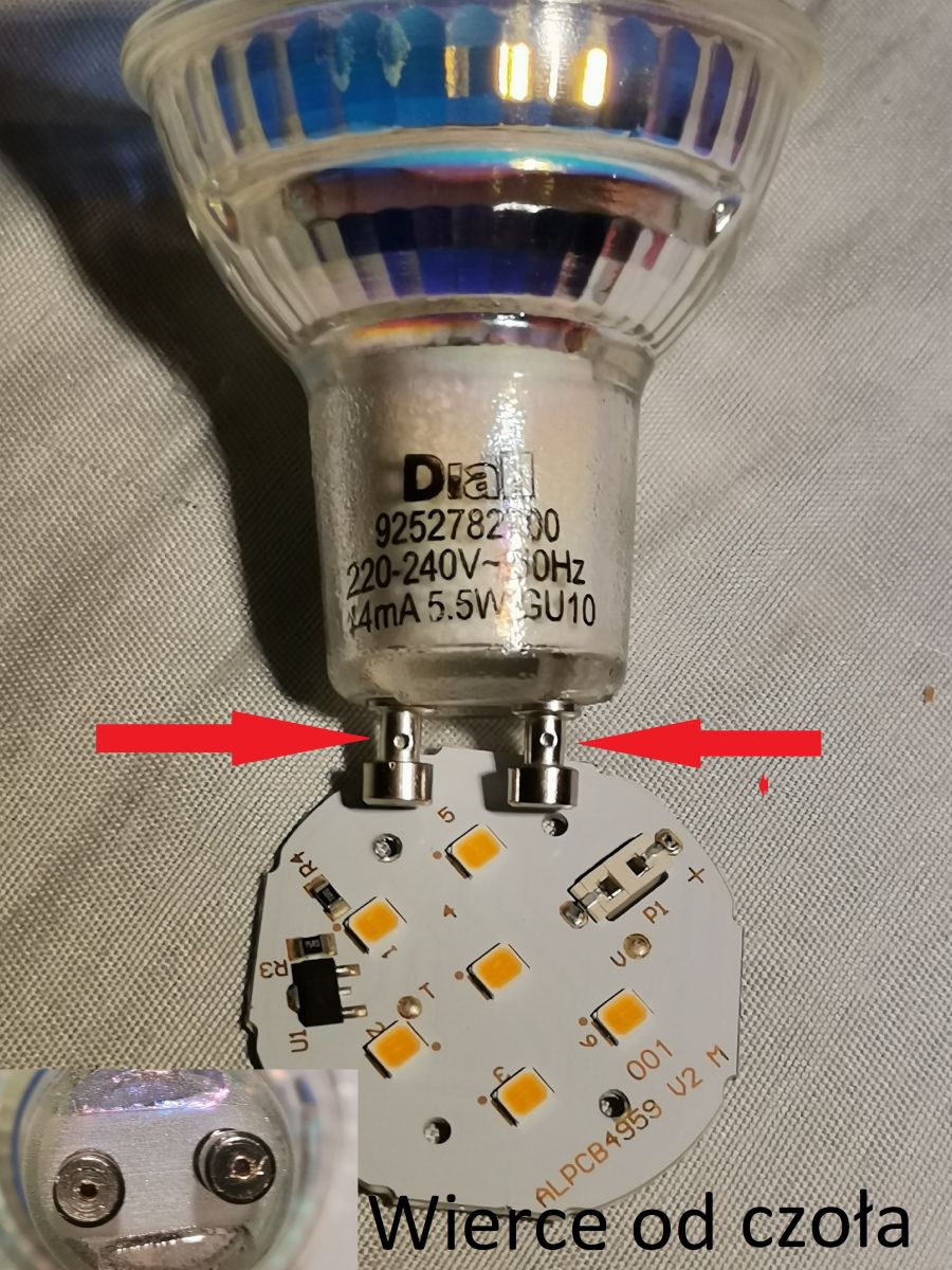

    I disassemble with force when there is no way to desolder and possibly then drill holes in the pins for new wires when I manage to fix the LED and solder or crimp new longer wires....

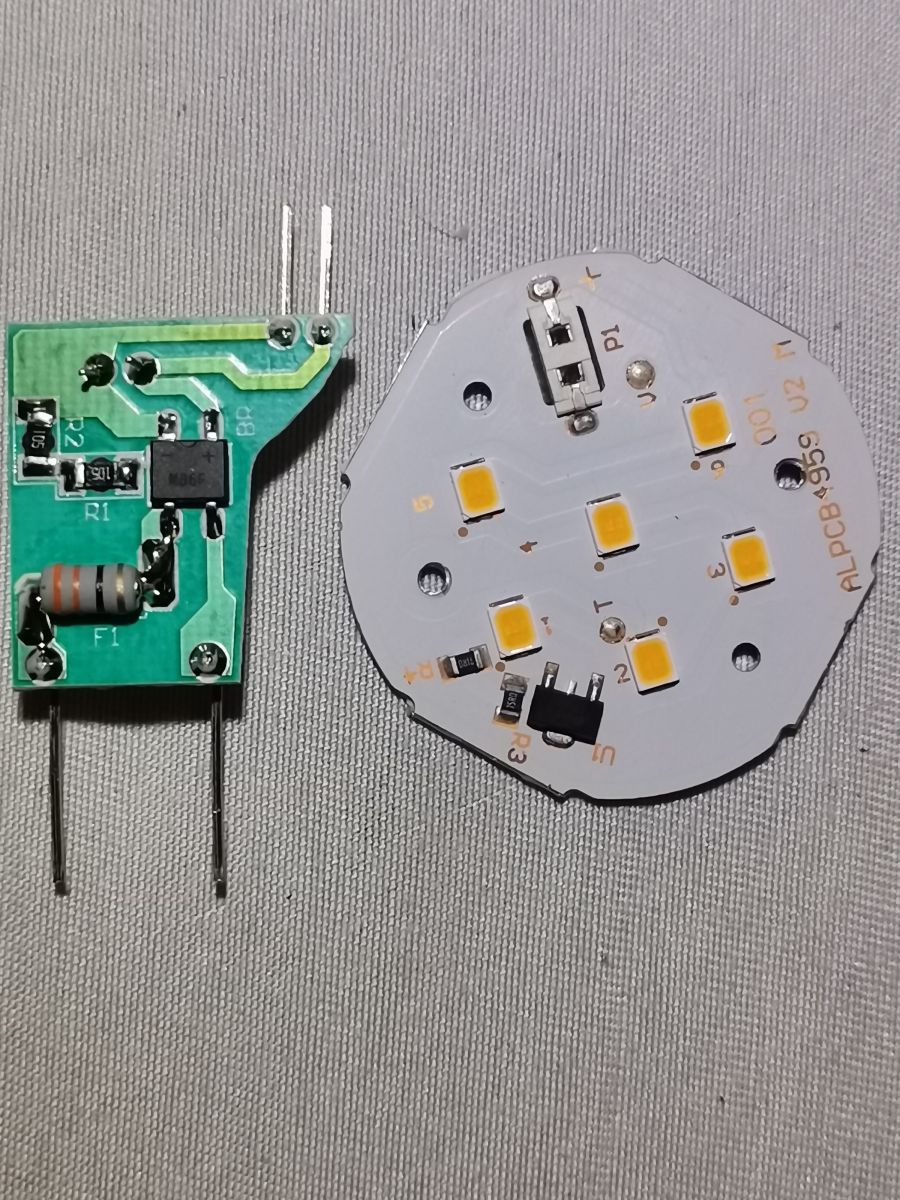

    Unfortunately, sometimes you have to open one copy violently to find out how to deal with the next ones.... The ones with slides are the hardest to open harmlessly.... Sometimes you can see where the crimp is, drilling from the front with a 1mm drill bit helps:

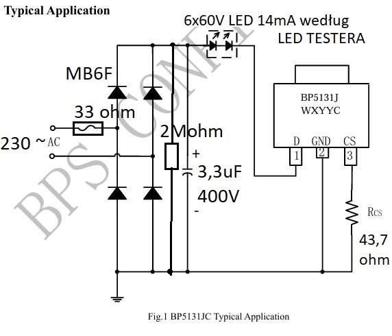

    Disassembled GU10 LED bulb showing PCB and drilling points on power pins Two disassembled LED electronic modules on fabric background Typical BP5131IJ application circuit with 230V input and 6×60V LED string
    gandi69 wrote:
    I was just wondering if I'm missing something.
    It's worth getting a LED tester, and a heater to replace them on boards with aluminium heat sinks, and it's also worth having a replacement LED, but there are so many varieties, it's better to find out which ones you need first...
