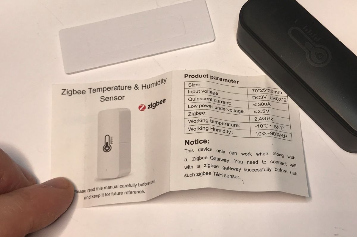

    So let's see what we get in the kit. In addition to the sensor, it includes instructions and a strip of double-sided tape.
    Instruction manual and black Zigbee temperature and humidity sensor on white background Zigbee sensor setup instructions shown with app screenshots and pairing steps

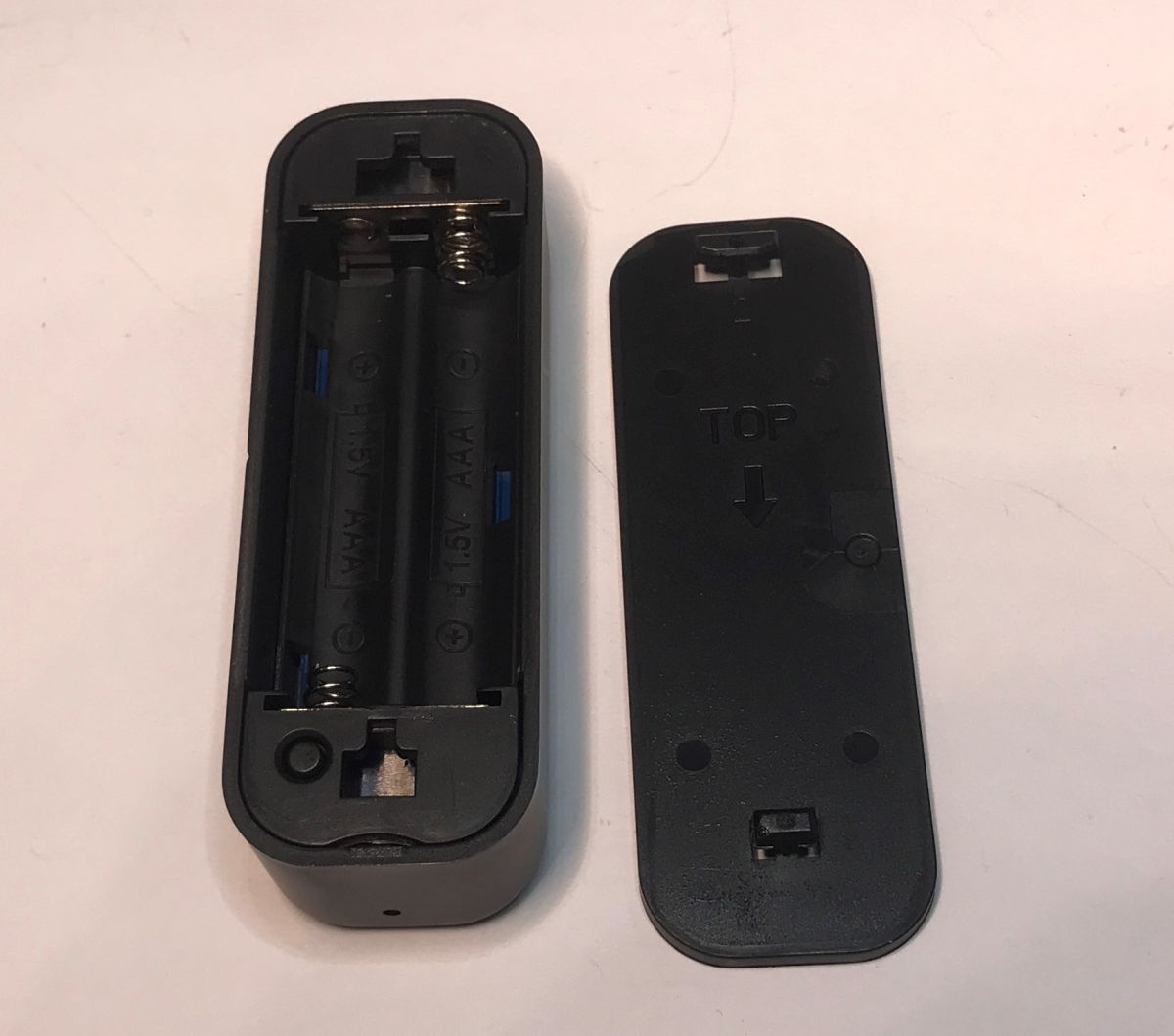

    The sensor itself requires two AAA batteries:
    Open TH08 sensor casing with compartment for two AAA batteries visible

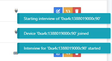

    On the HA side, I use Zigbee2MQTT. I simply allow pairing and press a button on the device as instructed:
    Zigbee device pairing process with Home Assistant shown on screen
    HA correctly detects the device as TS0201 (TH02Z):

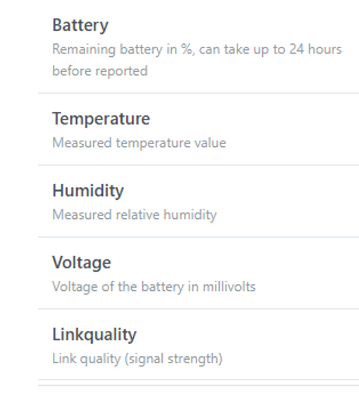

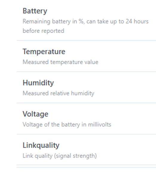

    Variables provided include battery level (in %), battery voltage (V), temperature and humidity.
    TH08 sensor data list: battery, temperature, humidity, voltage, signal quality

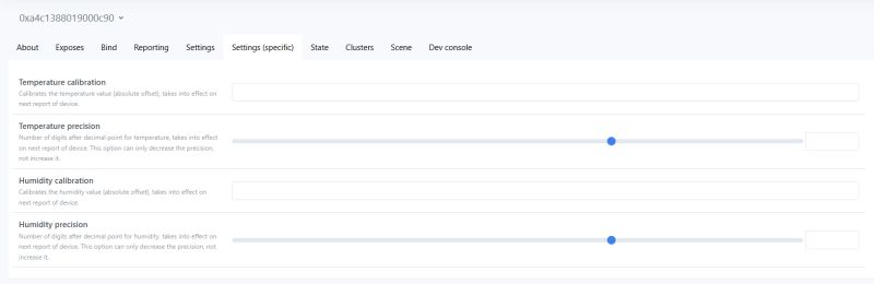

    Interestingly, here we also have control over temperature and humidity calibration. The 'precision' option allows you to specify the number of digits after the dot, it will not improve the actual precision of the reading.
    Calibration and precision settings for Zigbee temperature and humidity sensor
    That's basically it - the device is ready for operation as soon as it is paired.

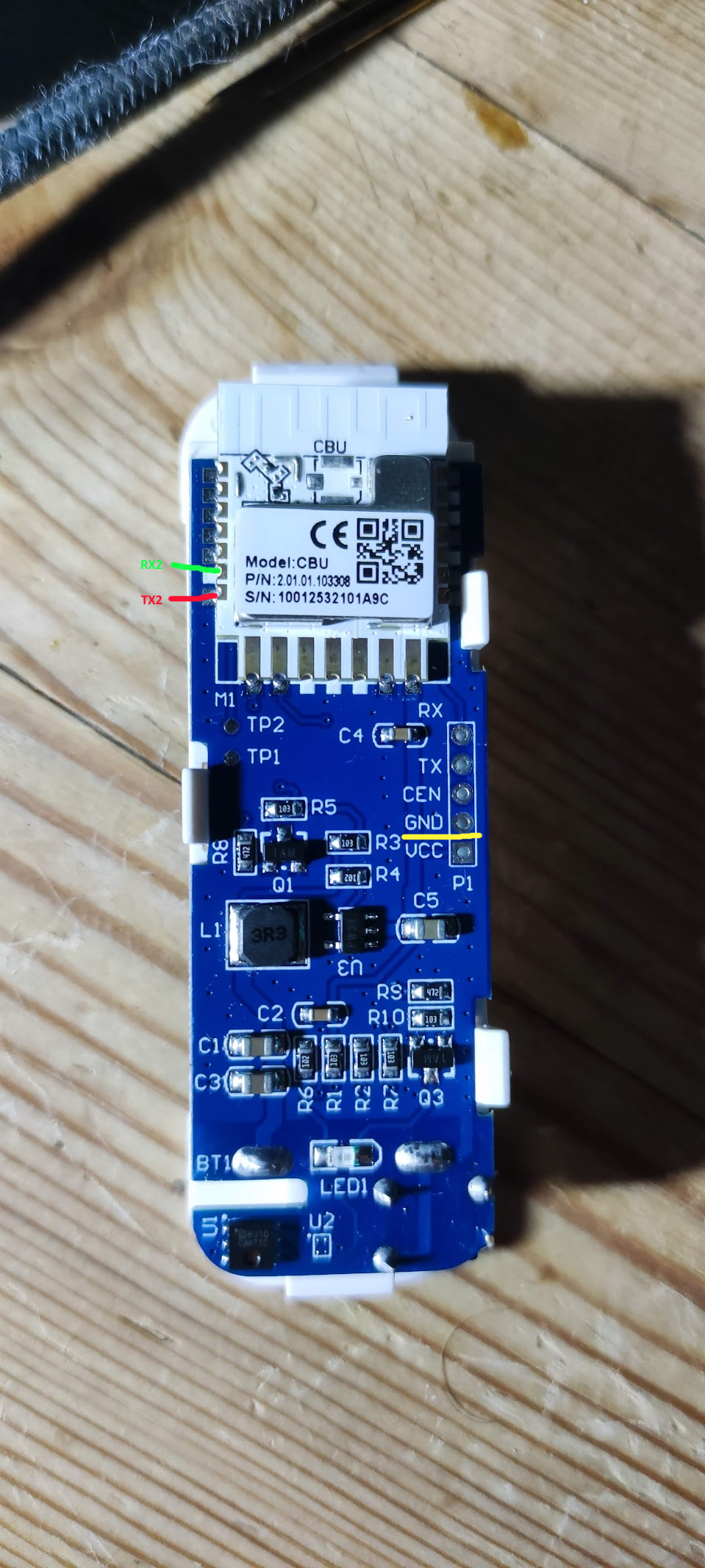

    Let's compare the construction TH08 with the device from the subject:
    Wi-Fi TH08 sensor PCB with CBU module and labeled TX2, RX2 pins Zigbee sensor PCB with ZTU module and labeled electronic components

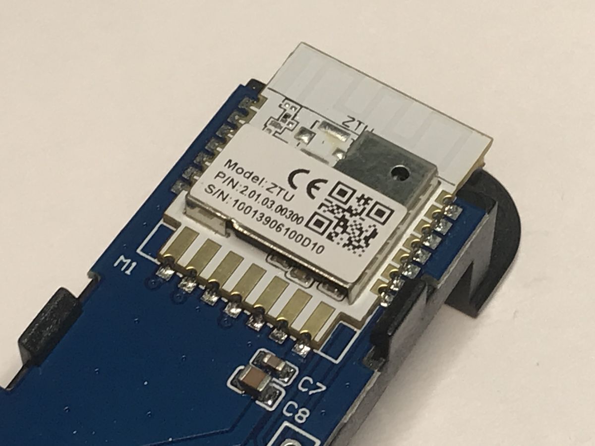

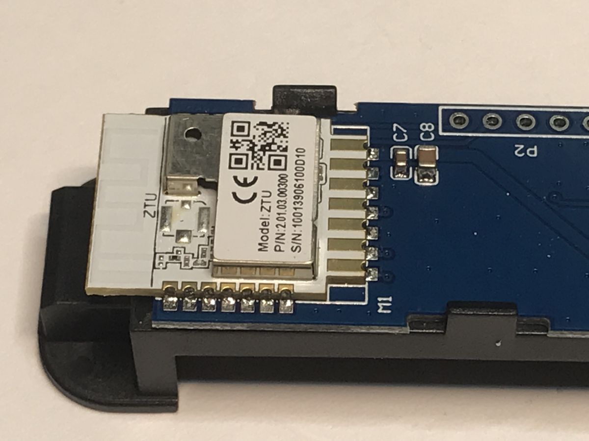

    The version with Wi-Fi is based on the CBU module (BK7231N). In addition it has a coil circuit that looks like an inverter to me. Presumably the Wi-Fi module doesn't want to work very well on low voltages, so the inverter makes sure there's that 3.3V and not less - without it, the voltage drops as the battery discharges.

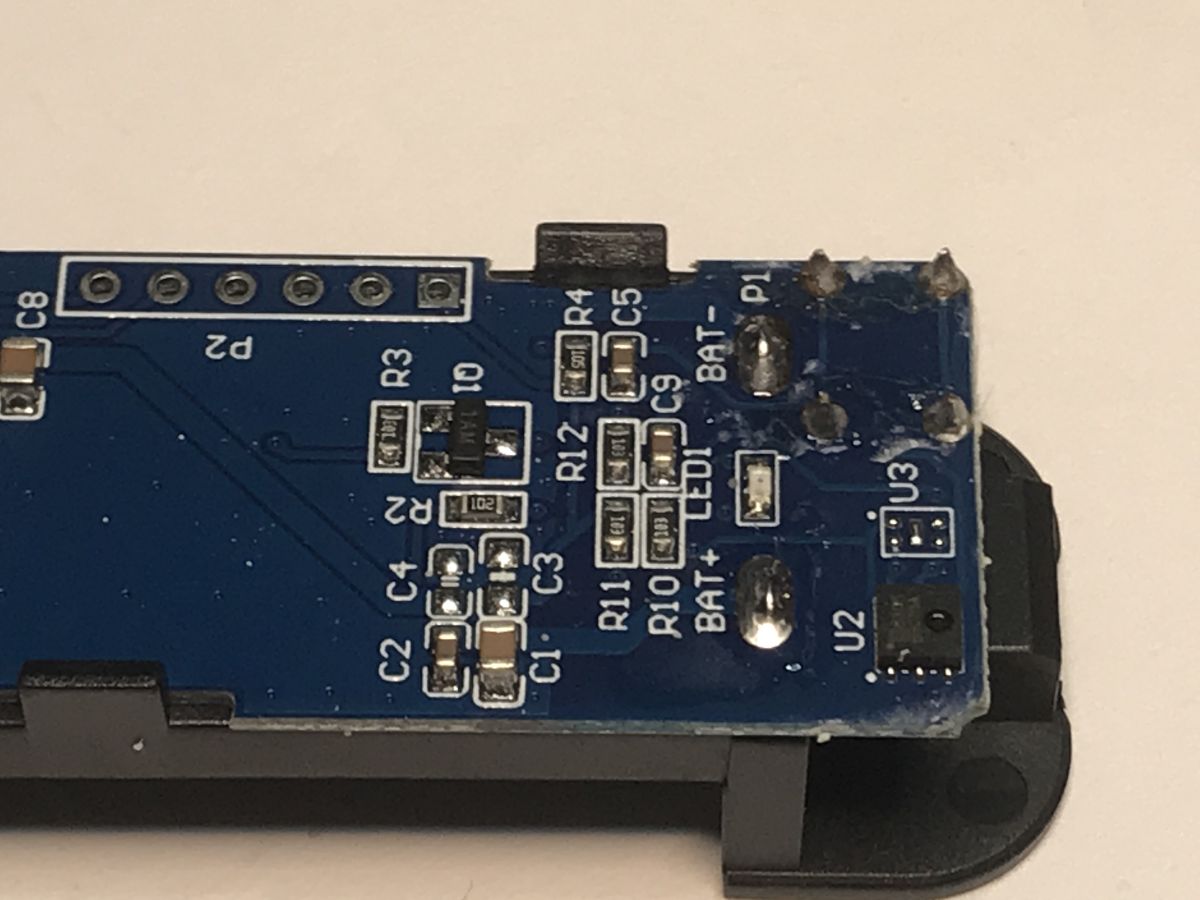

    The Zigbee version is based on the ZTU module. Both modules have compatible leads and the boards look similar, although here there is no inverter. The Zigbee-based circuit is simpler and therefore more efficient.
    According to Tuya's specifications, the CBU operates at voltages from 3.0 to 3.6V, while the ZTU can operate as high as 1.8V to 3.6V (although a voltage higher than 2.8V is recommended). This also explains the differences in construction.
    Close-up of the TH08 sensor PCB with labeled components and visible solder joints Zigbee ZTU module on a sensor board, with visible electronic components and QR code. Zigbee ZTU module on a PCB with labels and soldered connectors Close-up of Zigbee sensor PCB with labeled components and visible soldering points. Close-up of Zigbee sensor PCB with labeled components and visible soldering points.
    The sensor itself appears to be the same model in both devices.

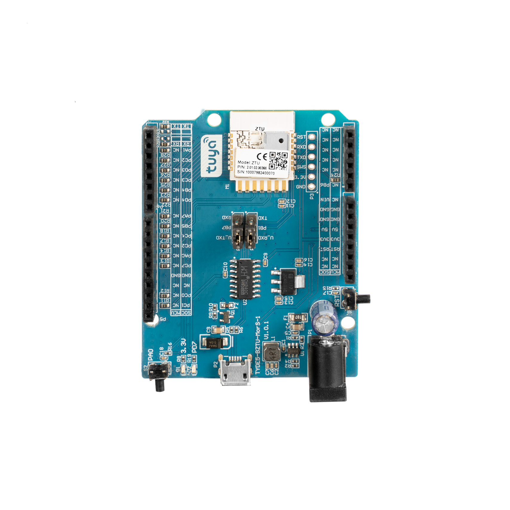

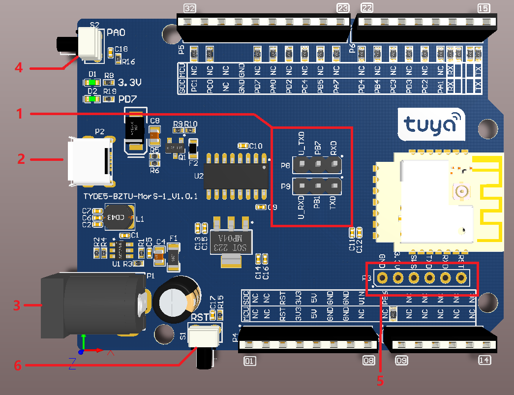

    ZTU pinout:
    ZTU module pinout diagram showing GPIO labels and signal lines.
    15B1I/OUart_TXD, which corresponds to B1 (Pin 6) of IC
    16B7I/OUart_RXD, which corresponds to B7 (Pin 17) of IC
    I didn't try doing ZTE flash dump yet, but I tried with other Zigbee chip - BL702 - and it worked well.

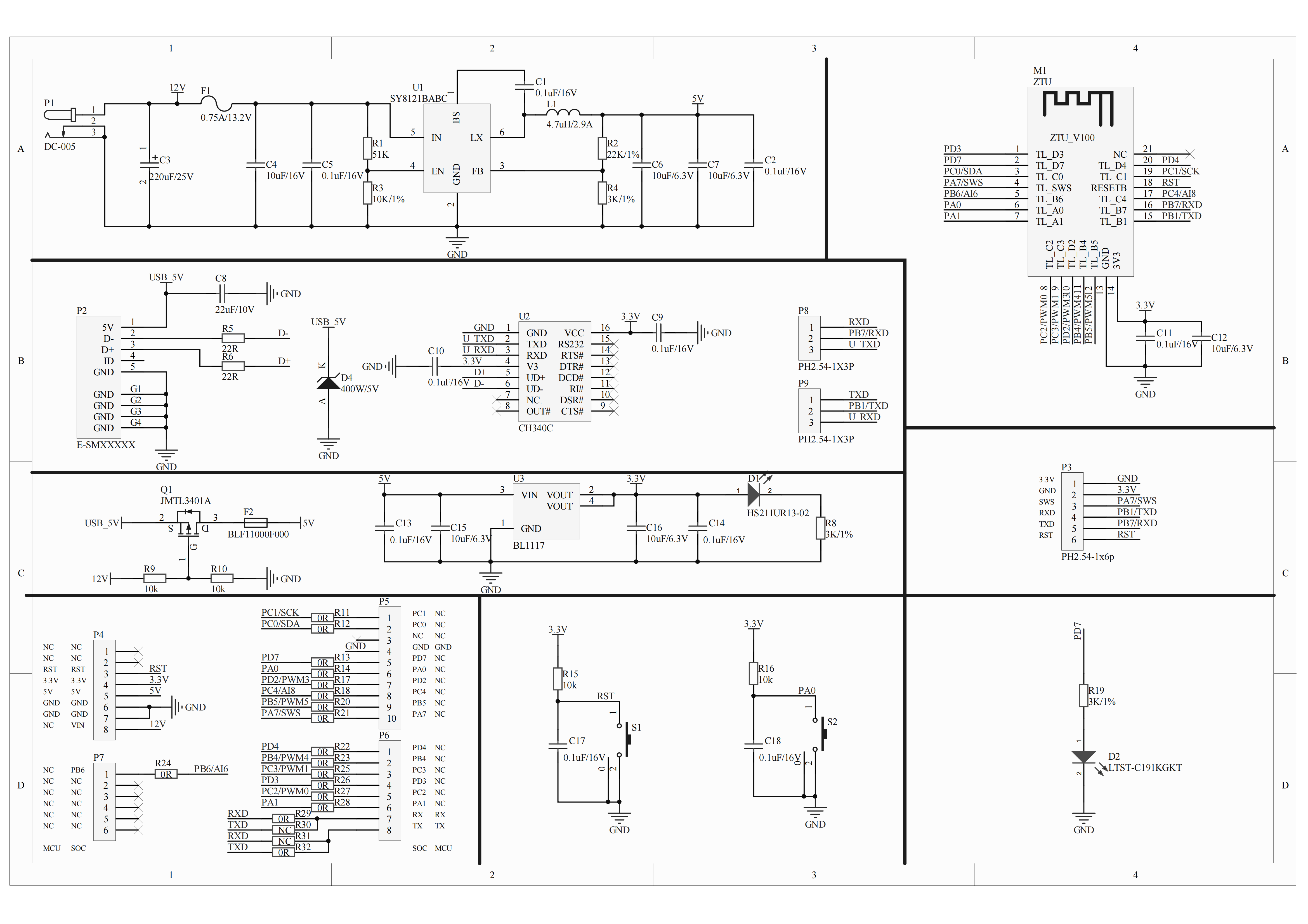

    Dev board:
    https://developer.tuya.com/en/docs/iot/tuya-sandwich-ZigBee-soc-board-ztu-V2?id=Kby6arczjimaf
    Tuya ZTU dev board with Zigbee module and labeled I/O pins
    TYDE5-ZTU dev board with UART and interface pins labeled
    Block diagram of ZTU board showing UART RXD and TXD pin connections

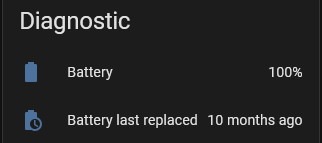

    piotrszulc1
    I can recommend the bluetooth sensors BTH01 or THB2 (both Tuya), on which you can easily, even without soldering, upload alternative software from pvvx , which broadcasts in BTHome format. Home assistant supports this natively. Additionally, if you use a Bluetooth proxy then you don't have to worry about range.
    In terms of battery savings, I haven't replaced it yet.
    Screenshot showing battery at 100% and last replaced 10 months ago

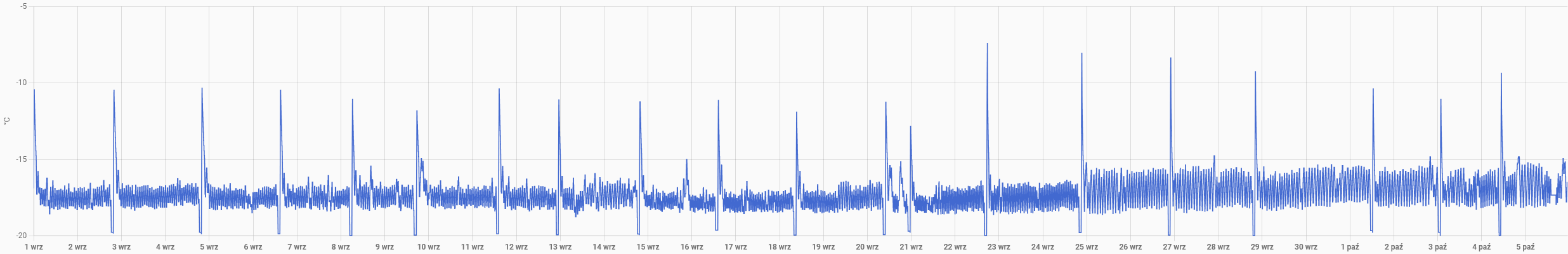

    Nargo
    Batteries from 25 Oct 2024,
    as of 10.08.2025 in the freezer :D
    Sensor readings: 100% battery, -16.17°C, 63.52% humidity, 3000 mV, 33 lqi

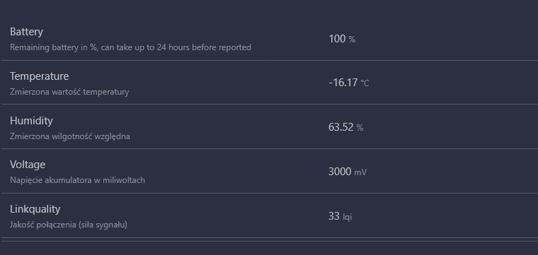

    Temperature chart from freezer sensor between September 1 and October 5

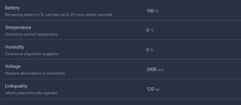

    A second identical sensor died (shows no indication) after 3 months.
    Sensor screen showing: battery 100%, temperature 0°C, humidity 0%, voltage 3000 mV
