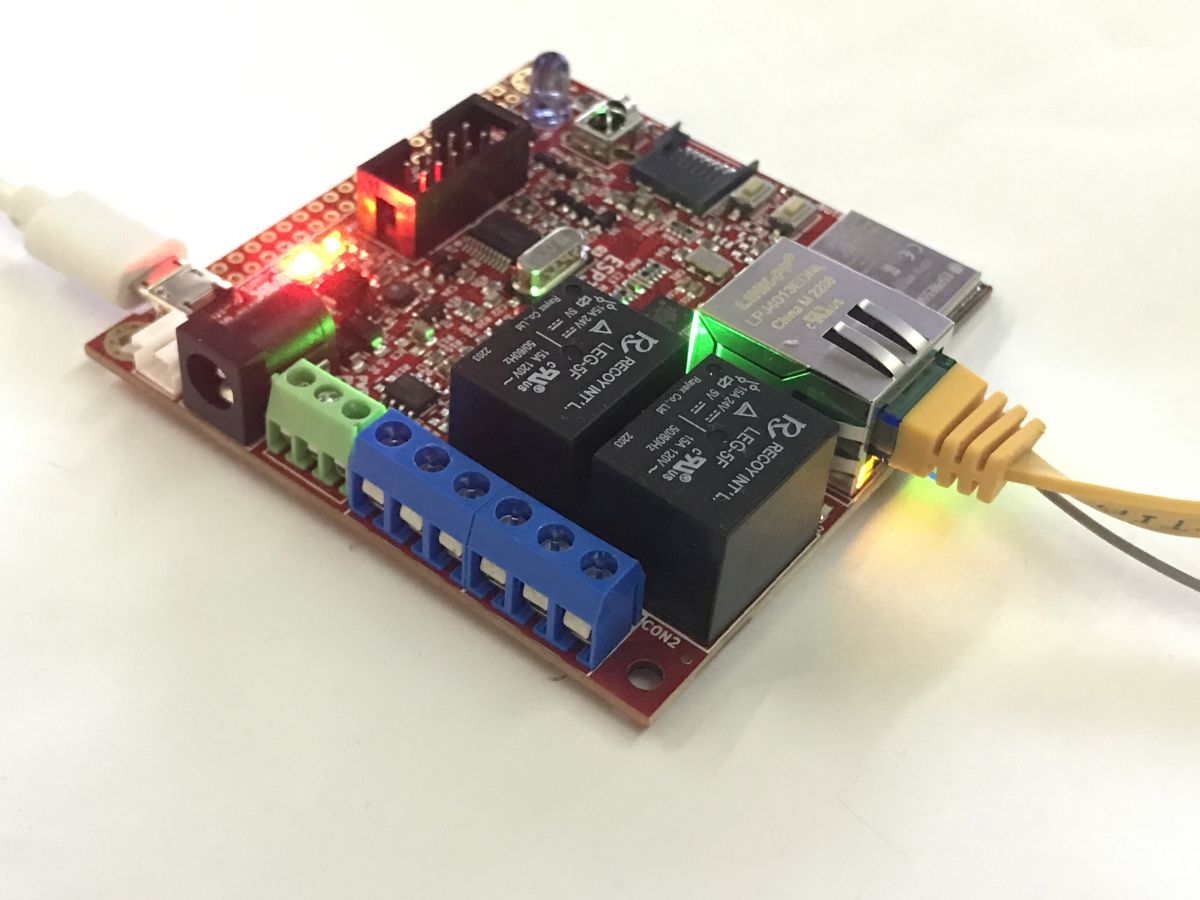

    I would like to invite you to a presentation and launch of a fully open source ESP32 development board from Olimex. Everything is available for this project - you can even download the PCB design in KiCad and customise it to your needs. The ESP32-EVB features the ESP32-WROOM-32E Wi-Fi/BT module, an additional LAN8710A wired Ethernet controller, LiPo battery capability thanks to the TP4054 controller, a built-in CAN transceiver, two relays, a USB to UART converter (for programming, among other things), a microSD card slot, an IR transmitter and receiver, and abundant connectors, including Olimex's UEXT to connect additional peripherals.
    Olimex box with a label reading “ESP32‑EVB‑EA rev. K1” on a light surface

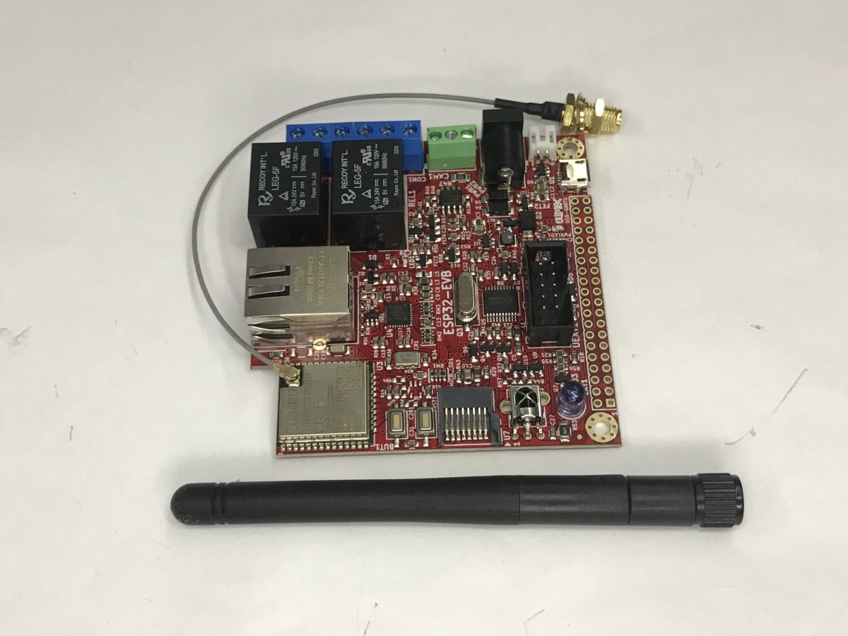

    And let's not forget the ability to connect an antenna.

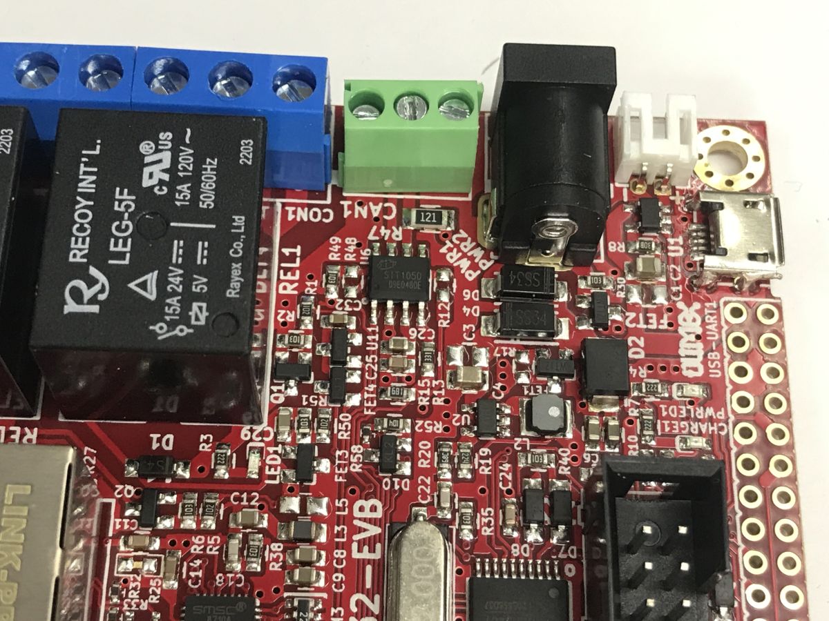

    Close-up of a red Olimex ESP32‑EVB PCB showing LAN module area and dense SMD components Close-up of a red PCB with a relay, screw terminals, and a DC barrel power jack
    Close-up of Olimex ESP32-EVB red PCB with relay, screw terminals, DC barrel jack, and USB-C port Bottom side of a red Olimex ESP32‑EVB PCB with pin labels, solder pads, and printed logos
    I bought the board for £150.

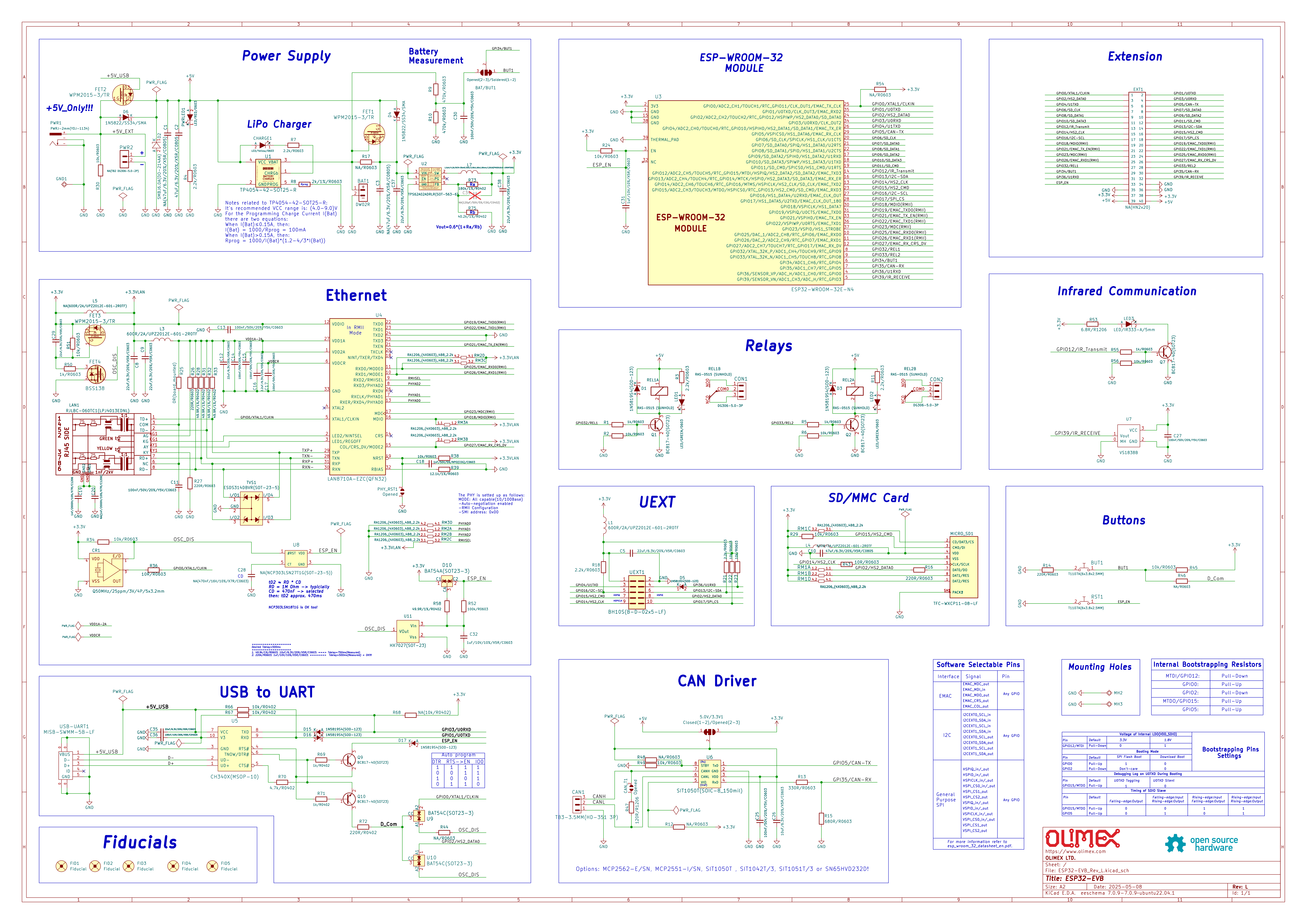

    Schematic:
    Schematic of the Olimex ESP32-EVB board with blocks for power, Ethernet, relays, UEXT, SD, CAN, IR, and USB-UART
    It came with an antenna and three plastic non-slip feet. Apparently the price is quite high, but maybe it's worth it? Especially since the manufacturer plays open cards - everything is made available.

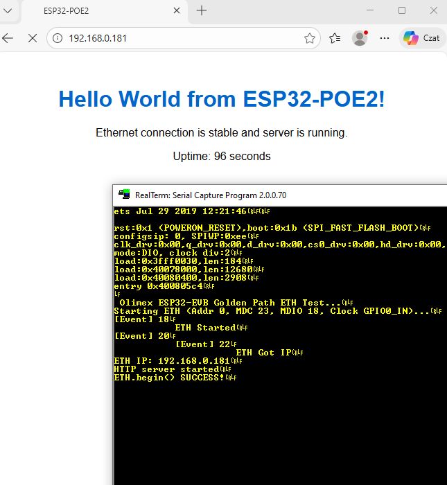

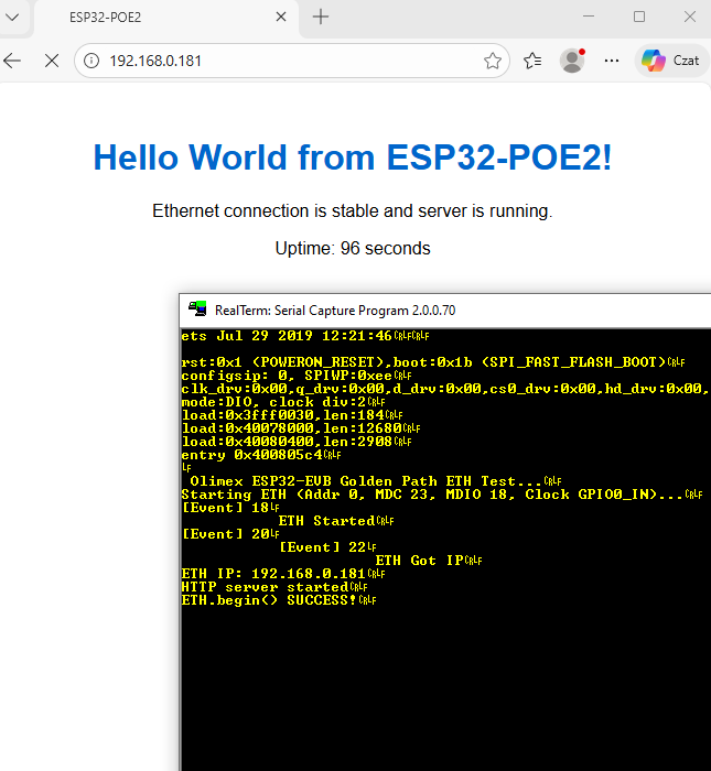

    However, I had a bit of a problem with just getting the LAN up and running. I tried various ways, but it was only when I modified the example to manually reset the controller with a sufficiently long delay that communication started. In this configuration the communication works even when powered by a long USB cable. For verification on Ethernet, I put up a simple "hello world" page that downloads fully over the cable - no Wi-Fi.
    Code: C / C++
    The example works, which means we have the basics:
    Olimex ESP32-EVB board with Ethernet cable and USB power connected, LEDs lit
    Screenshot: “Hello World from ESP32-POE2!” web page and RealTerm window showing Ethernet startup log

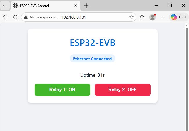

    Another thing worth checking are the relays. There's not much philosophy here anymore - they are simply connected (via transistors) to two specific GPIOs. All you need is a simple pinMode and digitalWrite and you can control them. For the example, I have connected them to simple buttons on the page:
    Code: C / C++
    Full HTML code:
    https://pastebin.com/ES6dYX0u
    The result:
    Screenshot of “ESP32-EVB” web page showing Ethernet status and buttons Relay 1 ON and Relay 2 OFF
    The relays respond correctly to the buttons, this is how we made the simplest substitute for Tasmota.

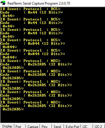

    I took two remotes from the living room - one from the TV, the other from the Internet TV decoder. Both are seen correctly, one transmits in RC5, the other in NEC.
    Screenshot of RealTerm showing IR event logs with RC5 and NEC protocols and hex codes
