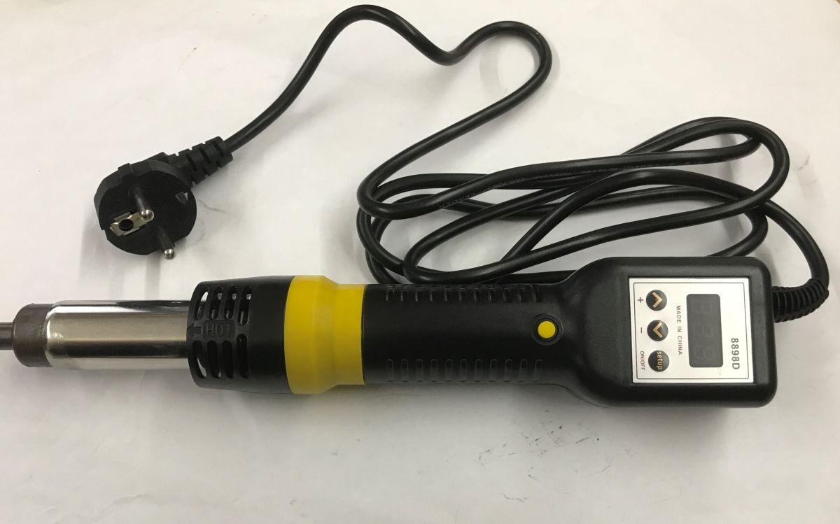

    the 8898D is a portable hot air offering up to 700 W and adjustable temperature(100 °C - 480 °C) and blowing (up to 120 l/m). Current settings and measurements are displayed on an easy-to-read three-digit LED display. The whole thing is available to buy for just £80 and we get up to three nozzles in the set. The question is, is it worth it? Let's find out!

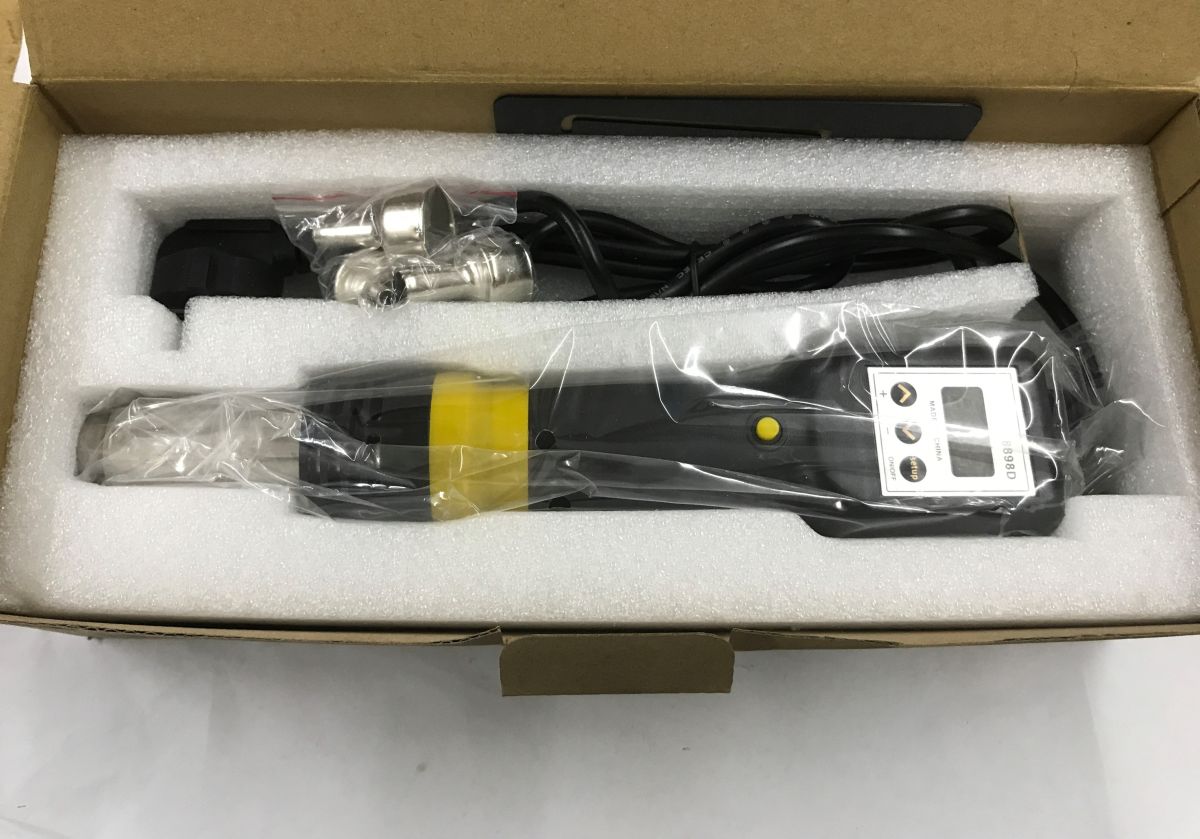

    The box arrived a little battered, but the soldering iron doesn't seem to mind, as it is quite well protected for the journey.
    Open box with foam insert holding a 8898D handheld hot air tool and metal nozzles

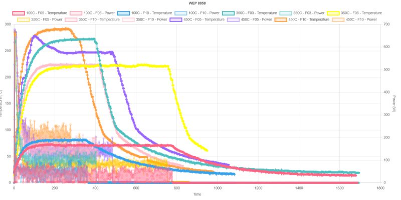

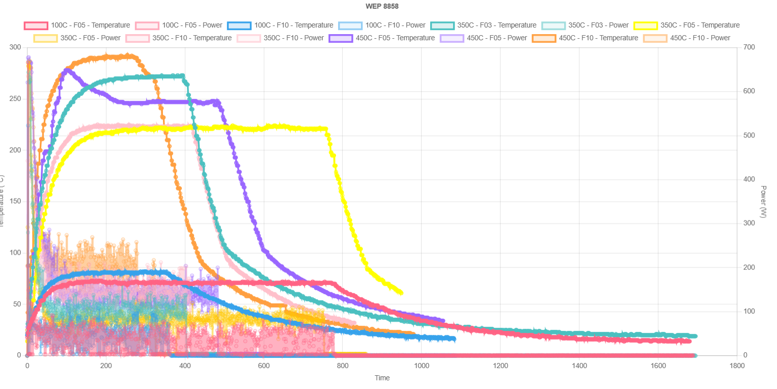

    Temperature and power measurements

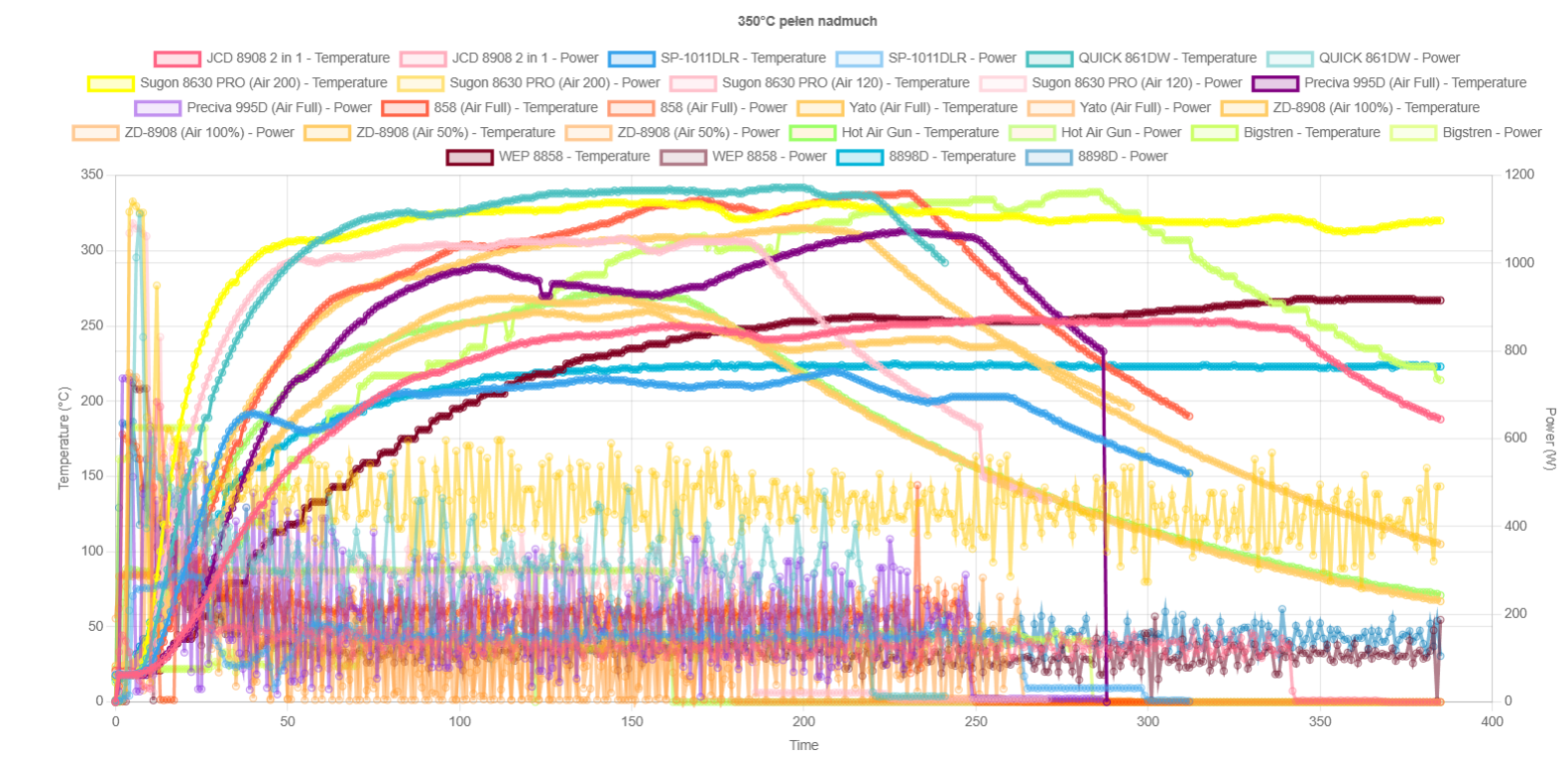

    I used my earlier post for testing:
    OpenBeken configuration for hot air testing - MAX6675, temperature and power logging
    I measured temperature and power. I have collected the results for the 8898D in the interactive graphs:
    Multi-line chart of WEP 8858 temperature and power over time for different setpoints and airflow levels
    Interactive version: https://openshwprojects.github.io/hotair/8898D.html
    Let's start with a temperature of 100 °C. At full blast it managed to reach just over 80 °C, and at half blast only 70 °C. I guess in the case of my sensor, however, the small blowing does not serve as it should, the sensor does not get heat fast enough and cools down a bit faster.
    In WEP 8858 this 100 °C setting was more precise.
    At 350 °C, in the F05 and F10 blower settings, my sensor eventually measured only about 225 °C.
    Only with a very low blowing setting of F03 was it possible to achieve a significantly higher temperature, only then, in turn, the larger PCB heats up more slowly because the air here is the carrier for the heat. In addition, the heating is spot on and it is easier to "bulge" the laminate.

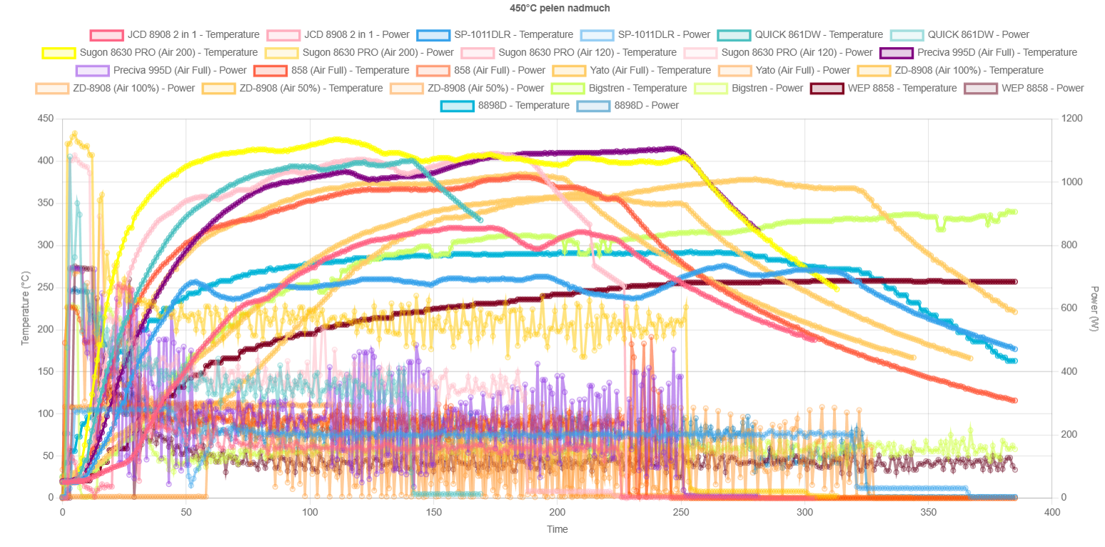

    With F05 and 450 °C blowing I have a rather skewed result, the probe must have moved, but it is already difficult. F05 and F10 at 450 °C has a similar situation as at 350 °C. 450 °C reaches less than 300 °C on the sensor.
    Now comparison with other stations:
    https://openshwprojects.github.io/hotair/version10/350c.html
    https://openshwprojects.github.io/hotair/version10/450c.html
    Multicolored comparison chart of hot air stations’ temperature and power at 450°C, full airflow
    Comparative chart of temperature and power for multiple hot-air stations at 350°C with full airflow
    the 8898 seems to be quite similar to, although slightly better than, the 8858. Especially the 450 °C target temperature is better, with less than 300 °C achieved in practice. Unfortunately, the classic 858 is still a long way off - it reaches a good 75 °C more. The results correspond to the power measurements - the 8898 heats with slightly more power than the 8858, but less than the 858.
