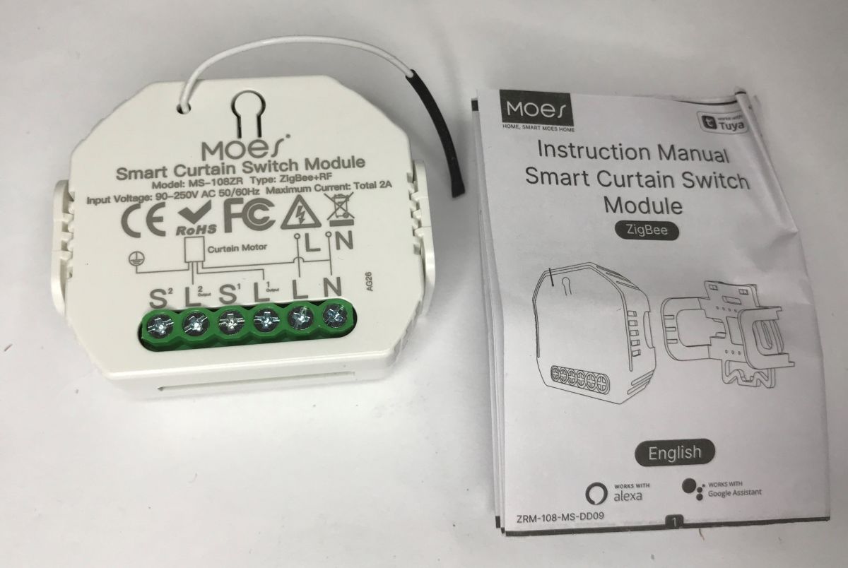

  • Moes MS-108ZR ZigBee+RF smart curtain switch module next to its instruction manual

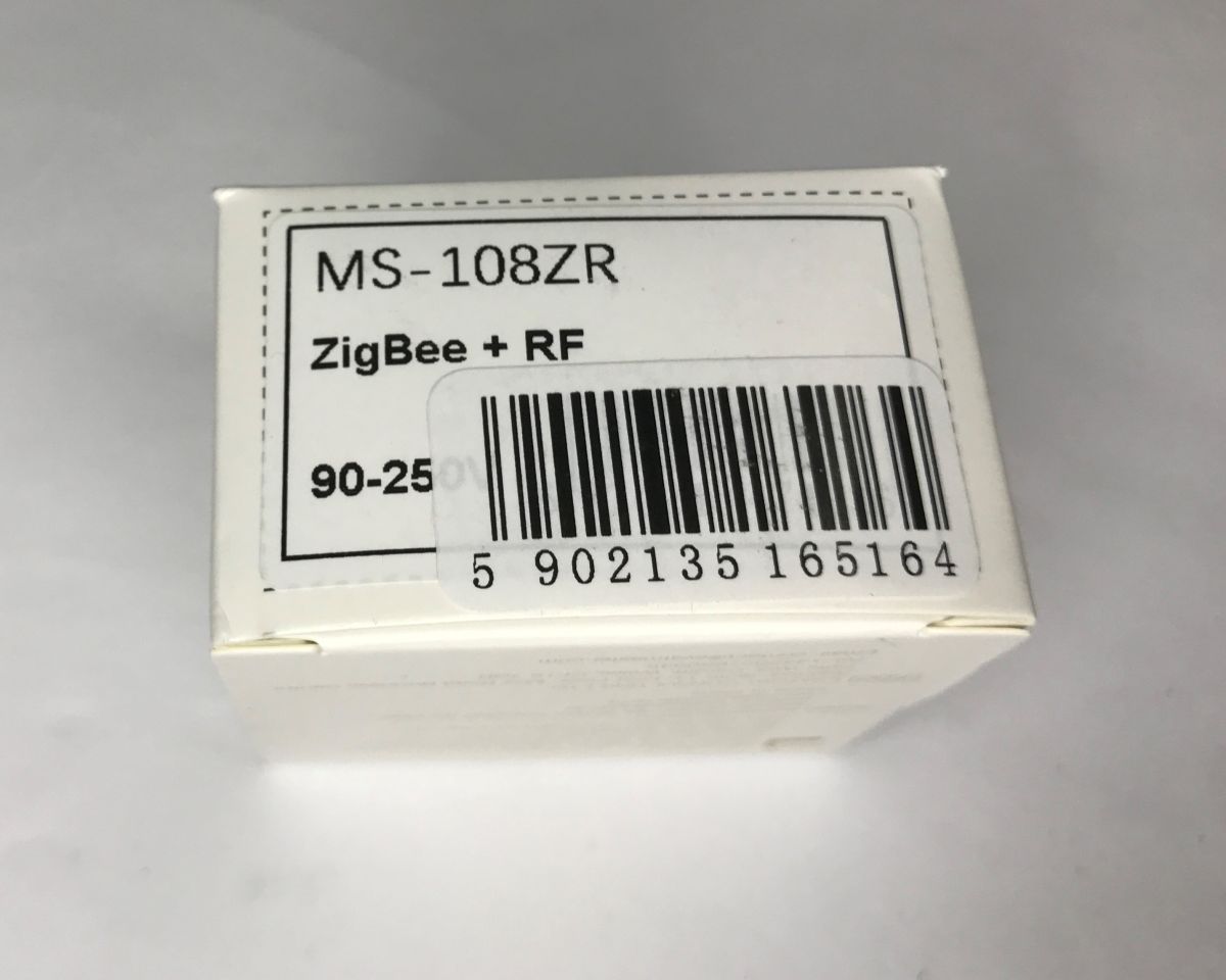

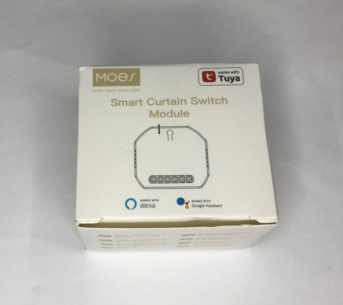

    I'd like to invite you to a test of the MS-108ZR in-box roller shutter controller module based on Zigbee wireless communication with additional RF support. Here I will present its pairing with Home Assistant via Zigbee2MQTT, check what its integration with HA offers and show its interior. All this we get for only £50 - is it worth it?

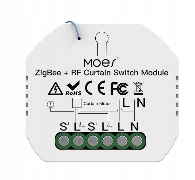

    Moes ZigBee+RF curtain/blind switch module with L, N, S1, S2 terminals and printed wiring diagram
    The device works with loads up to 300 W, while for resistive loads the maximum current recommended by the manufacturer is 2 A. This is sufficient in itself for most roller shutters. The connection diagram is in the manual and, in principle, also on the device itself.

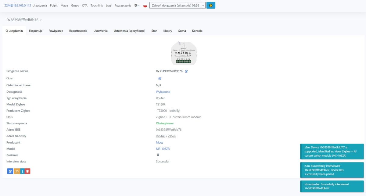

    Zigbee2MQTT screenshot showing Moes MS-108ZR/TS130F blind module details and pairing logs
    HA correctly recognises the device as type TS130F (model MS-108ZR). The equipment operates in router mode, so it extends the range of the Zigbee network.

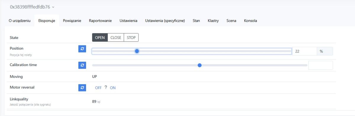

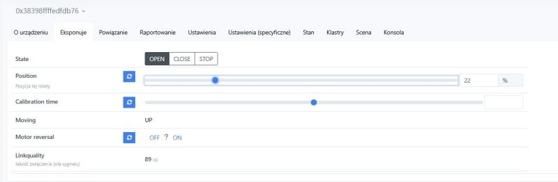

    Zigbee2MQTT UI screenshot with OPEN/CLOSE/STOP buttons and roller position slider set to 22%
    The device offers full control over the roller shutter. We have the possibility to perform predefined operations of opening, closing and stopping, and we can set its any position with the slider. In addition, we also read out its status and can reverse the direction of the motor, so that the wires do not have to be swapped places if necessary.

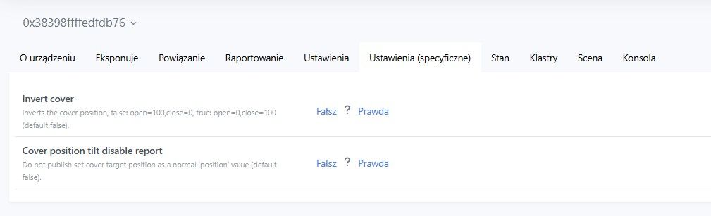

    Home Assistant device settings screenshot showing “Invert cover” and a report-related toggle options.
    In the options we have additional settings - such as reversing the percentage position.

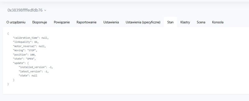

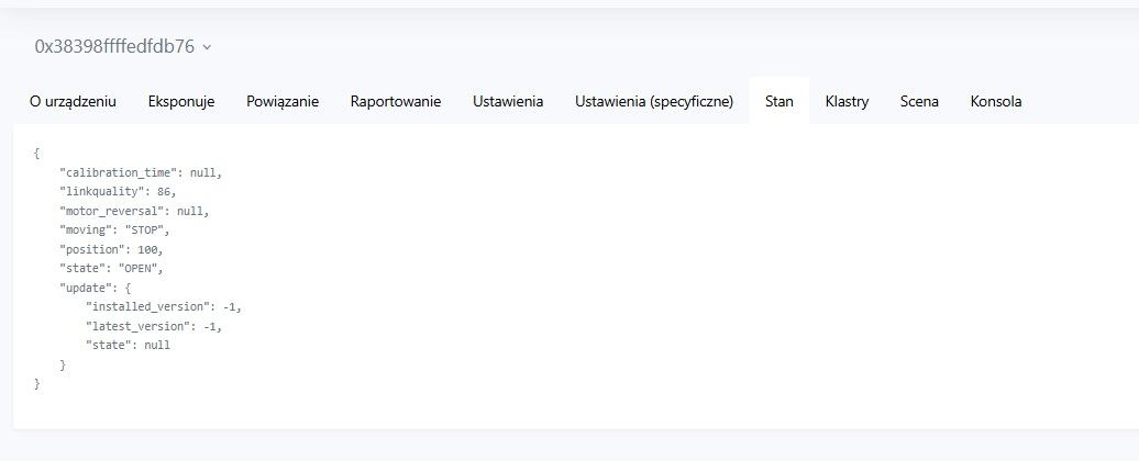

    Home Assistant screenshot showing the “State” tab with a JSON view for a roller shutter device
    Device status is also available as JSON - this will be useful for advanced users.

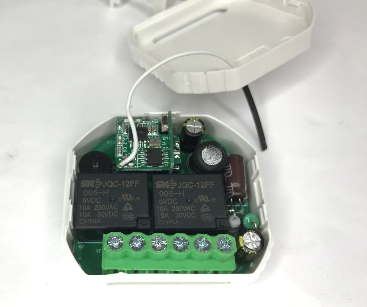

    Open controller module case with two relays and a green screw terminal block on the PCB
    Inside are two JQC-12FF 005-H 5V DC relays. This 5V is supplied by a non-isolated DC downconverter. The whole thing is assembled "sandwiched", you can also see the RF module with antenna from above.

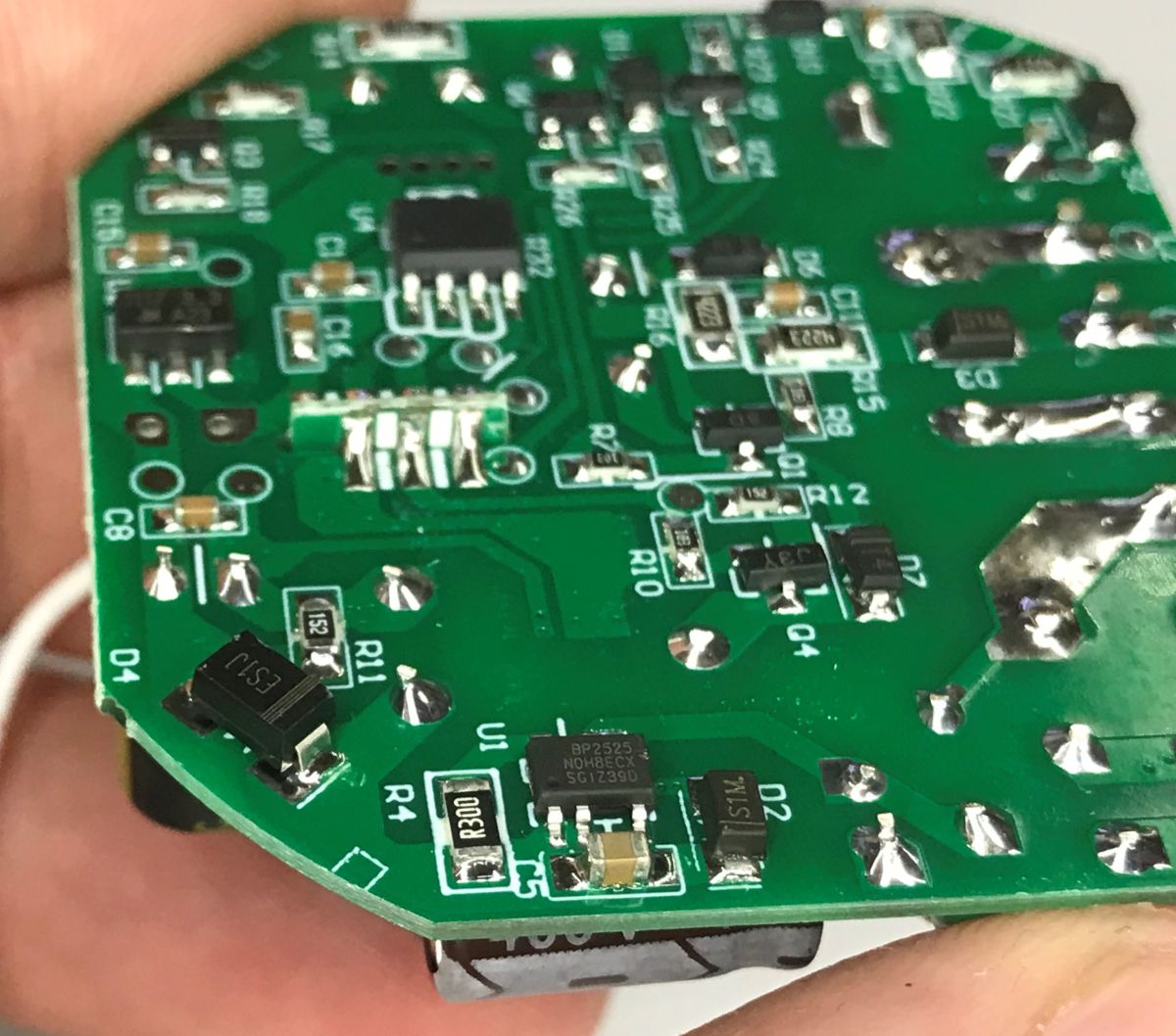

    Close-up of a green PCB with SMD parts and a BP2525 IC, held between fingers
    The inverter is based on the BP2525 chip - a classic in this type of application. It is this that provides 5 V for the relays, then separately there is a 3.3 V LDO supplying the Zigbee and RF module.

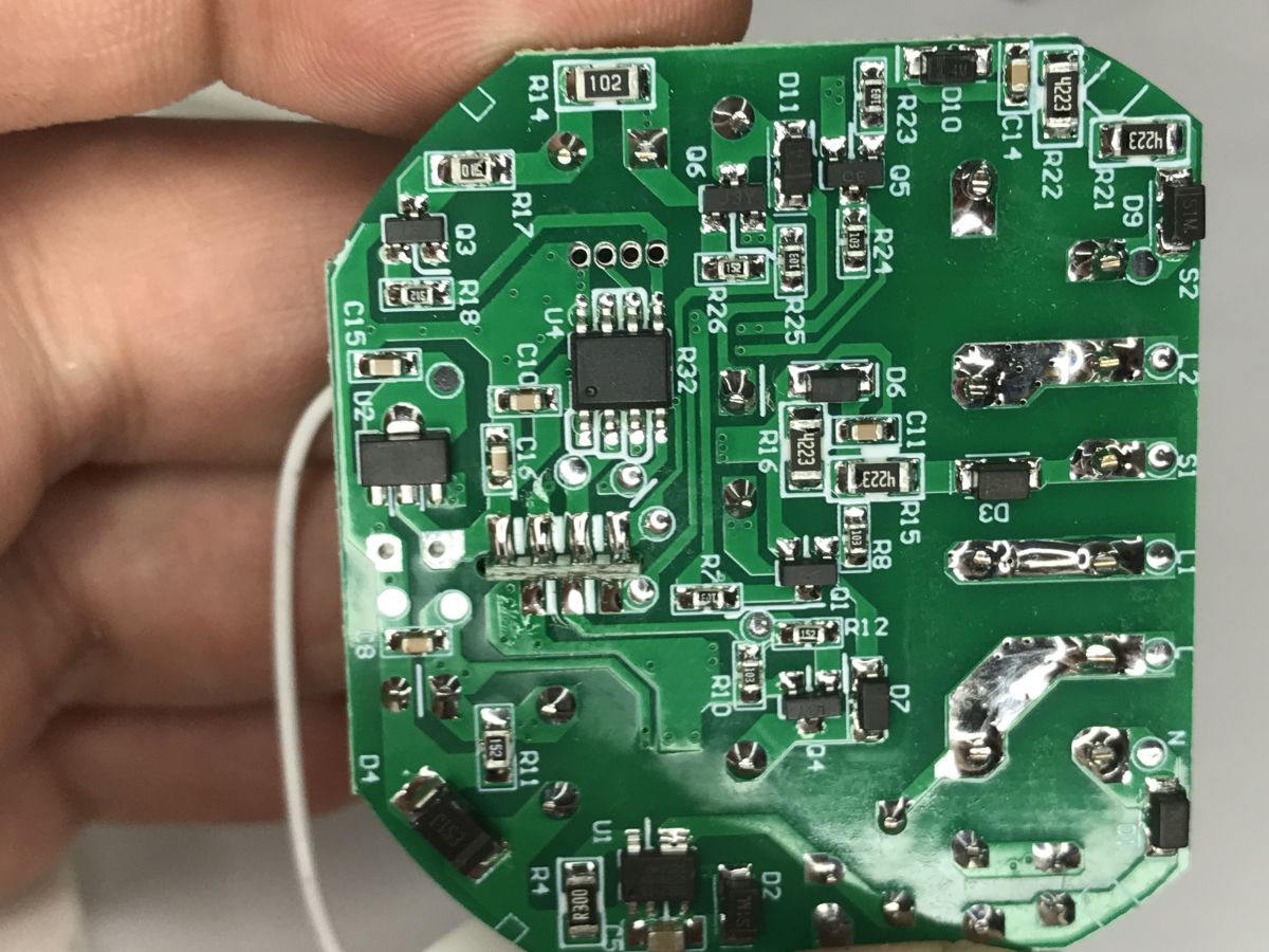

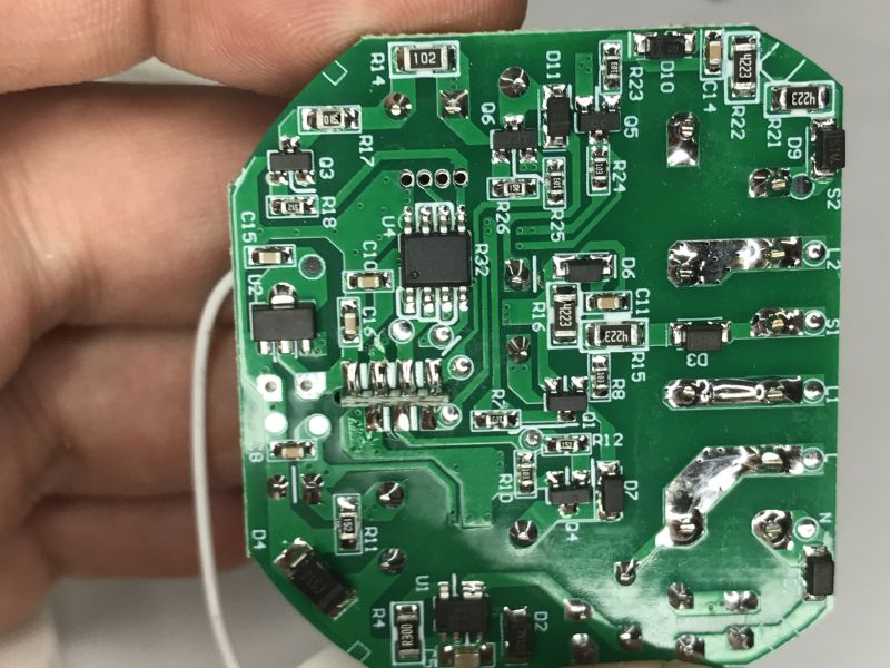

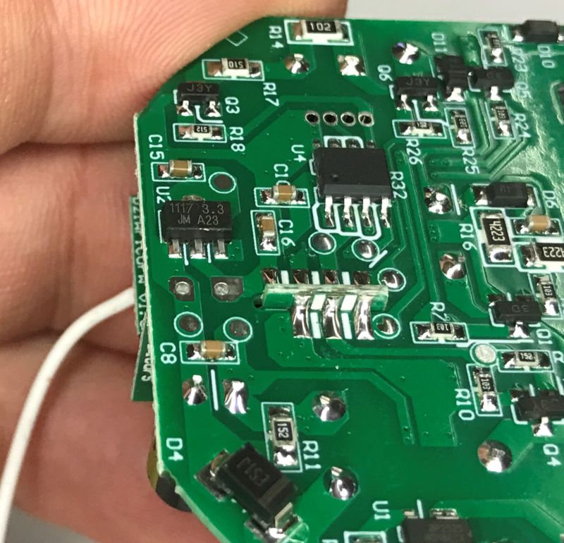

    Close-up of a green PCB with a “1117 3.3” chip and SMD parts, held in a hand
    The U4 circuit is not signed, I suspect maybe it's a controller for the relays - maybe it's the one that makes sure we don't close both at once? Anyone have any ideas what the U4 is? On Wi-Fi gadgets like this, this protection is only in the firmware.

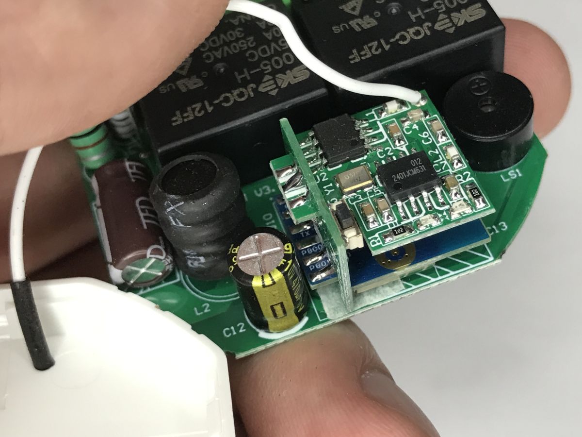

    Side close-up of stacked PCB layers and capacitors inside a controller module

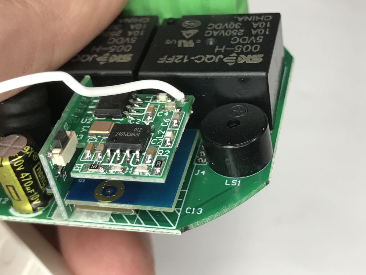

    The RF module has only one of the two chips signed - 012 2401JCM631. I also see a 13.52 MHz quartz oscillator.

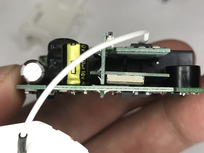

    You can see here a really interesting design based on three boards:

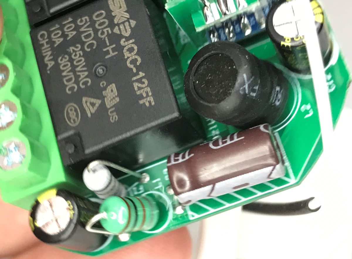

    Close-up of a PCB with JQC-12FF 005VDC-H relay and electrolytic capacitors
    So much for the inside of this unit, I think. Apart from that unmarked U4 circuit, there were no major surprises.

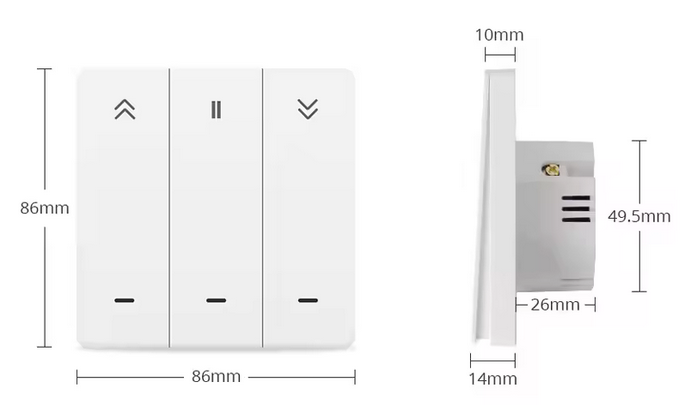

    In my case, virtually all the controllers are these:
    White three-button wall switch with icons and dimensions 86×86 mm plus side view showing depth
    The main advantages are the mechanical buttons (with backlighting), and they fit into a standard can. In addition, compared to standard buttons, they have larger dimensions (and buttons), which at the same time can be a disadvantage because two such switches do not fit into a standard double box. I have the zigbee version, but there are also wifi versions.

    I also like mechanical buttons. Is it possible to control the backlight, e.g. turn it off as you like?
    Are you combining this with a Tuya or HA gateway?
  • #4 21834900
    lexx_
    I also like the mechanical buttons. Is it possible to control the backlighting, e.g. turn it off to your taste?
    There are 4 options to choose from, all off, all lit, lit actions that are currently happening, or lit actions that you can currently perform.
    Are you combining this with a Tuya gateway or HA?
    I have Zigbee2MQTT -> Mosquitto -> HA, all locally.

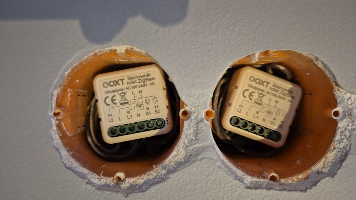

    I use these:
    Two OXT “ZigBee roller shutter controller” modules in a double wall box, with terminals and wiring visible
    they are very small and fit in the box without any problem, as you can see.
    I analysed the choice of driver for a long time. Such controllers are around the perimeter of the house and make a great basis for a MESH network. There are usually several metres to each one, so the battery-operated ZigBee devices have something to connect to. I used the reviews on Allegro. With dozens of reviews from different people I had some sort of picture. I was concerned with the reviews regarding Z2M interoperability and range.
    These controllers "ride on time" - we need to calibrate them. Many people make the mistake of calibrating too short. This results in the roller shutter not fully opening or closing after a few full cycles. Another problem is that calibration is done by default when the roller shutter is lowered. With large roller shutters there is a time difference - they take longer to raise than to lower. As my controller doesn't have separate times for raising and lowering I solved the problem by lowering the roller shutter to the 'limit' and then in Z2M I changed the direction of the motor. The controller thought it was lowering, but in fact it was raising the roller shutter. We measure the time until the top limit is tripped. After calibration, I changed the direction to the correct one - everything works normally from then on. However, don't set times that are too long, because then you won't get the roller shutter percentage setting working properly.
    By the way, roller shutter manufacturers could add automatic calibration and recalibration - just measure the current - if it is flowing then the motor works, and if it is not flowing then the limit switch has tripped and the motor does not work.
    Regarding buttons with integrated ZigBee. These were out of the question - it was a matter of uniformity of hardware and multiple frames.

  • #7 21838858
    krzbor
    This is what provides the 5V for the relays
    10A relays - roller shutters don't need that much, and these relays are large, increasing the size of the circuit.
