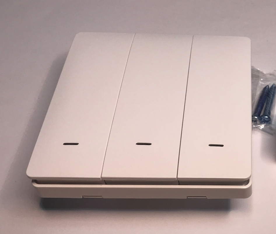

  • Triple white wall switch with physical buttons and included mounting screws
    Do you like touch buttons? They are very easy to find in all sorts of modern devices today - including building automation systems. However, I myself am not a fan of them, which is why in this topic I will be showing a Wi-Fi enabled programmable switch based on classic, clickable buttons - the so-called microswitch. It will combine the traditional convenience of control with the possibilities of remote control over the network. The topic will, of course, focus on changing its firmware so that it will work 100% locally, without the manufacturer's cloud.

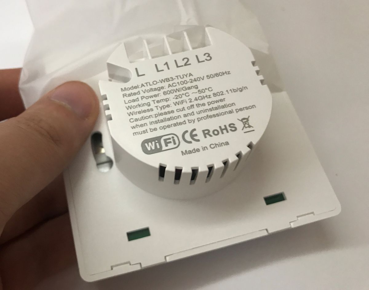

    One must start with the price. The 'triple' version was bought by a reader for £55. He then sent it to me along with the other devices so I could change the firmware. I uploaded our forum OpenBeken here.

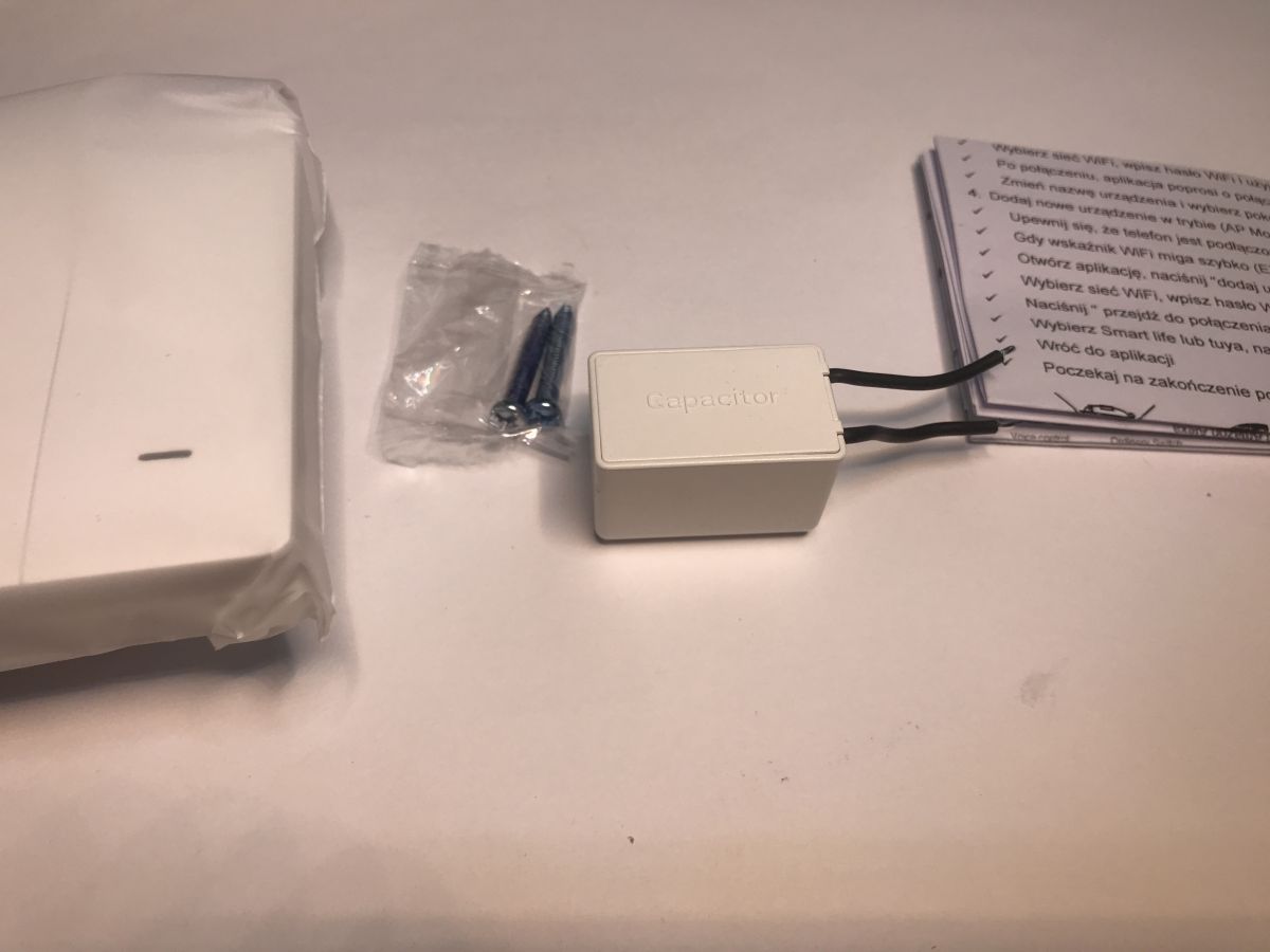

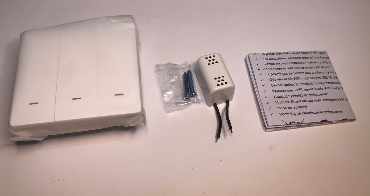

    Inside is an on/off switch, instructions, screws, and a so-called 'adapter', which is effectively a capacitor. He is needed for operation without a neutral wire.
    Unboxed Wi-Fi switch kit with three buttons, an adapter, screws, and a user manual
    I have not yet seen this form of "adapter" housing:
    Wi-Fi switch kit: front panel, capacitor, screws, and printed manual

    Declared power: 600W per channel.
    ATLO-WB3-TUYA Wi-Fi switch module with technical specifications visible

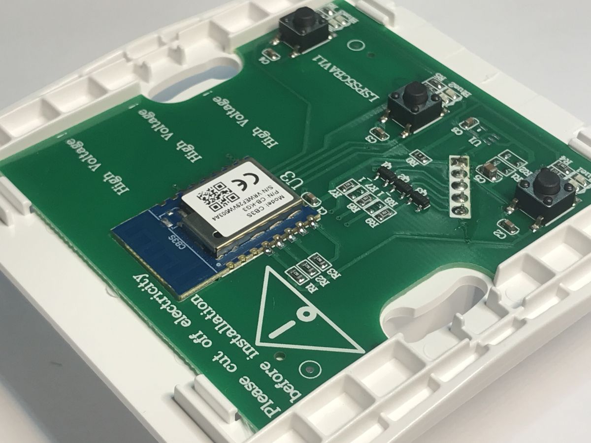

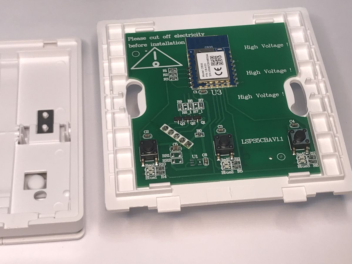

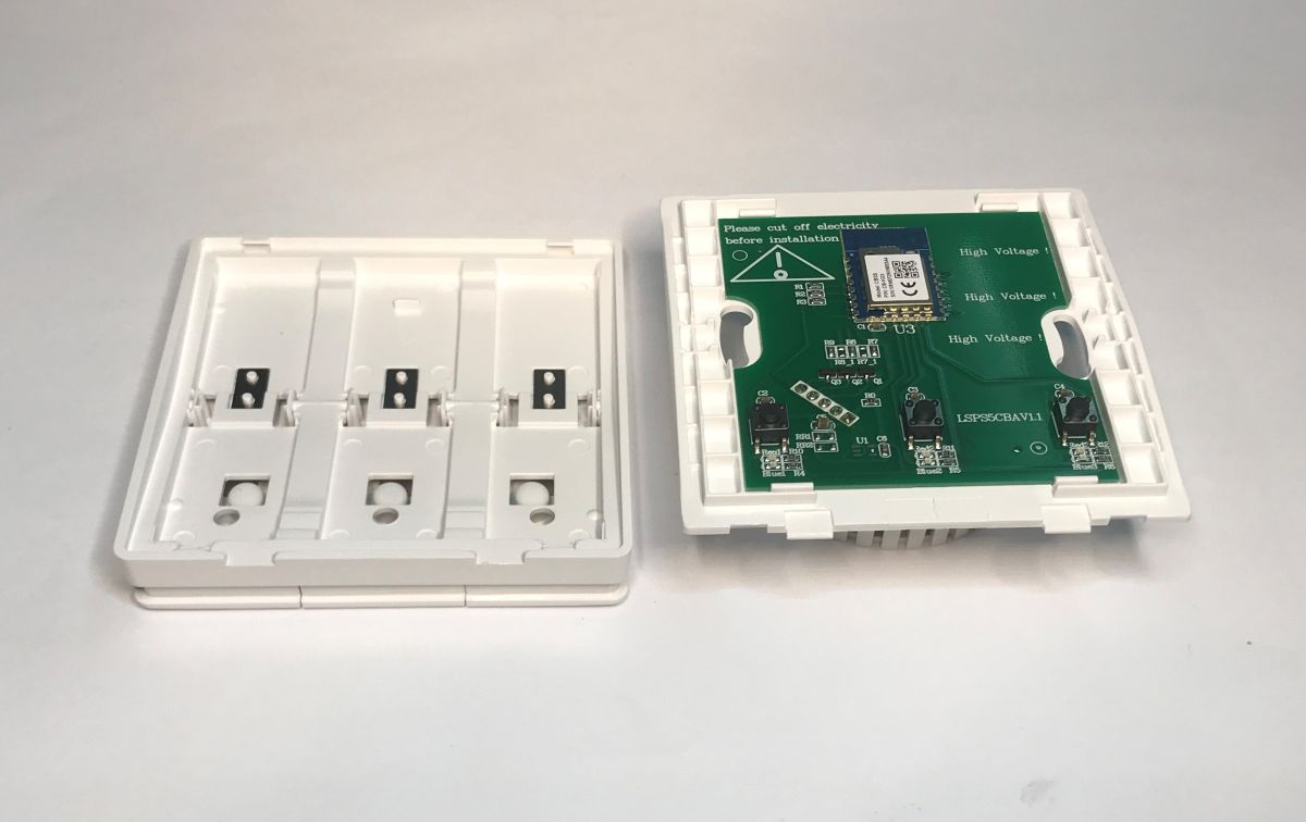

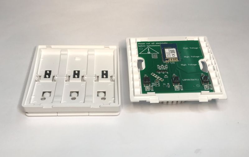

    So much in a word of introduction. Now it's time to look inside. We remove the front:
    Disassembled triple wall switch with exposed PCB, CB3S module, and microswitches

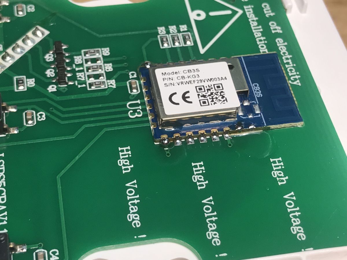

    So there's a Beken inside after all - the CB3S, or BK7231N.
    PCB with CB3S Wi-Fi module and three microswitches inside a wall switch housing
    The PCB designation is LSPS5CBA V1.1
    PCB with CB3S Wi-Fi module and three microswitches inside a switch housing.

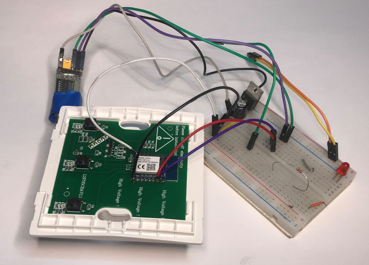

    It is time to change the firmware.

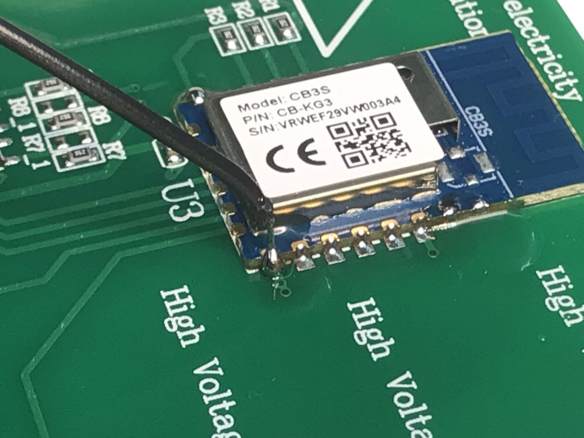

    You need to have a USB to UART converter and solder four wires - 3.3V, ground, TX and RX. Follow the Flasher's instructions:
    You can also watch one of the videos on our Elektrod channel:

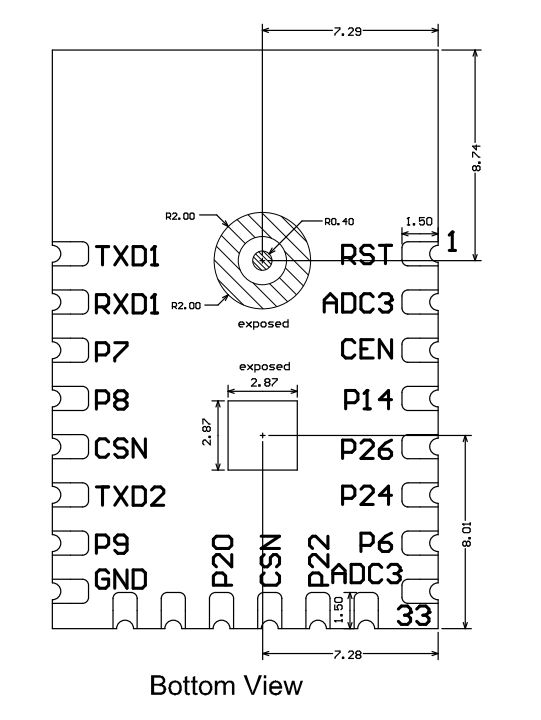

    CB3S leads:
    Bottom view of CB3S module with pin labels and dimensions in millimeters

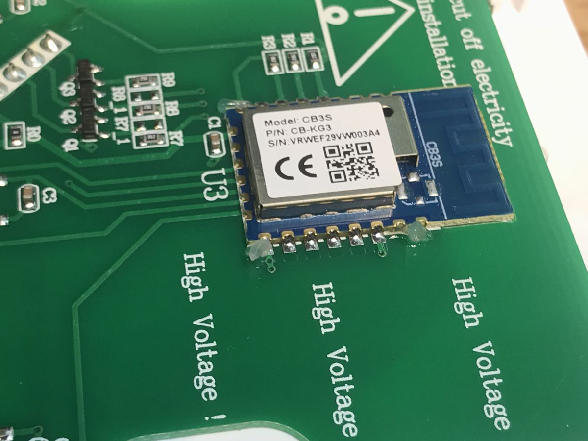

    I start by adding flux to the pads:
    CB3S module mounted on green PCB labeled “High Voltage”
    Then I whiten them:
    CB3S (BK7231N) module mounted on green PCB labeled High Voltage
    Then I solder the wires (also whitewashed):
    CB3S module on green PCB with soldered signal wire and QR label
    I power the whole thing with 3.3V from an external LDO (I have a TC1264, but the AMS1117-3.3V is more popular), because 3.3V from a USB to UART converter doesn't have enough current capacity:
    Wi-Fi switch with CB3S board connected to a breadboard via jumper wires

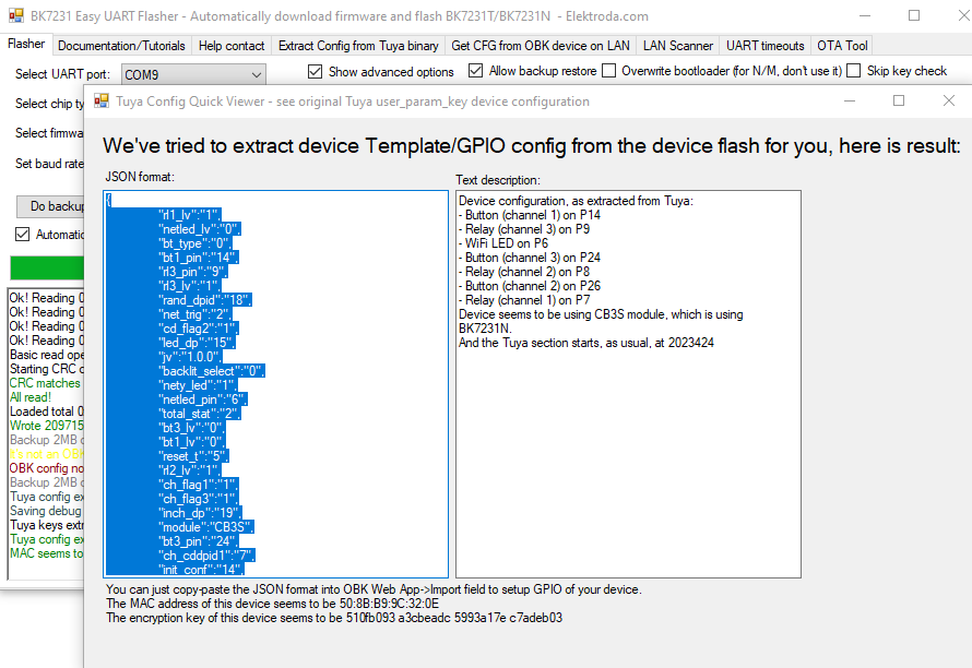

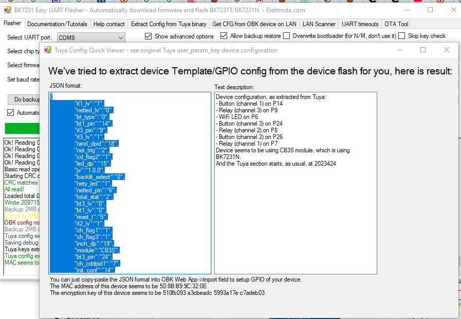

    Reading the batch is done first - this allows the GPIO configurations to be discovered:
    BK7231 Flasher window showing GPIO configuration in JSON format and descriptive text.
    JSON Tuya:
    OBK template:
    Verbal description:
    Device seems to be using CB3S module, which is BK7231N chip.
    - Relay (channel 1) on P7
    - Relay (channel 2) on P8
    - Relay (channel 3) on P9
    - WiFi LED on P6
    - Button (channel 1) on P14
    - Button (channel 2) on P26
    - Button (channel 3) on P24
    Copy of the batch:
    https://github.com/openshwprojects/FlashDumps/commit/9cef537926b7cda08ca00d9e4b7995e6b9ff14d4
    Instructions for importing the template:
    Pairing with HA:
    It is now also possible to script the buttons so that, for example, the. publish click, long press or double-click events to Home Assistant:
    Button actions Multiple press and hold etc

  • #2 21779534
    hawryszka
    Hi,
    Could you give a picture from the other side of the board, what are the actuators there ?
  • #3 21779539
    I didn't take photos of the performance part, but it was similar to the one for the other 'silent' switch:
    ATLO-TB2-TUYA - silent double light switch with Wi-Fi control under Home Assistant
    There are no relays there, so the product is silent.
