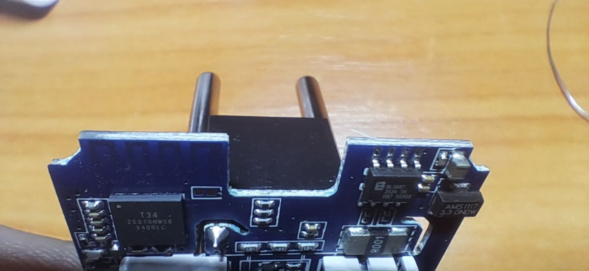

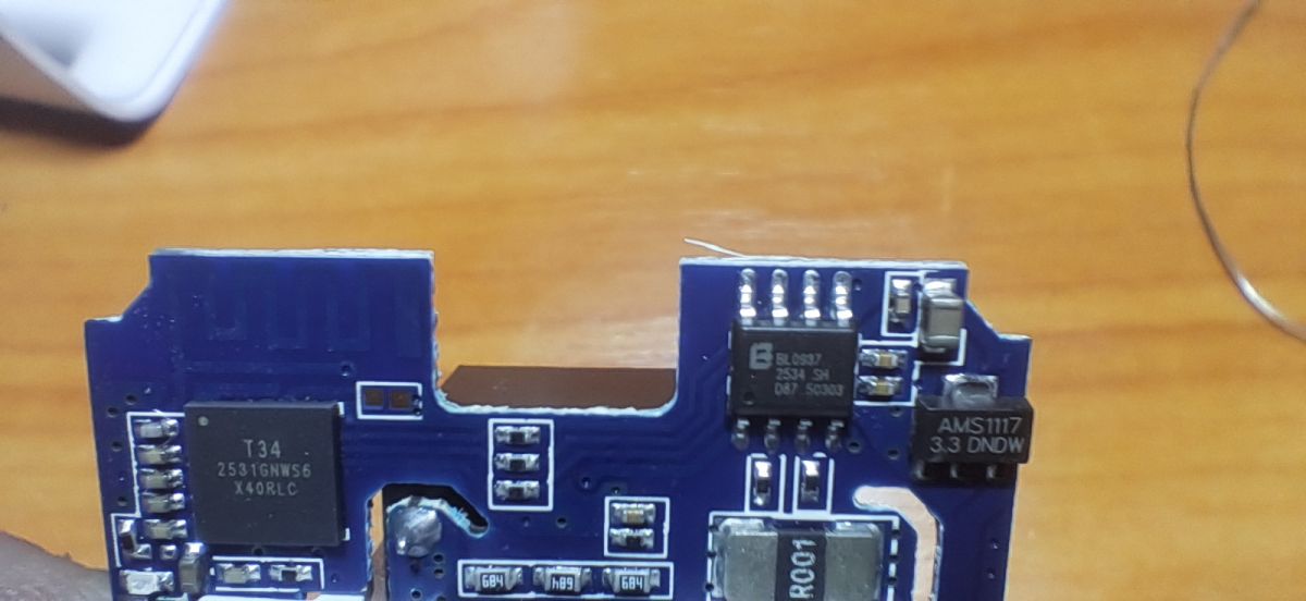

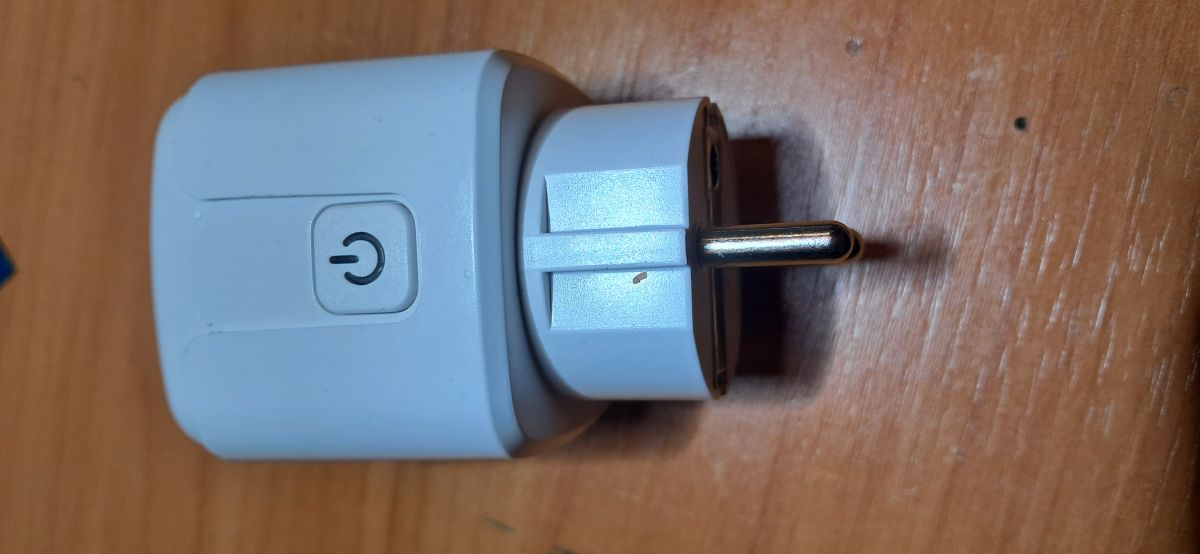

Smart socket from AliExpress, no TX1/RX1 leads, BK7231N flashing
piotr.ino26 2001 10
  • Good morning.
    Socket smart from Ali cheap (£9.5) and a great mine, but probably the latest :) Under the T34 chip the TX1/RX1 signals are not routed anywhere, no approach from the side. Only pulling off the circuit or scraping. With the previous WB2S there was no problem. It's impossible to tell what you're buying from the chassis auction photos.
    White smart socket with power button lying on wooden surface
    Close-up of PCB with T34, BL0937, and AMS1117 chips and surface-mounted components.
    Close-up of a smart plug module with T34 chip and electronic components on PCB
    As I am doing this purely as a hobbyist, it looks like what it looks like.
    Beken microchip on white base, surrounded by wires and black insulating tape
    I managed to rip the backup (below as someone would need) and upload the new firmware, but relied on soldering back in. With 2 I'll wait until it can be done over Wi-Fi.
    Read/write as BK7231N

    - BL0937 SEL on P8
    - Button (channel 1) on P28
    - Pair/Toggle All Button on P26
    - BL0937 VI (CF1) on P7
    - WiFi LED on P24
    - BL0937 ELE (CF) on P6
    - Relay (channel 1) on P14
    Device seems to be using T34 module,
    Moderated By p.kaczmarek2:
    One minor note - the T34 is a BK7231N, not a BK7252. It's important not to get this wrong, because if you load the wrong batch the module won't start.

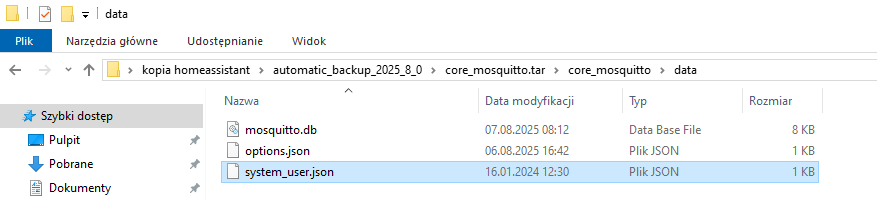

    And not to make things too easy, the MQTT password disappeared in HA.
    But I recovered it from the HA backup.
    Screenshot of folder containing Mosquitto backup files for Home Assistant
    system_user file
    And all to have another wifi socket :)

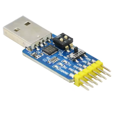

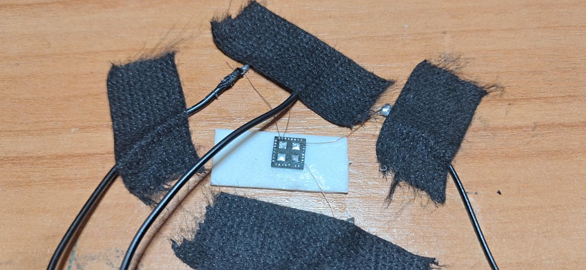

  • #7 21776644
    piotr.ino26
    USB to UART converter module with CP2102 chip and pin headers
    CP2102 from Ali + 3.3 V from power supply, and it only gives 2.4 V from USB.
    1 socket died from an impression :) after an encounter with a scalpel.
    There is no TX/RX output anywhere on the board. The pads fell right off. The pad from the T34 from the CEN fell off when whittled, also I guess a faulty copy came along.
    The second socket went express, as you can see on the logs. As you wrote, it is supposed to be BK7231N and it surprised after 1 power cut. No backup as I did this second socket out of the blue, to see if it would work.
    Biggest problem is soldering it back on.
  • #8 21776655
    I haven't even tested this CP2102 , good to know it works.

  • #9 21776701
    piotr.ino26
    I did the calibrations because I have had such a socket for 3 years to control the boiler heater and I made an energy meter out of another one (the relay and pins came out). It counts one way consumption of the house - PV offgrid + storage. At the time it was the quickest and cheapest way to read consumption and integrate with HA.
    I soldered in using a hota. It was the first time I did such a thing, 1 socket was an ordeal: cleaning the pads and low temperature paste and here I think I fell down, and 2 I didn't do anything, just a bit of flux on the board, set in the tags and hot and it worked out, so no need to fiddle too much.

Yes. The author backed up the original image and flashed new firmware after soldering to the module. It enumerates as BK7252N. [Elektroda, piotr.ino26, post #21775192]
Is over‑the‑air (OTA) flashing possible right now?
The author plans to wait for a Wi‑Fi method on additional units. For now, physical access was required for flashing. [Elektroda, piotr.ino26, post #21775192]
What quick statistic tells me about reset behavior on this device?
The Tuya config shows on_off_cnt set to 10, indicating a 10‑toggle reset threshold in its firmware logic. [Elektroda, piotr.ino26, post #21775192]
How do I identify the energy and control pins before integrating with custom firmware?
Use the extracted mapping: BL0937 SEL P8, VI/CF1 P7, ELE/CF P6; Relay P14; Wi‑Fi LED P24. Confirm continuity before flashing. [Elektroda, piotr.ino26, post #21775192]
How do I flash if there are no UART pads? (3 steps)
  1. Expose TX1/RX1 by carefully scraping traces or lifting the T34 module.
  2. Solder temporary leads, back up the image, then write the new firmware.
  3. Verify pins (Relay P14, LED P24, Button P28) post‑flash and reassemble. [Elektroda, piotr.ino26, post #21775192]
What failure modes should I watch for when accessing UART?
Lack of test pads forces trace access. Missteps here can require full module desoldering to recover, as access is tight. [Elektroda, piotr.ino26, post #21775192]
Can I rely on listing photos to know the module (WB2S vs T34)?
No. The author notes you cannot tell from auction chassis photos; the received unit had a T34, not WB2S. [Elektroda, piotr.ino26, post #21775192]
Is there evidence this approach worked on at least one unit?
Yes. Quote: "I managed to rip the backup and upload the new firmware," after soldering to the module. [Elektroda, piotr.ino26, post #21775192]
