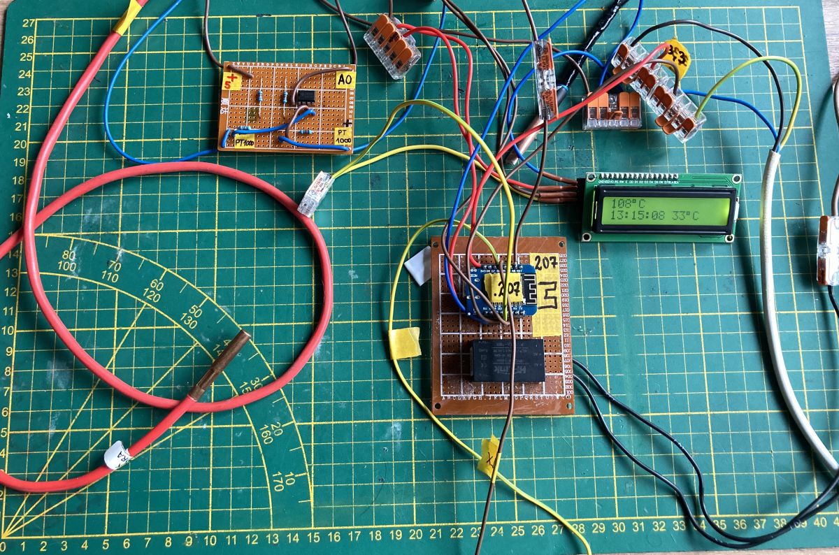

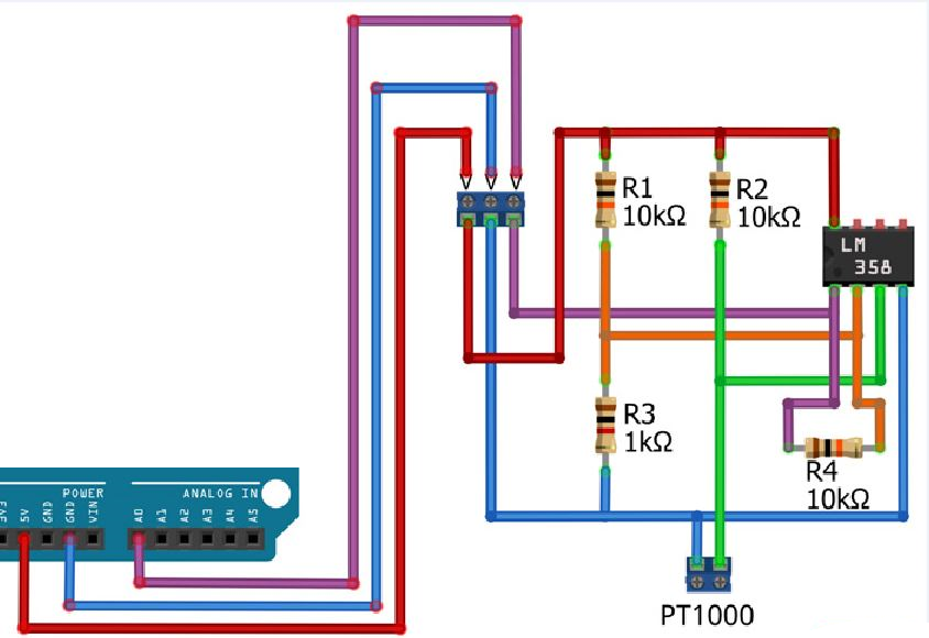

    Hi,
    i am creating a thermometer for the smokehouse ... :) .
    I have managed to make an analogue temperature sensor based on a PT1000 sensor at this point. It comes in a gel cable. According to the manufacturer the range can be -50*C-200*C. I managed to get max. 144*C. I don't know if the LM358 limits this ?
    The PT1000 sensor is supposed to measure the smoke temperature.
    Wiring diagram of PT1000 sensor with LM358 amplifier and microcontroller
    The circuit is based on an ESP8266 Wemos. It is accompanied by an LCD1602 display. I'm running on ESP Easy and I'm fine with it.
    I may do a second option with zaSUPLOwing - Supla has a good readable app on the tel.
    I calibrated the sensor at two points : at 100*C and 0*C. I also fitted a second sensor : DS18B20, but this one will be as an outdoor temp, or a sensor to stick in the meat.
    Electronic circuit with ESP8266, PT1000 sensor and LCD display on cutting mat
    I would still like to do e.g. a fiddly thing like some sort of buzzer when the temperature rises, or falls below the range, to either boost or dim.

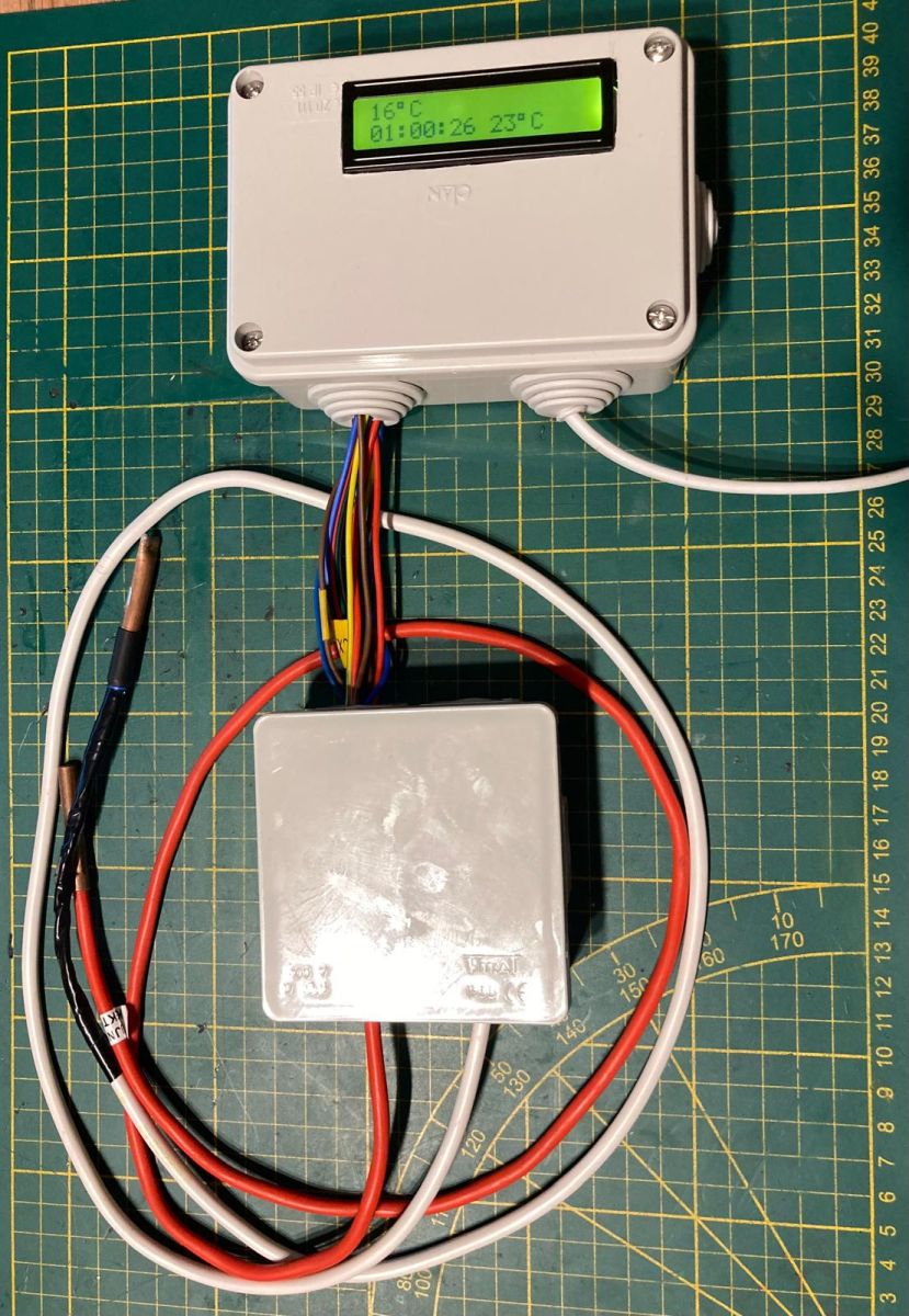

    That's what I suspected, in the kk LM358 it says up to 150*C -mi up to 144*C, but more than that I'm unlikely to need, but it begs the question what layout for higher temperatures?
    Added after 3 [minutes]:
    I sealed the whole thing in tins.
    Electronic system in enclosure with LCD display and temperature sensors
    #4 21749586
    tos18
    Level 42  
    Reduce R4 to 5 kΩ and scale the transmitter in the software.
  • #5 21749587
    sznickers
    OOO :) , thanks - I will be happy to test :) .
    Added after 11 [hours] 7 [minutes]:
    Works, thanks to :)
    Increased the temperature measurement range on the PT1000 after changing resistor R4 to 5kOhm. Of course I recalibrated it as well.
    Temperature display with label “Wędzarnia” and device IP address.
