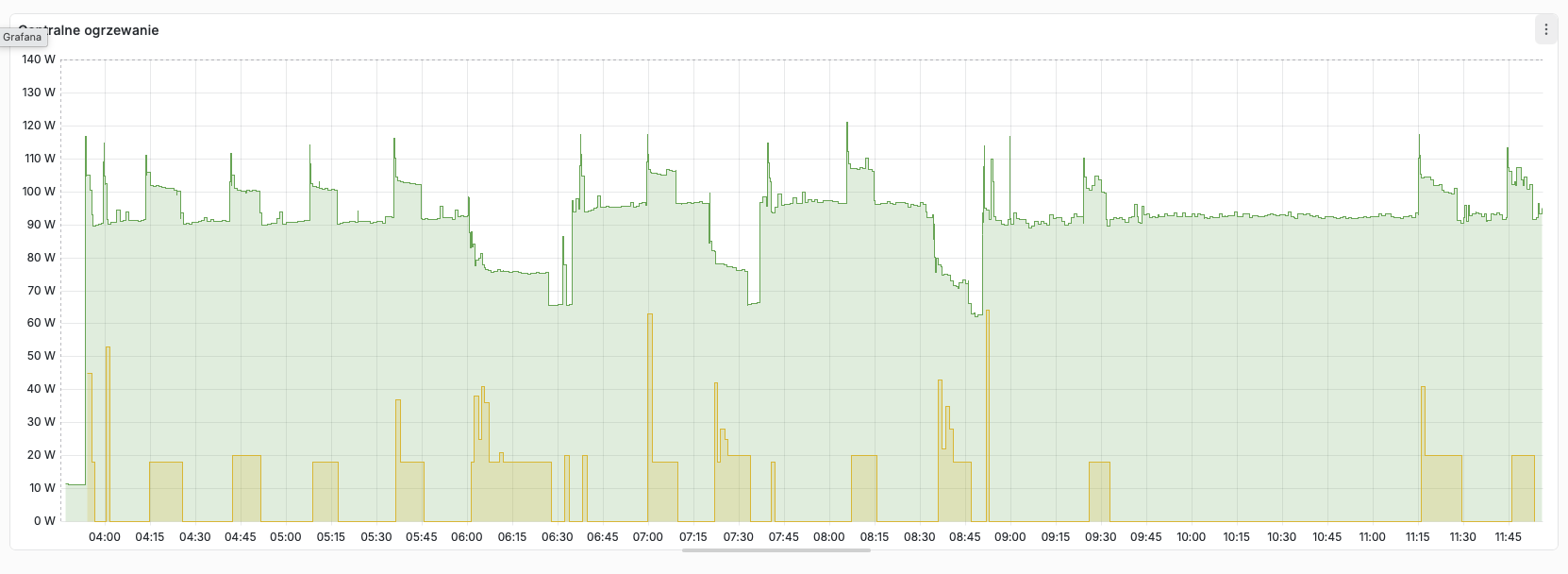

    szmiit
    I don't know how you came up with this, but I bow my head. In my Viessmann, you can also see the dependence of the power consumption on the modulation of the burner (yellow is modulation, green is the power consumption of the furnace with all the accessories connected to it: pumps, valves, etc.). The modulation here is provided by the ViCare integration and is time-delayed (changes updated probably every 2 minutes).
    We've actually started a very loosely related thread already, and maybe there should be a new one, but I'm wondering what electrical component in this cooker is controlled in parallel with the burner, that the gas intake can be calculated based on it. Some sort of fan? My point is that if it were isolated and only its power consumption was measured, it would be easier to estimate or adjust the power consumption conversion rate to the gas consumption rate per unit time as a starting point for calculating gas consumption. I'm assuming this is where some numerical integration (in HA) comes into play, unless you've somehow made it simpler :) .
    Grafana chart: green power in W and yellow burner modulation over time (about 04:00–11:45)
  • #27 21851509
    jacekiwanski10
    Let me give you my observations. Well, the boiler, together with the radiators, is a sort of fairly fixed system. From it, you can measure how much gas the system consumes; now you just need to change how long it did it, and the time-flow entity is ready. I'm not imposing on you how to measure the burner time, the important thing is to measure it as accurately as possible. From my observations, this arrangement is quite stable. I would also add that I created a helper - a utility counter - based on my Shelly entity and only added it to the Energy panel; the helper is easier to calibrate in the development tools. Your focus at the start should be to read as precisely as possible when the burner is running, not with what modulation.
  • #28 21851514
    szmiit
    >>21851509 Am I understanding you correctly then, that the burner modulation is already secondary and doesn't have much impact on the accuracy of the measurement? I'm looking in the boiler manual for where to plug in. At the moment I don't know anything for sure yet, but the "universal gas regulator" connection is shown there. If by chance it is a voltage regulator in some range, maybe that would be such a surest source already.
  • #29 21851520
    jacekiwanski10
    If I can just give you a hint, you are in a better position than I am. My 2001 boiler has few studies on it, so I came up with something of my own. You're better off, if you're bothered by delays, they're caused by the cloud. There is a design for Viessmann for local readings via OT and your boiler should support it. Maybe you'd better focus on that, you'll have more information. There is also the Open3e project for your internal bus. And as for your question, the modulation in the boiler matches the heating system and is fairly constant. I don't know how you control the boiler, is it a temperature setting for example in the living room or a heating curve? If a heating curve, then here I would focus on the burner time and the extracellular temperature.
