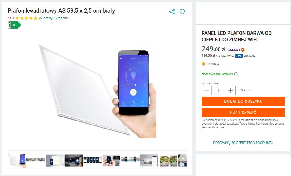

    Purchase of AgPanSMART6025 panel We bought the panel on a Polish auction site for a whole 250zł. We had planned to buy several, but we took one as a test to know if it would be suitable for connecting to the Home Assistant, if anything. Here's a screenshot of the listing:
    Screenshot of a 60x60 cm LED panel offer with a mobile app.

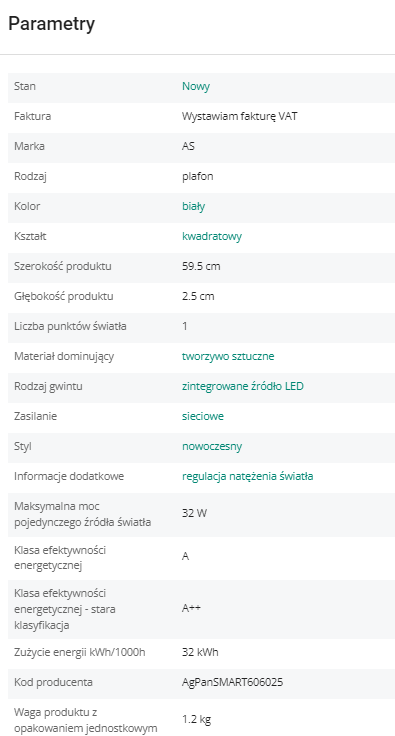

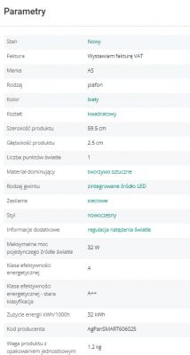

    Parameters:
    Specifications of AgPanSMART606025 LED panel

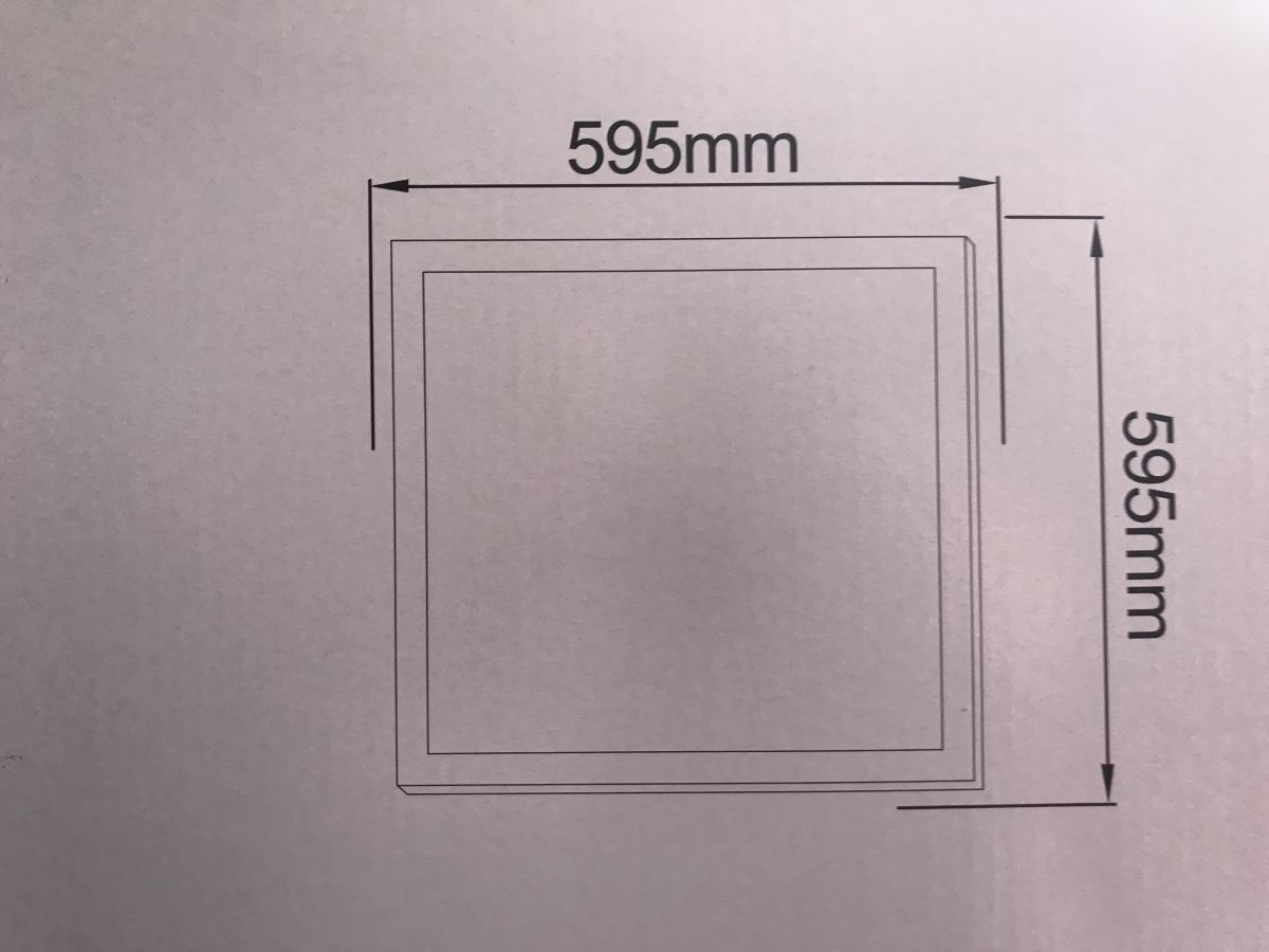

    Note the manufacturer's code: AgPanSMART606025 . It seems to be an abbreviation for AigoSmart Panel 60x60x2.5.
    There are no specifics there. Let's still see the dimensions of the panel:
    Large AgPanSMART606025 LED panel measuring 59.5 cm x 59.5 cm

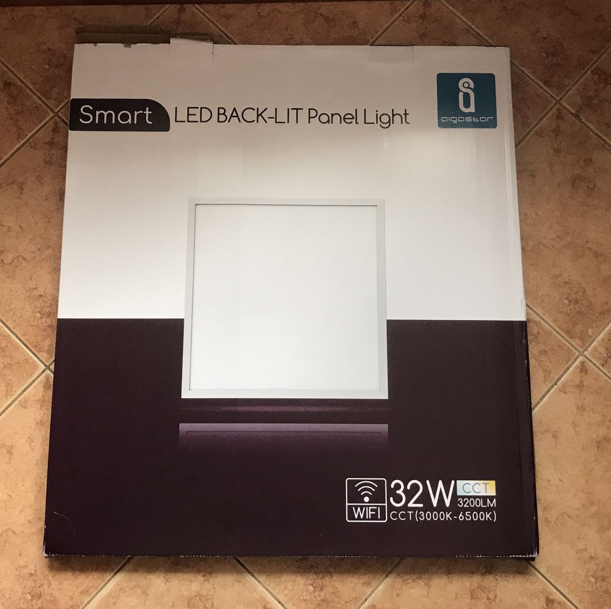

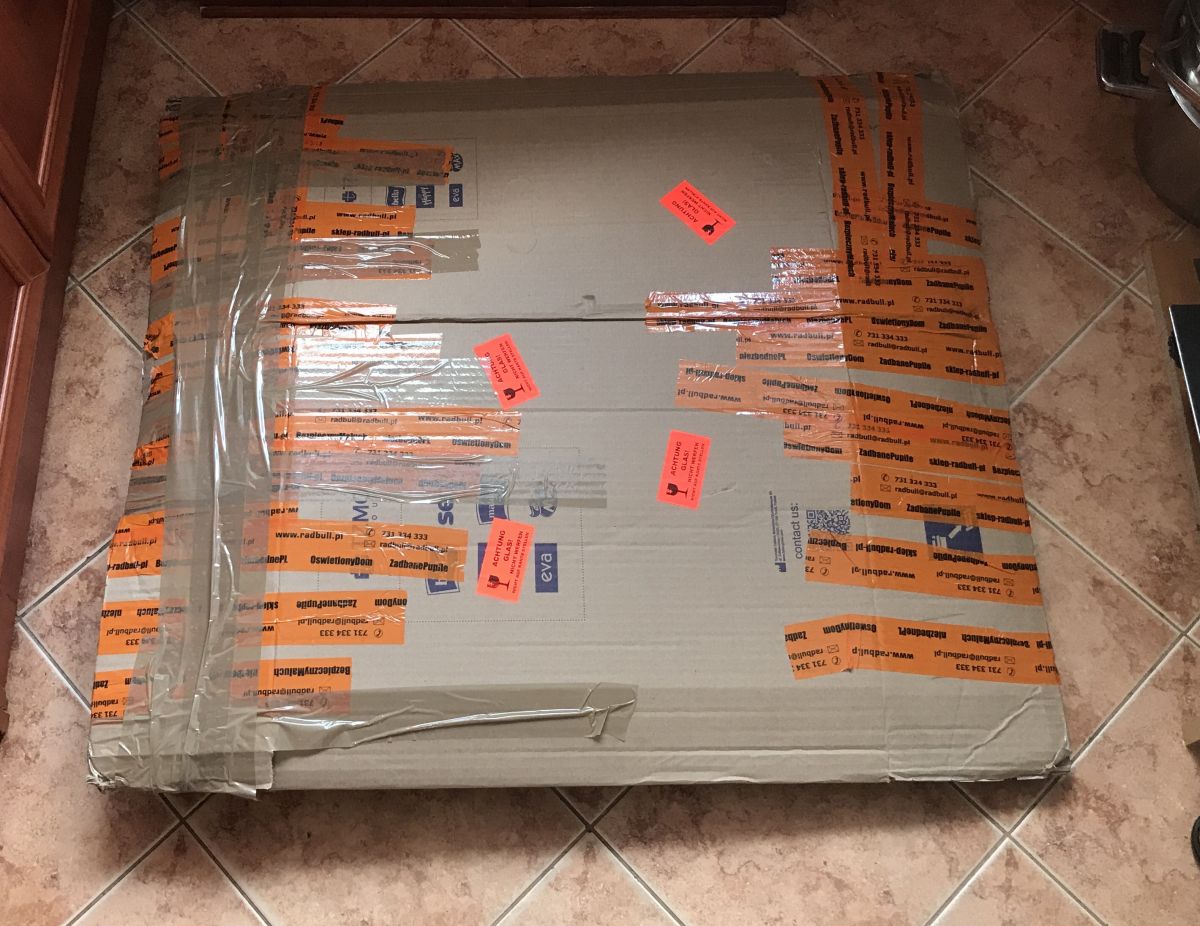

    Let's see what we get in practice:

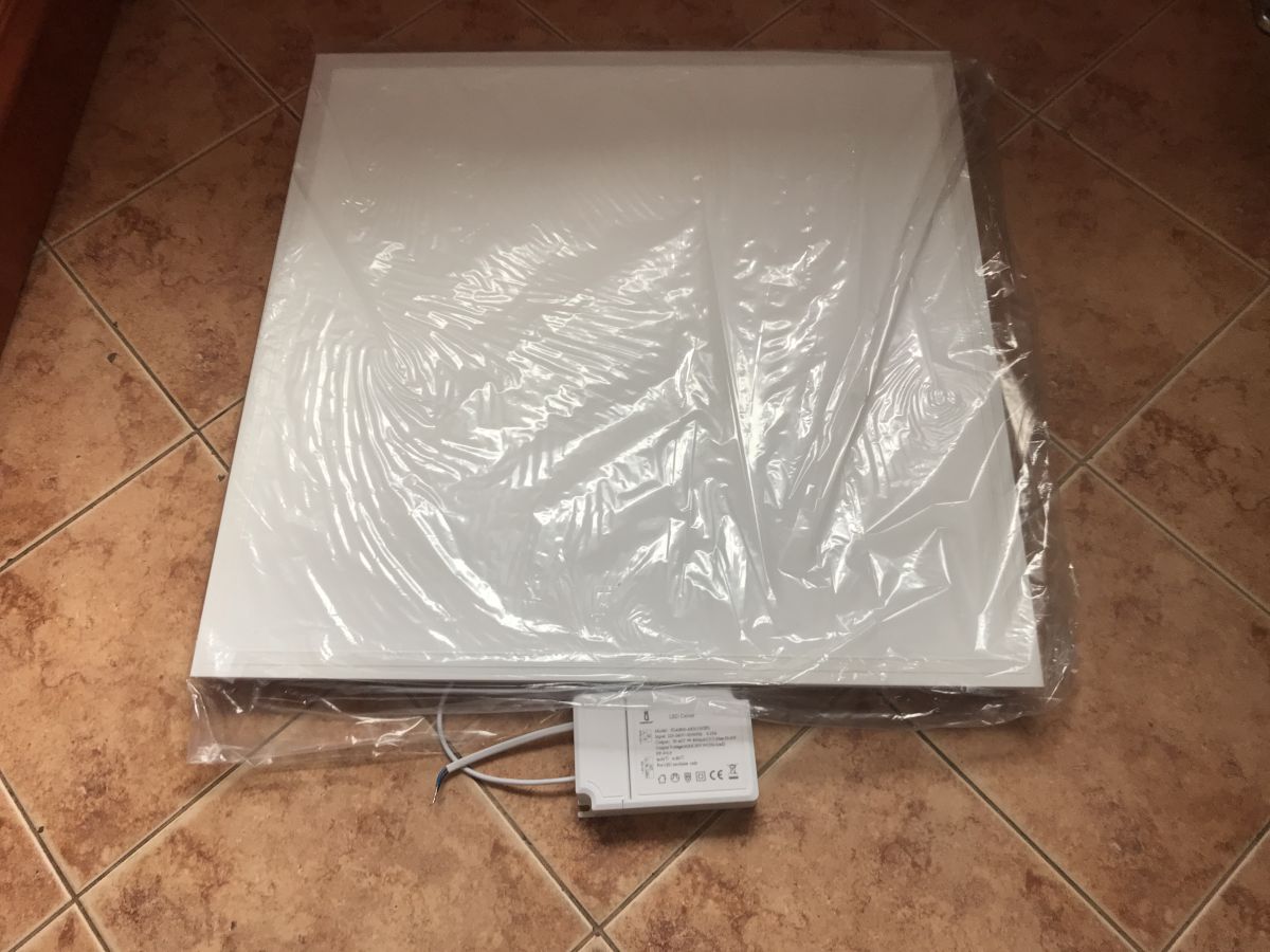

    Package containing a 60x60 cm LED panel.
    It wasn't very well protected. No Styrofoam, just a little filler-macrofoam they gave to the package:
    Box of large LED Smart Back-Lit panel from Aigostar.
    In the cardboard box is the panel and driver, already without any additional protection from damage in transit:
    AgPanSMART606025 LED panel in packaging

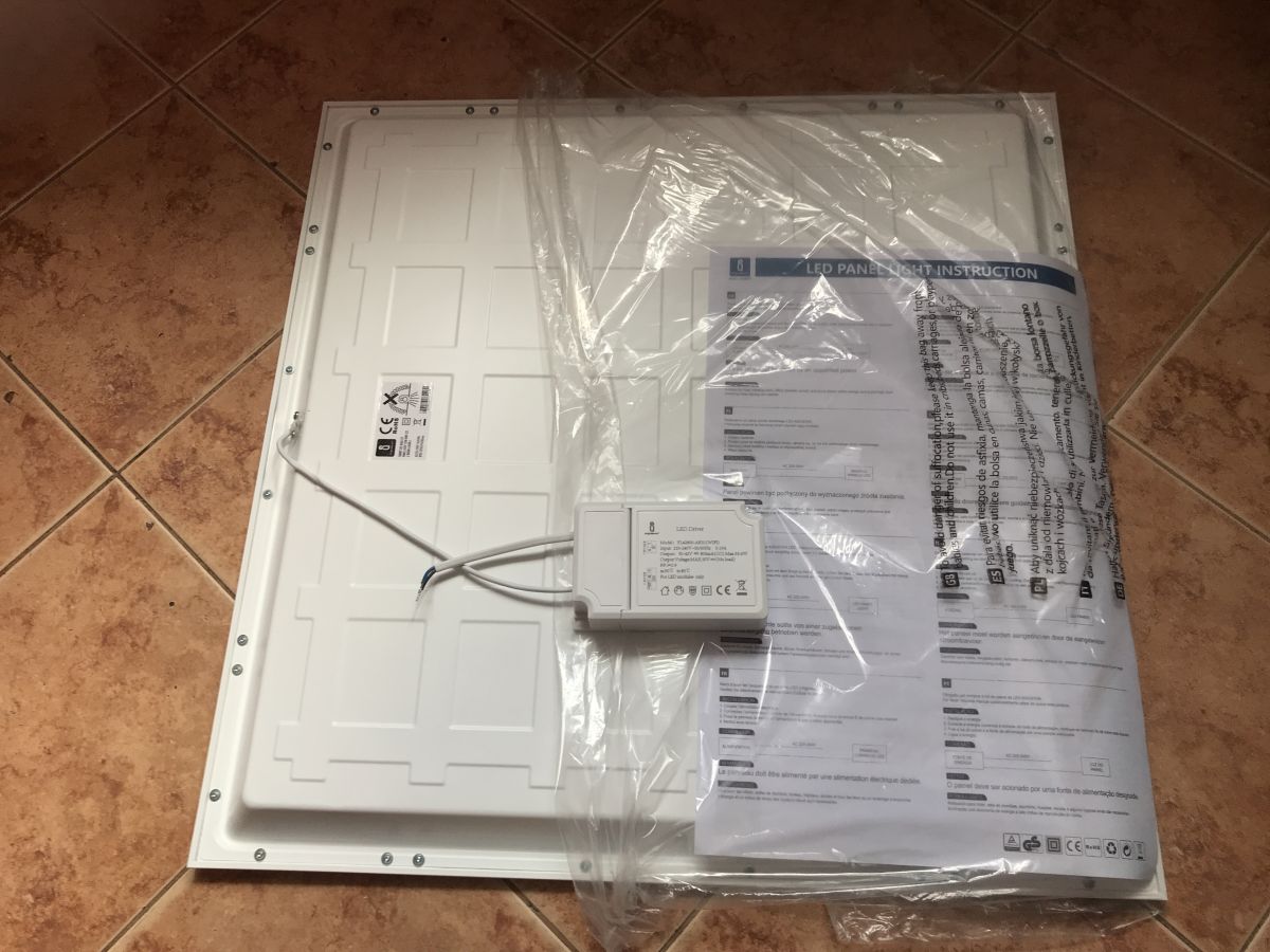

    The other side of the light:

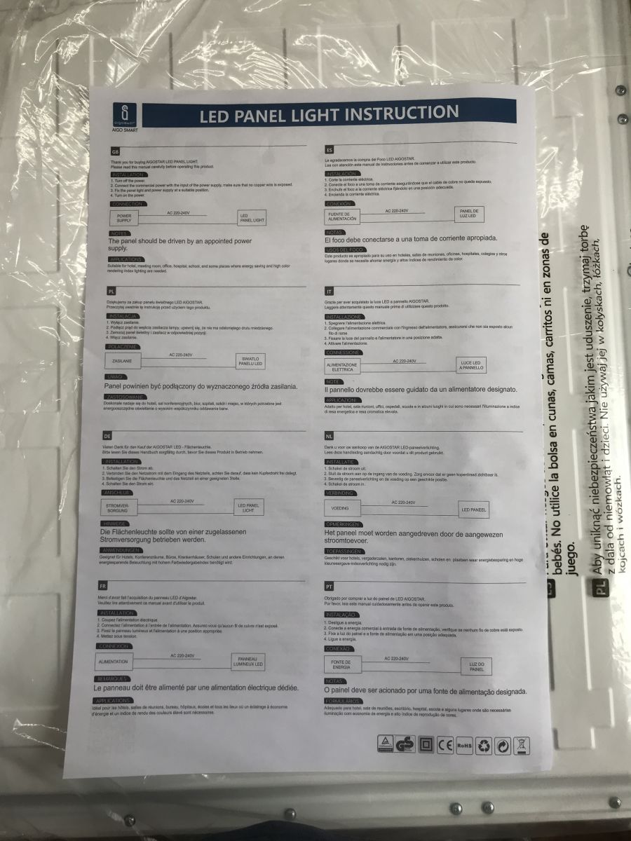

    AgPanSMART606025 LED panel with instructions and driver in plastic wrap.

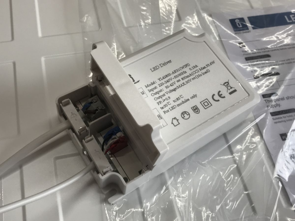

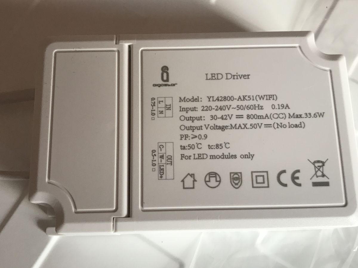

    Driver's markings are: YL42800-AK51 (WiFi)
    Agiosmart YL42800-AK51 LED driver for LED panel. Instructions:
    Agosmart LED panel instructions in various languages AigoSmart instruction manual for LED panel with visible QR code

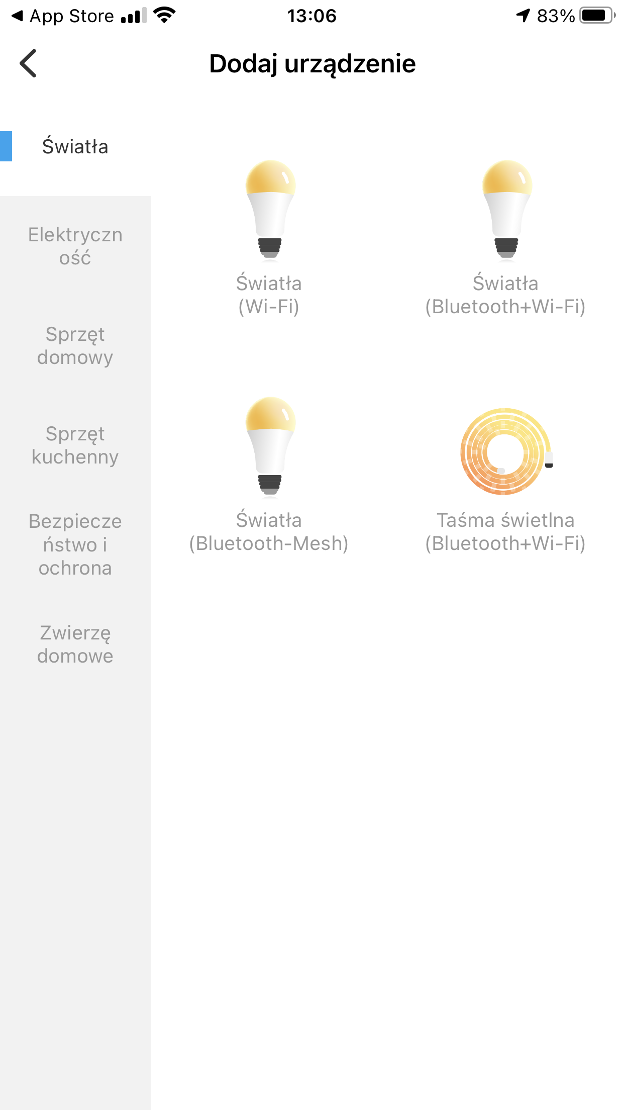

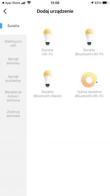

    Pairing with the manufacturer's app For Tuya products, I don't test this at all anymore, but since it's an Aigosmart, I figured it was worth checking to see if it could be paired easily. I put the device into pairing mode according to the instructions and the lamp started giving light signals:
    Interestingly, the phone showed bars from PWM brightness level control:
    Application I installed on an iPhone, its interface somewhat resembles that of Tuya but there are far fewer devices:
    Device addition menu in the app with light selection options.

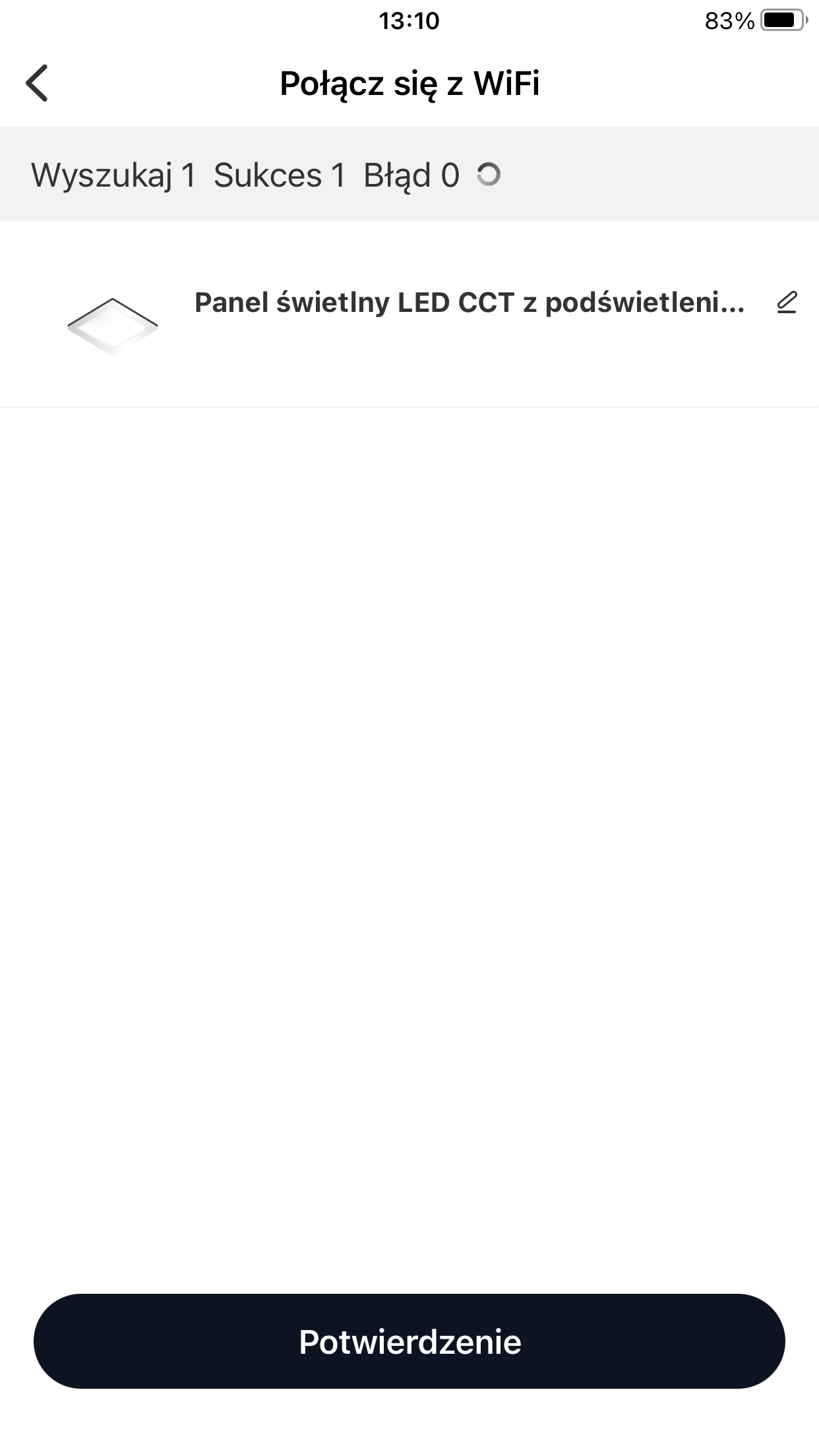

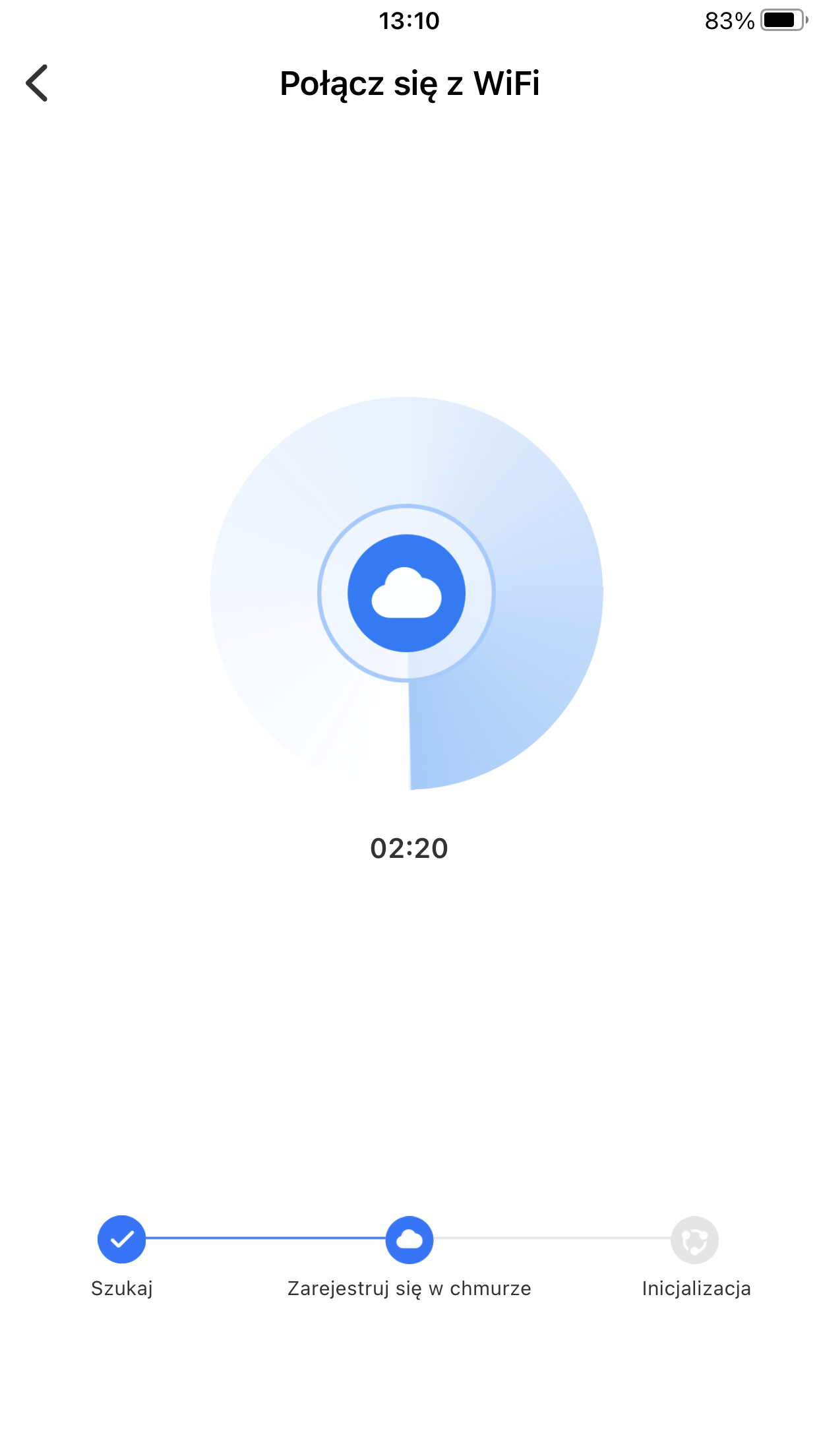

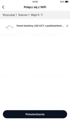

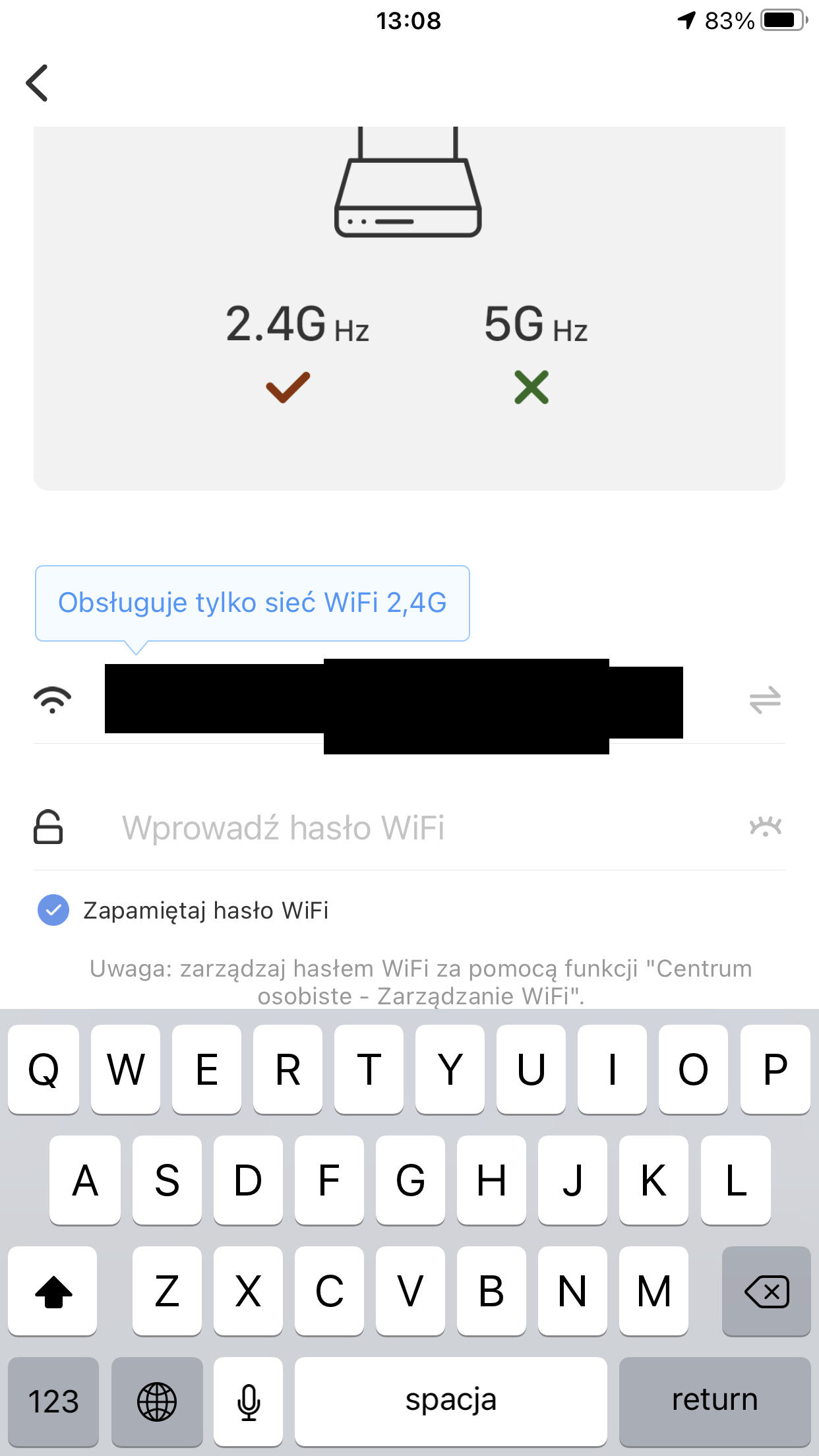

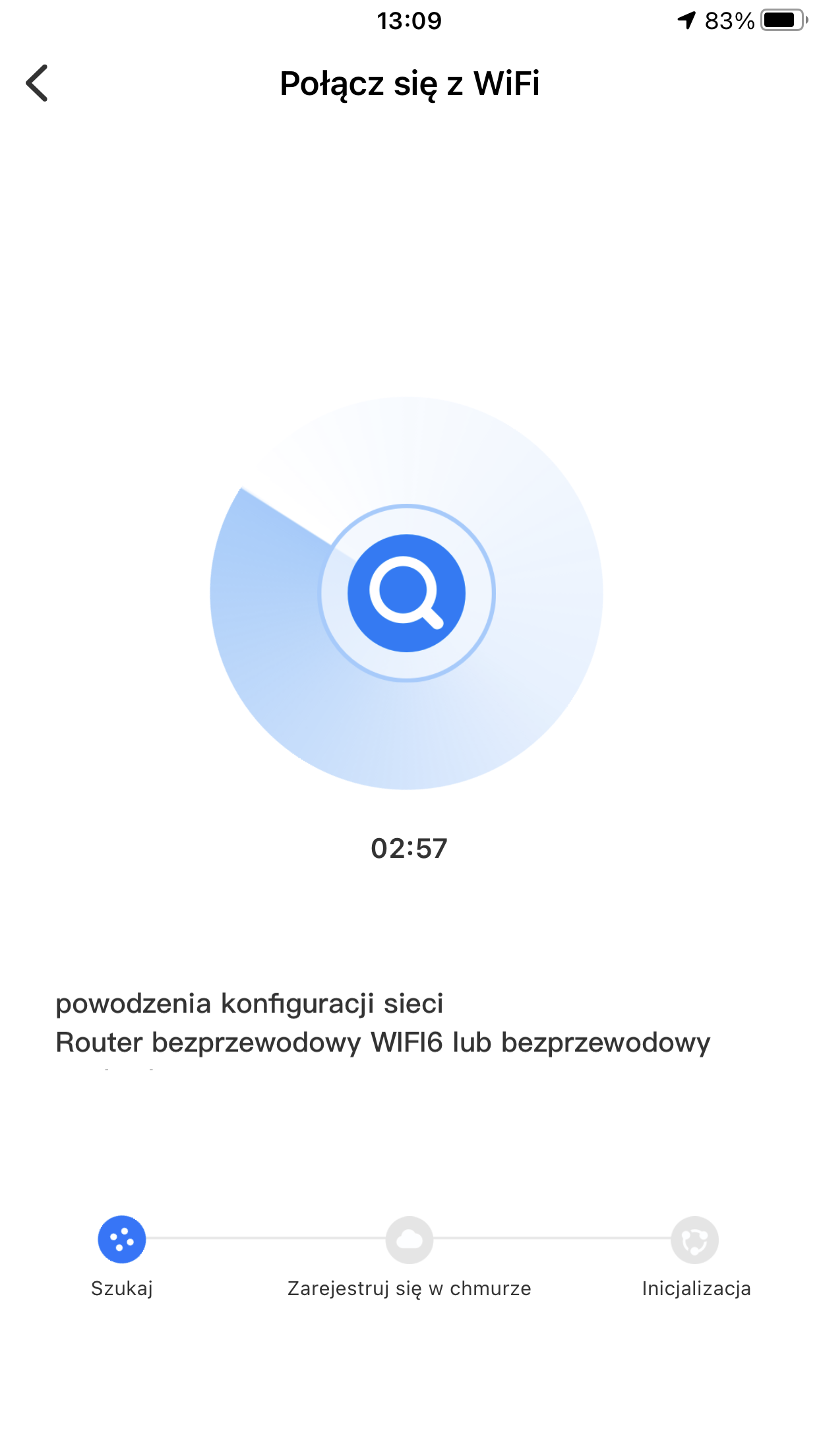

    I gave directions to my WiFi and waited for a response:
    WiFi connection pairing app screen. Wi-Fi pairing screen indicating support for 2.4 GHz.
    Success:
    Mobile app screen during WiFi connection with visible timer. Screenshot of the app showing successful connection with the LED panel.

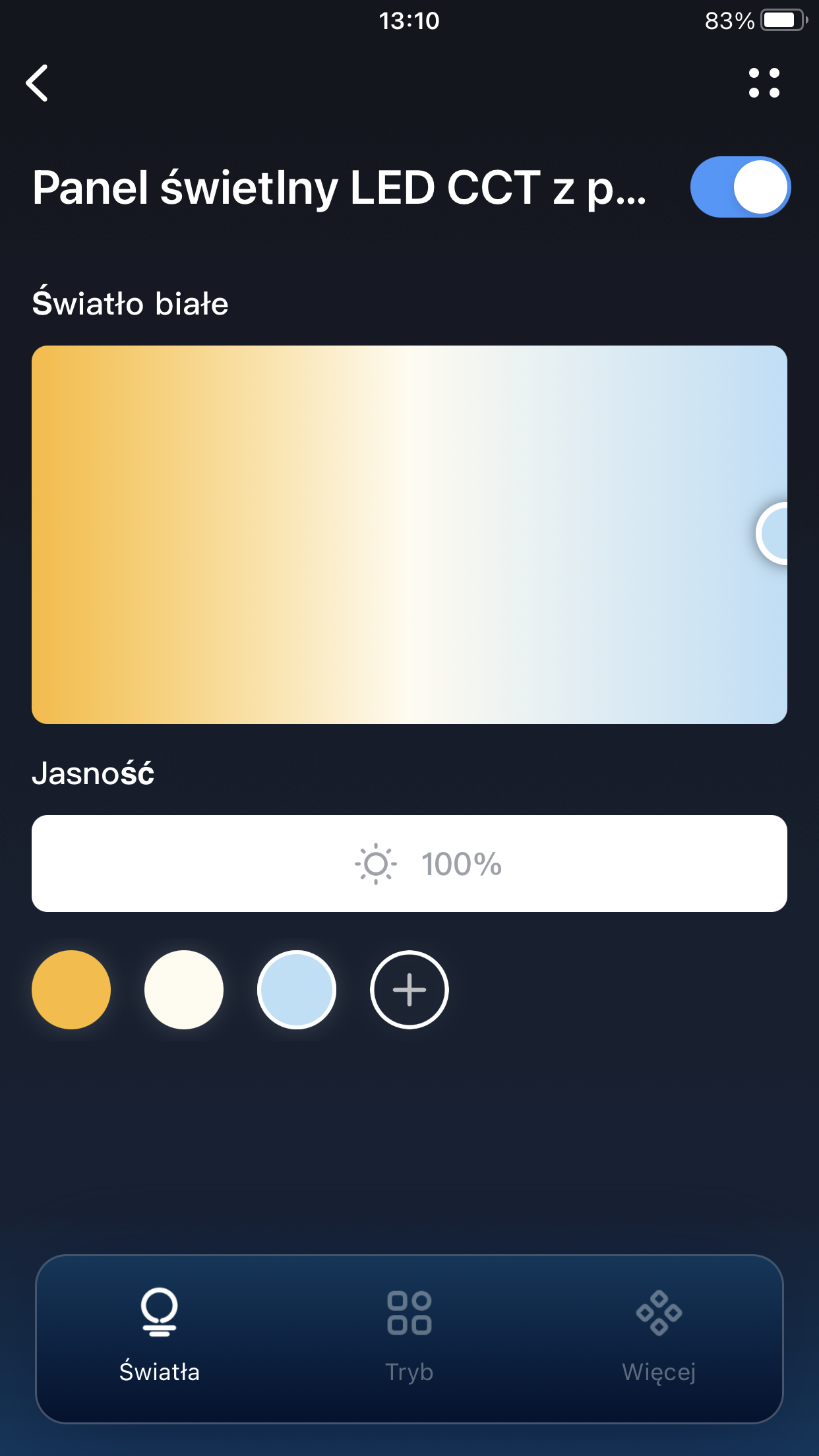

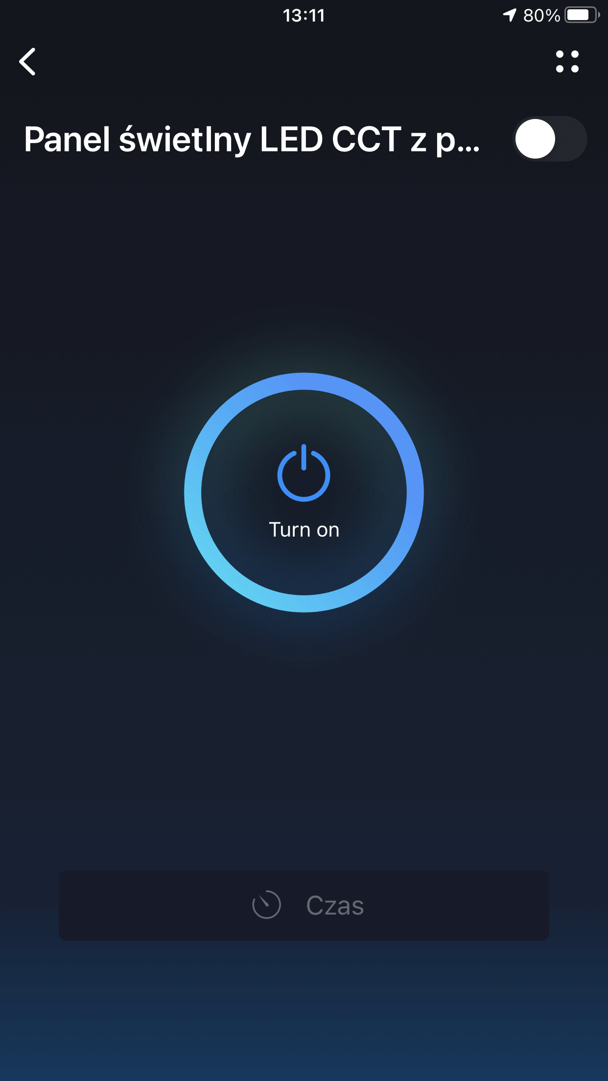

    It wasn't that hard. So what does the interface look like in the application?

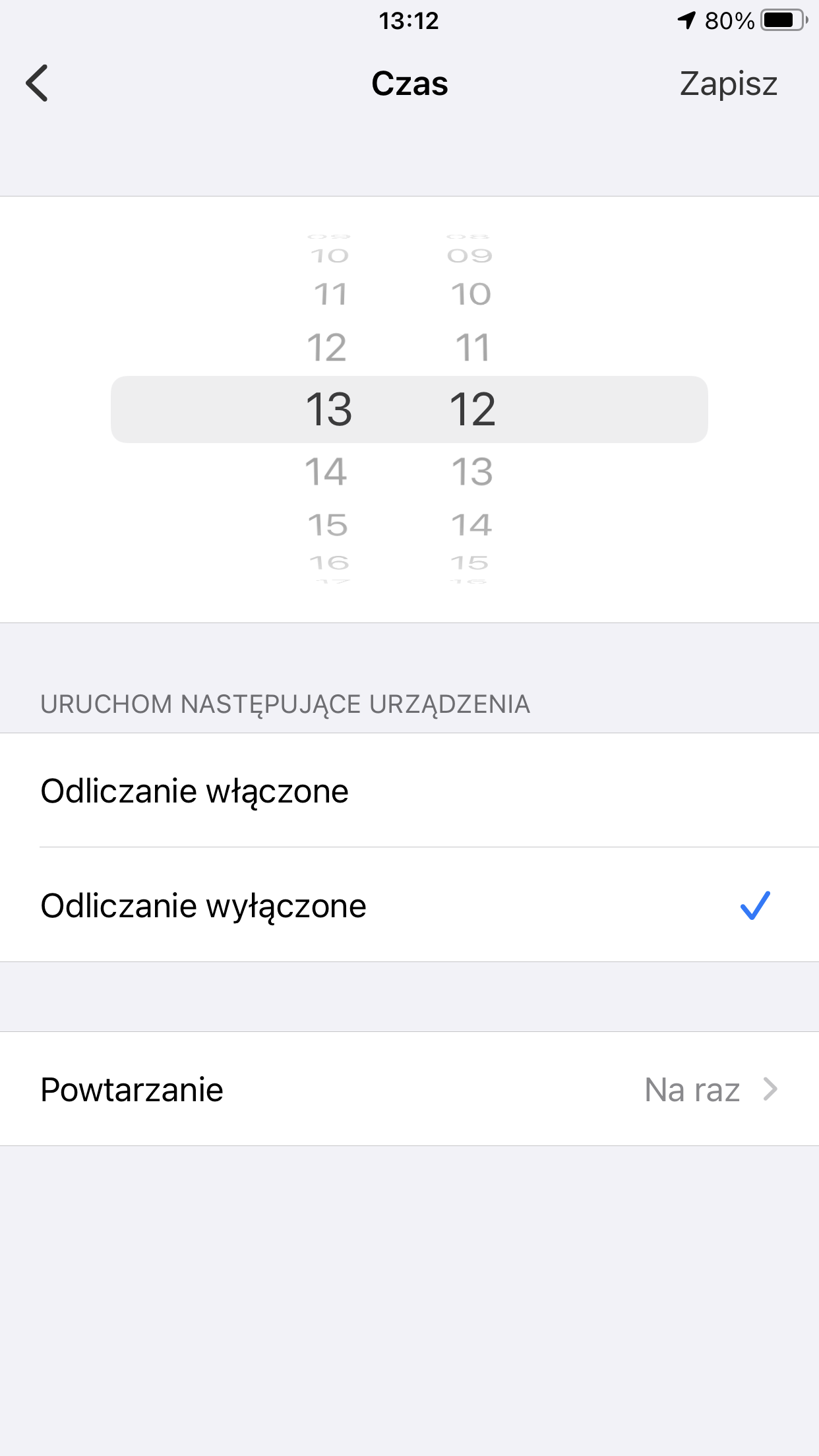

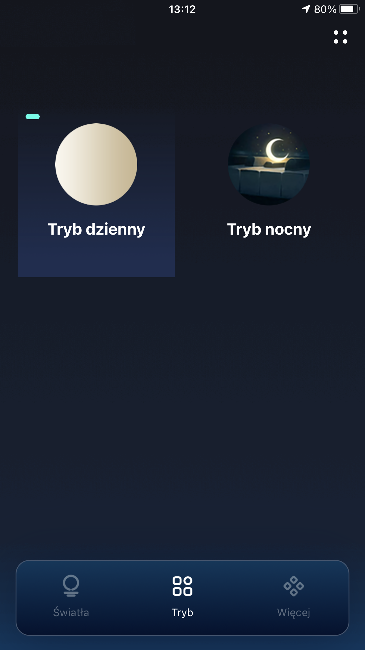

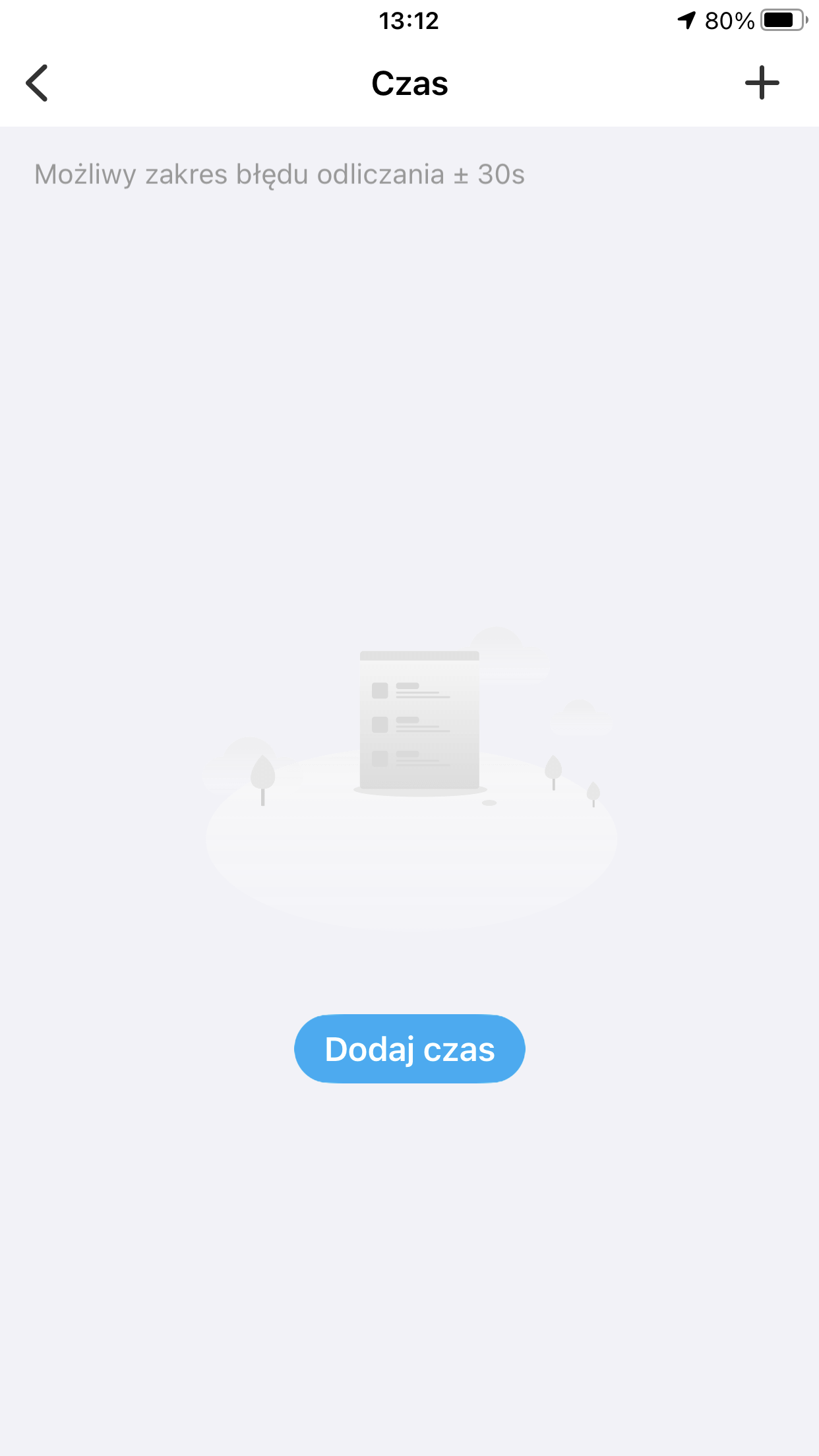

    The capabilities of the manufacturer's application The application's interface is quite poor, But what more can you expect here?
    App interface for LED CCT panel showing brightness and light color control.
    Mobile app screen with lighting modes: day and night. Mobile app interface for controlling an LED panel with an on/off option. Of course simple timers and automations are there:
    Smartphone app interface for controlling LED panel Mobile app for setting time for LED panel.

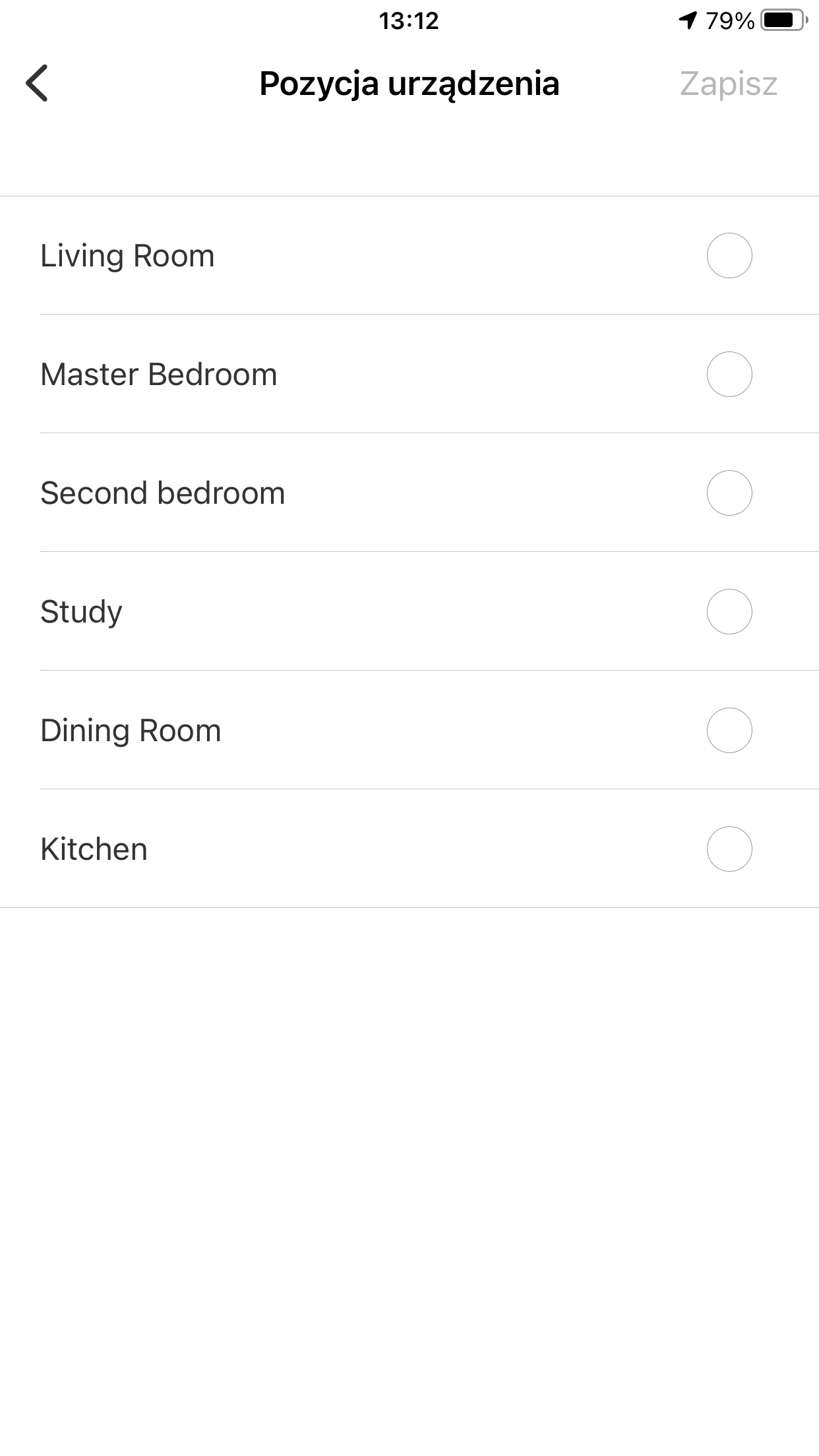

    There is some grouping by room:
    Device position selection screen in a mobile app. Mobile app menu with device settings.

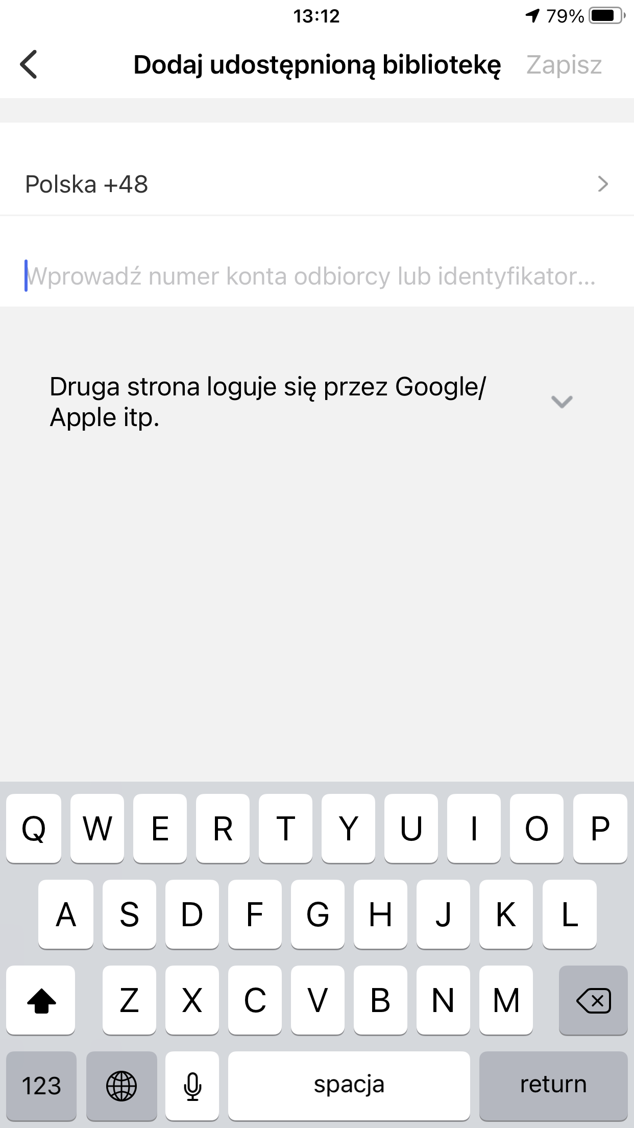

    Some sharing (by phone numbers...):
    Screen for adding a shared library with a field for a number.

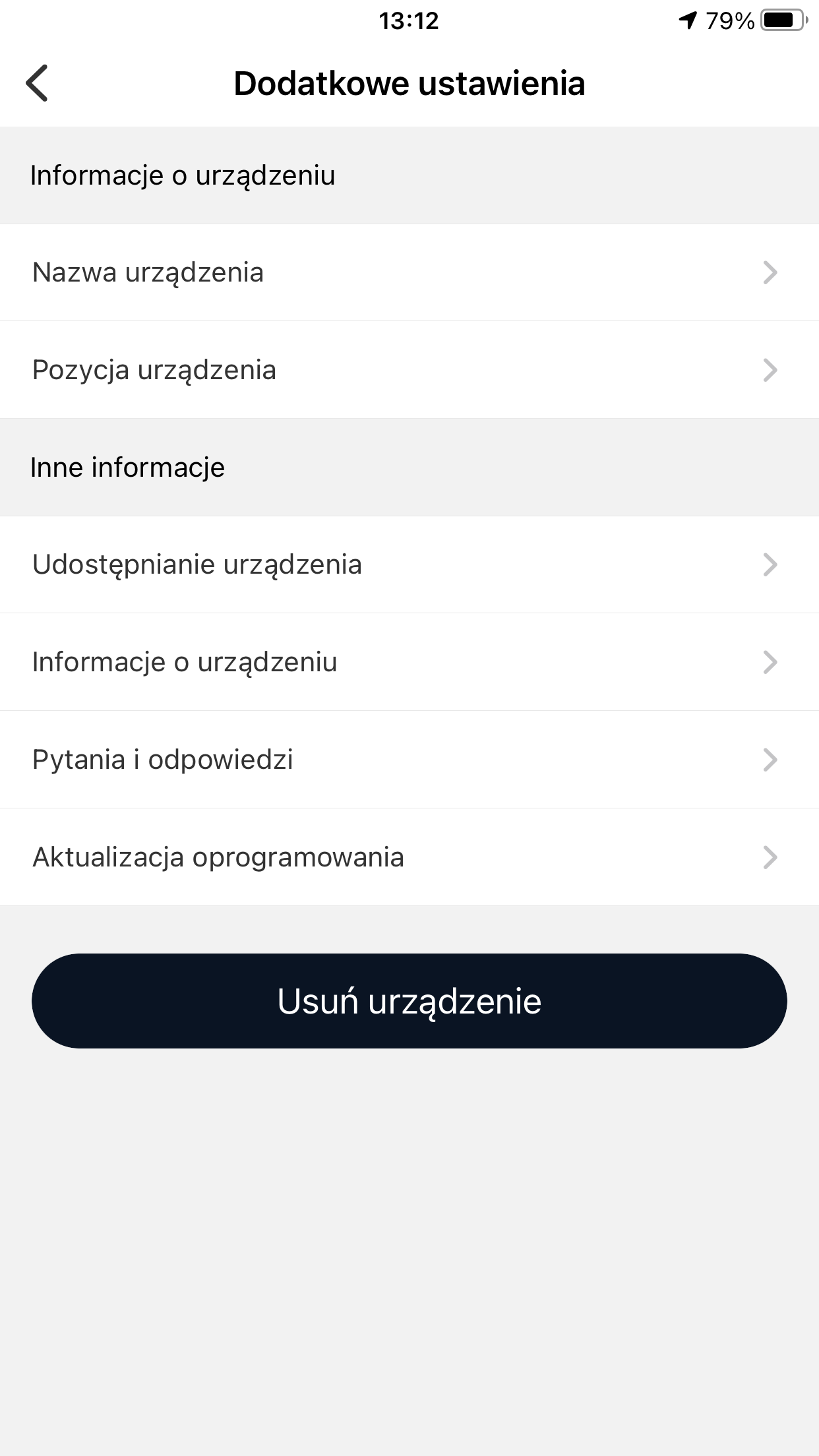

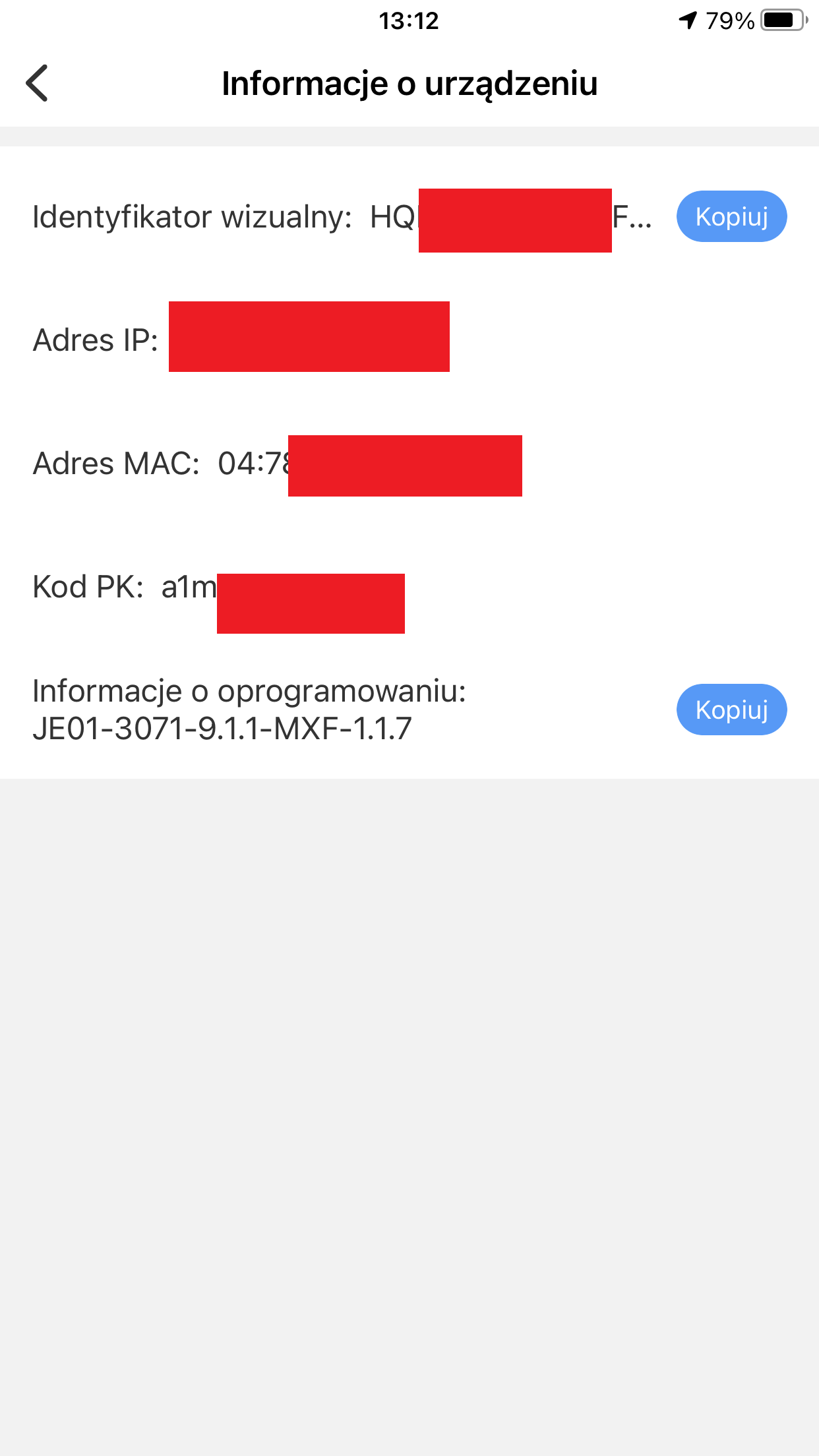

    Some device parameters:
    Screenshot of AigoSmart device information on an iPhone.

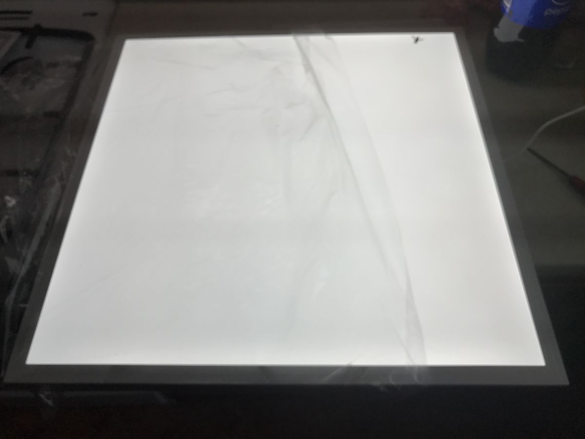

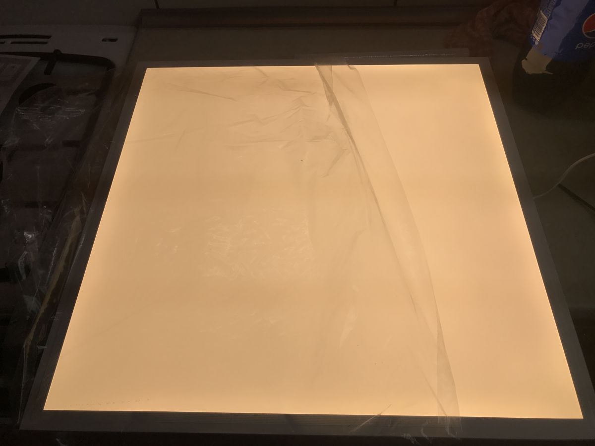

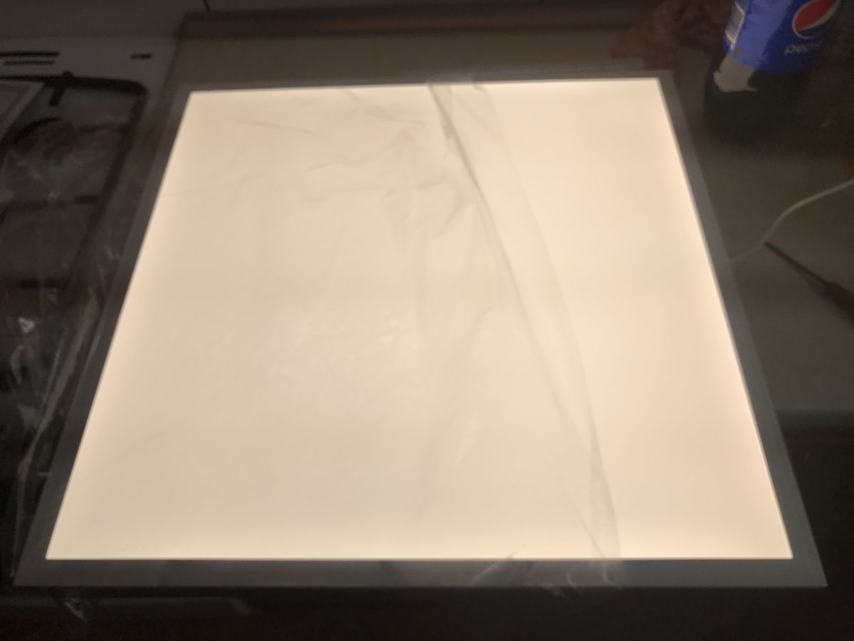

    Effects:
    Illuminated LED panel measuring 60cm x 60cm. Illuminated LED panel with warm light color Illuminated LED panel measuring 60x60 cm. But we want to free the device from the cloud and connect it to HA, so it's time to look inside.

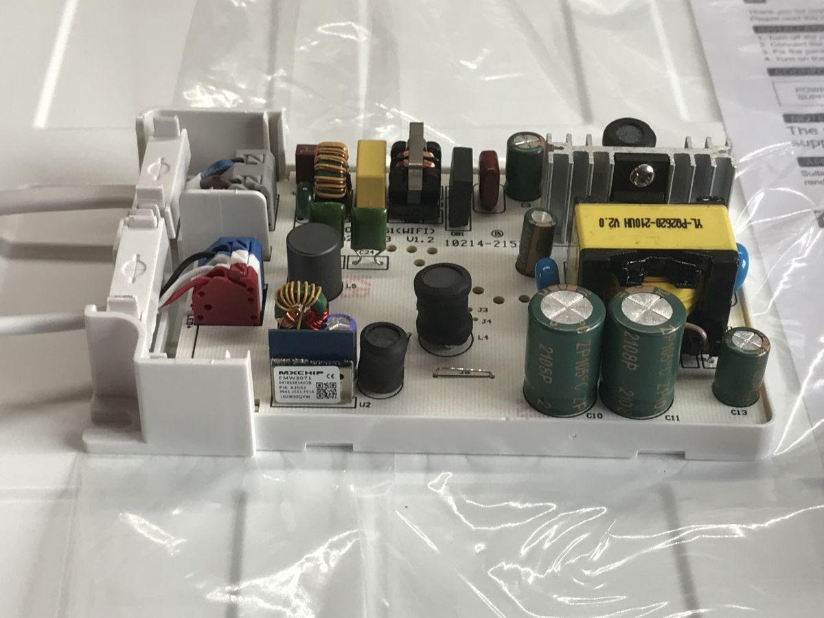

    Inside of the LED controller
    I didn't open the LED panel itself, because why should I? Everything is in a separate box:
    White LED driver model YL42800-AK51 with labels and symbols.
    The wires are protected quite nicely:
    AgPanSMART606025 LED panel and LED Driver power supply.
    We take a look and.... disappointment:
    Inside of LED panel control module AgPanSMART606025

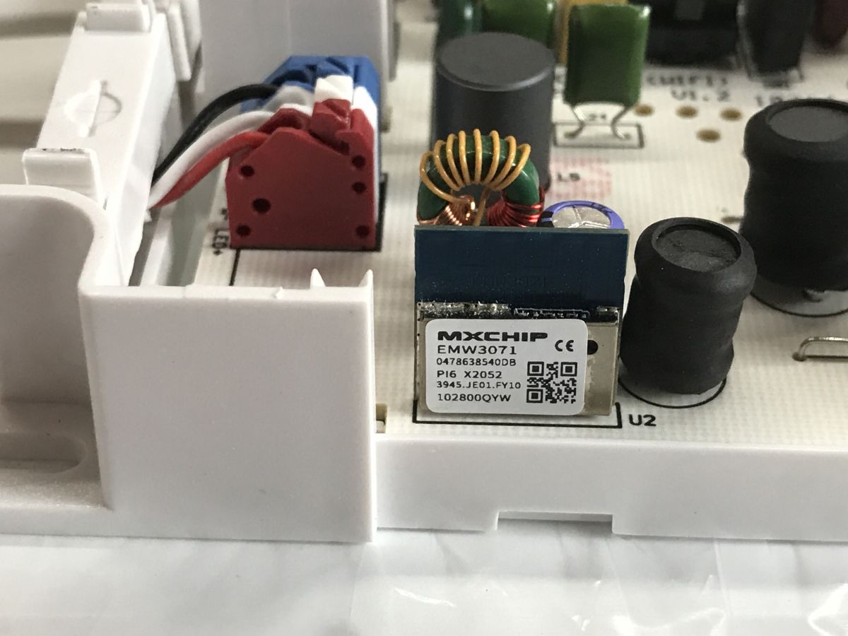

    There is some exotic WiFi module:
    MXCHIP EMW3071 WiFi module on LED panel board. EMW3071 made by MXCHIP. In fact, I have already encountered one similar one:

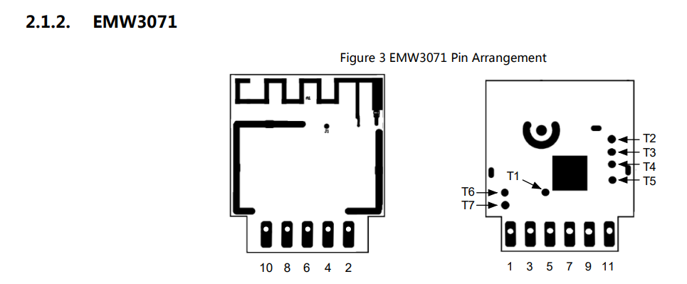

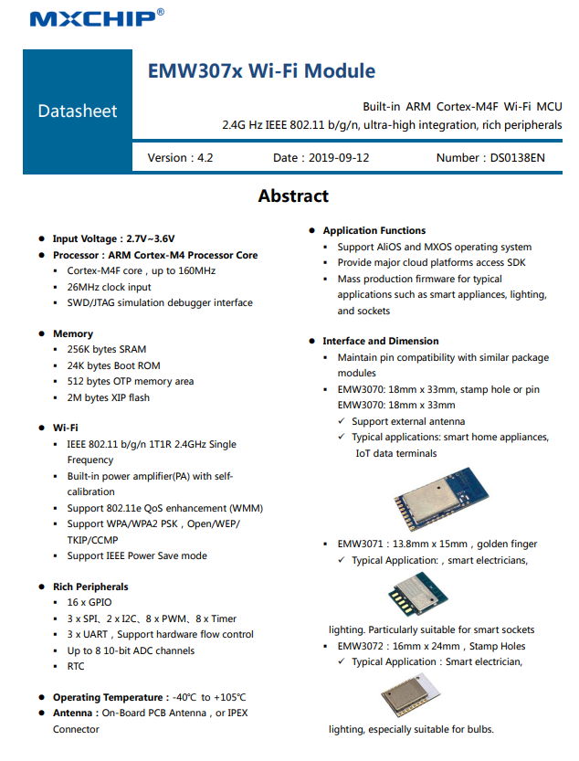

    The RGBCW on MXCHIP EMW3072 - Aigostar Smart 18872 18W RGB+CCT Is there any documentation of EMW3071 on the web?
    Datasheet of the EMW307x Wi-Fi module with technical specification details.
    This means we have a Cortex-M4F core here.

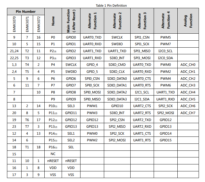

    Displacements:
    Pin arrangement diagram of the EMW3071 WiFi module.
    Pin definition table for EMW3070 and EMW3071 modules. This strongly reminds me of TYWE2S and CB2S/WB2S. The power and ground locations also match.

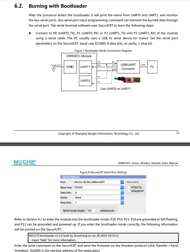

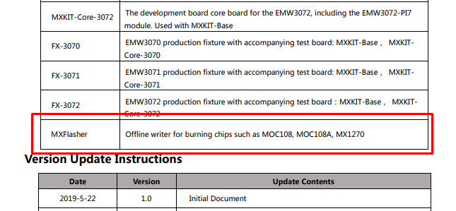

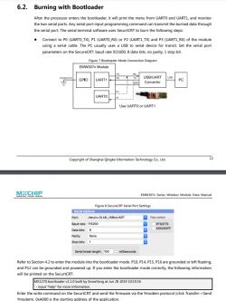

    Apparently MXFlasher can program it:
    Documentation regarding the MXFlasher programmer.
    There is also bootloader information:
    Bootloader instructions for MXCHIP EMW307x module.

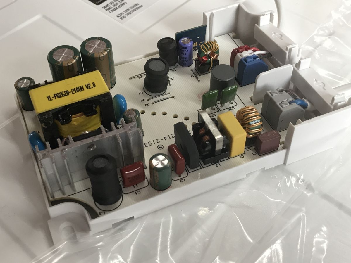

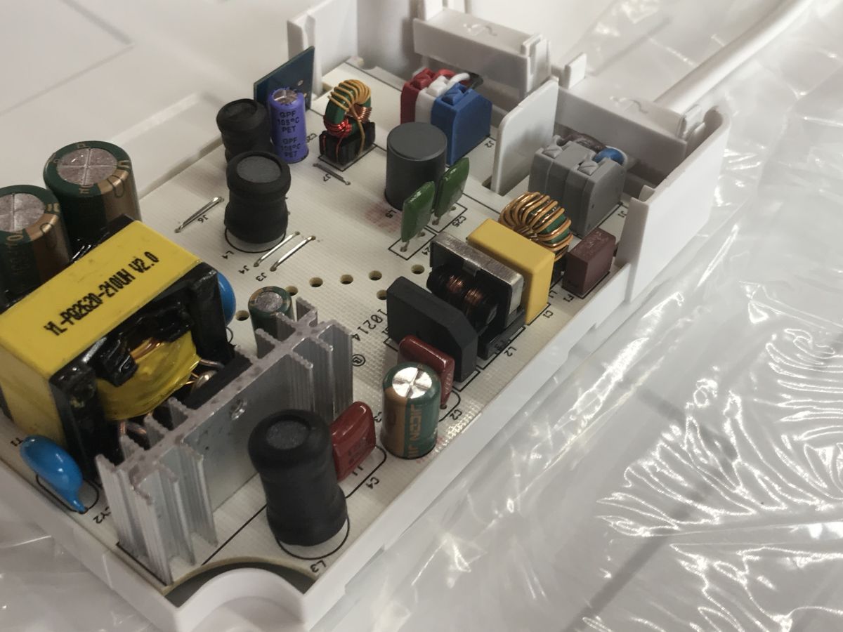

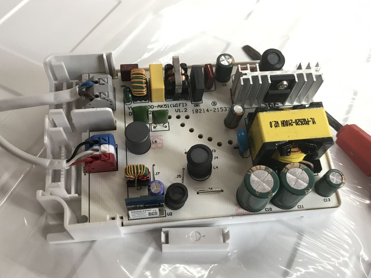

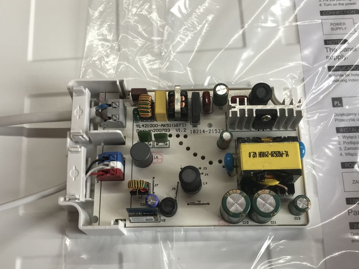

    But let's go back to the board analysis:
    LED panel control module with visible electronic components
    There must be separate inverters, one for the LEDs, the other for the WiFi module.. The one for LEDs is based on the AC874B:
    Close-up of electronic components inside an LED panel
    The module doesn't seem so bad, there's a solid heatsink, there are filters on the input and it's quite rich, which you don't always find in Chinese products:
    Circuit board inside the AgPanSMART606025 LED panel. Inside view of the LED controller with visible electronic components.

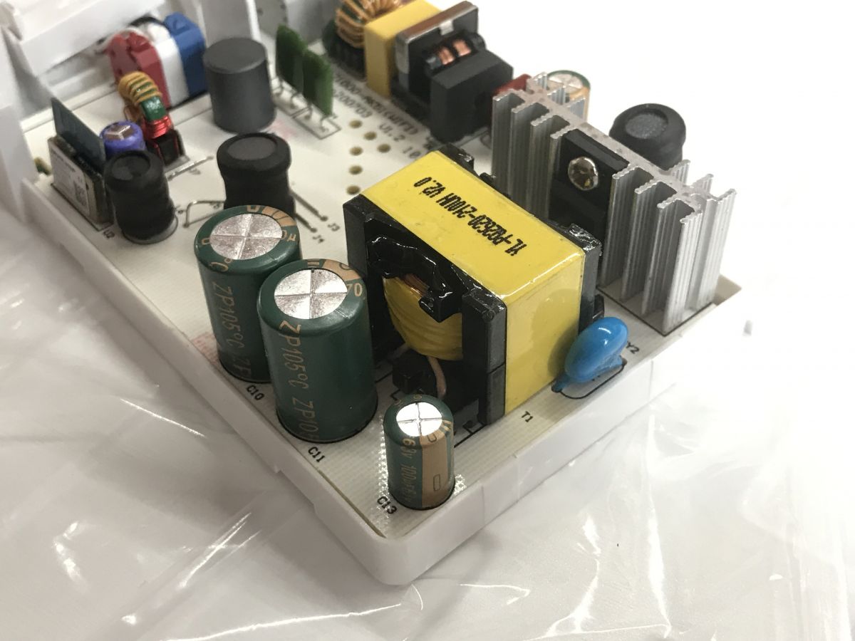

    The transformer has a Y capacitor that connects the primary and secondary sides:
    Close-up of a circuit board with electronic components and a heatsink.

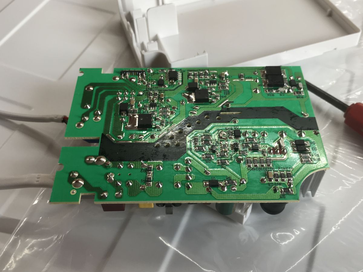

    It's time to free the wires and remove the entire PCB:
    Interior of LED controller with visible electronic components
    Much of the circuit is made using SMT technology:
    Printed circuit board with electronic components of the AgPanSMART606025 LED panel
    Close-up of the circuit board of the AgPanSMART606025 LED panel
    You can clearly see the separate sides, primary and secondary of the circuit.

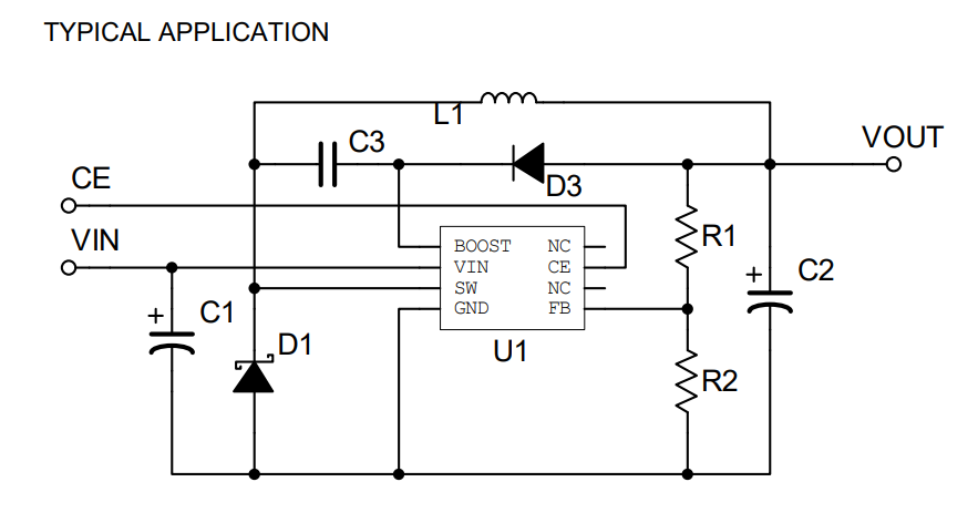

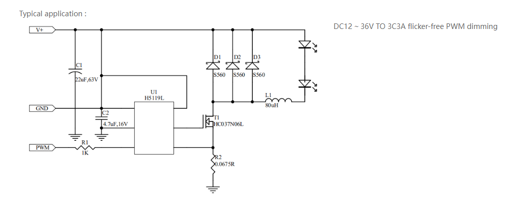

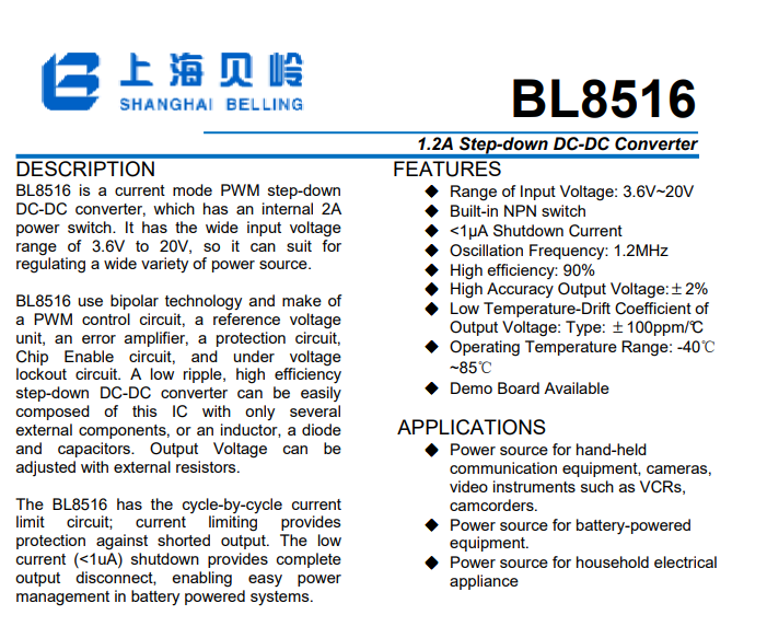

    3.3V for the WiFi module is provided by the BP8516:
    Technical documentation of the BL8516 converter. Typical application of an electronic circuit with labeled components Only its input voltage is up to 20V, so it is not powered directly from the mains. Here there must be a different inverter beforehand.

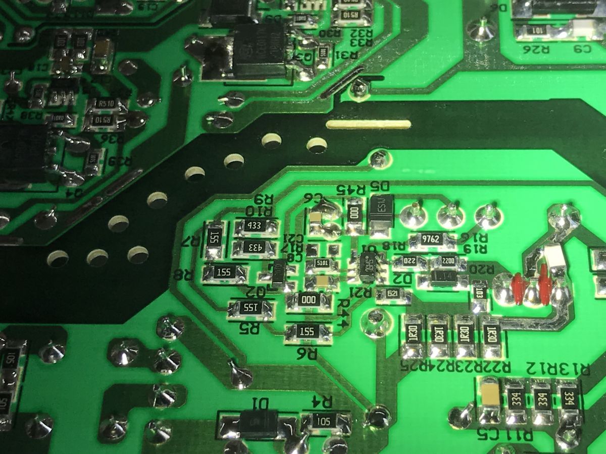

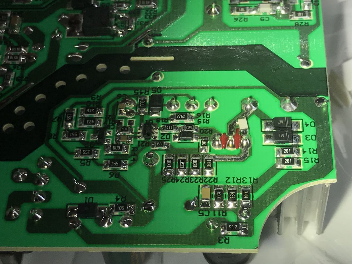

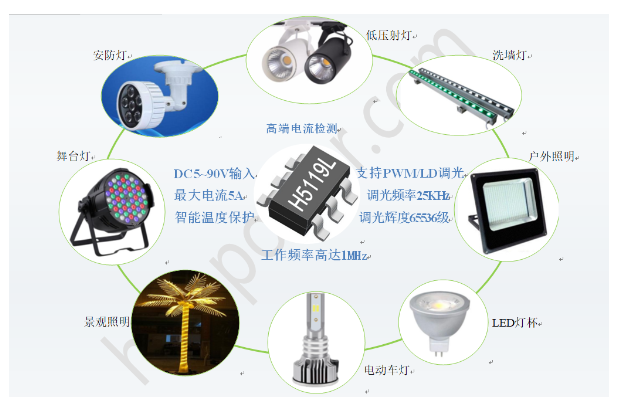

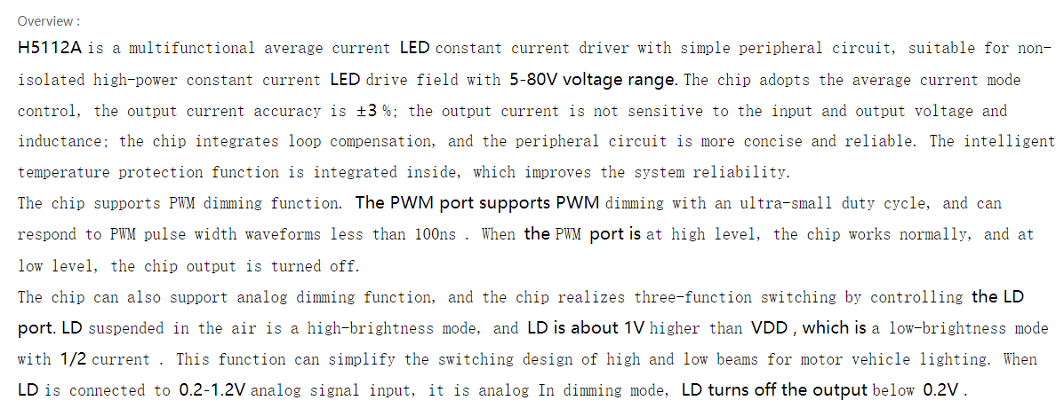

    The NCE0117K MOSFET, SS510B diode and a small controller with a not very clear designation (H5119L?) look like controllers separately for warm and cold color. If that controller is the H5119L, the whole thing probably looks more or less like this:
    PWM dimming control schematic for LED panel.

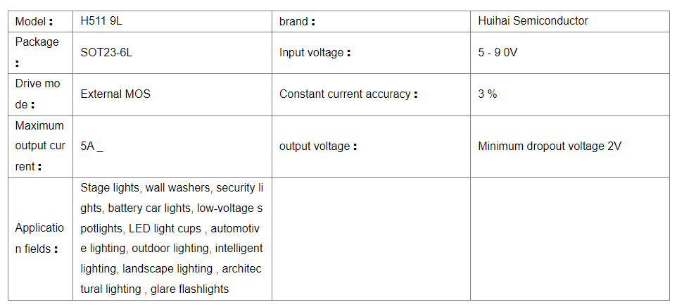

    And again, you can see that this doesn't run on line voltage, but on low voltage from the aforementioned power supply.
    Some more information about the H5119L:
    Illustration showing various types of LED lighting. Technical specifications table for the H511 9L controller. Description of H5112A LED current driver functions. This is where we have the Schottky diodes on the output of the transformer, the main one, from the low voltage. That's probably where the flyback converter is. It's the one that converts the mains voltage to low voltage for the rest of the circuit:

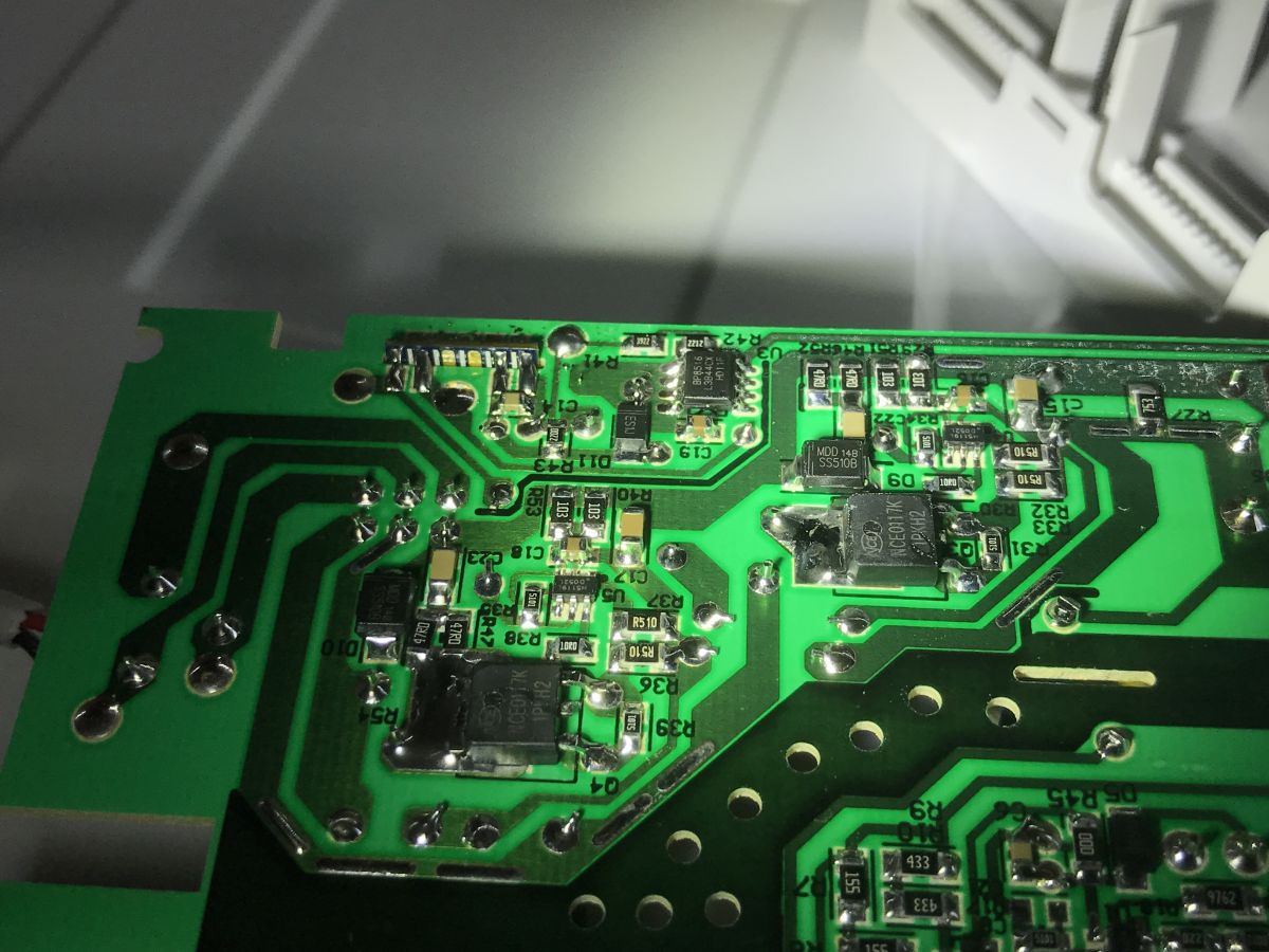

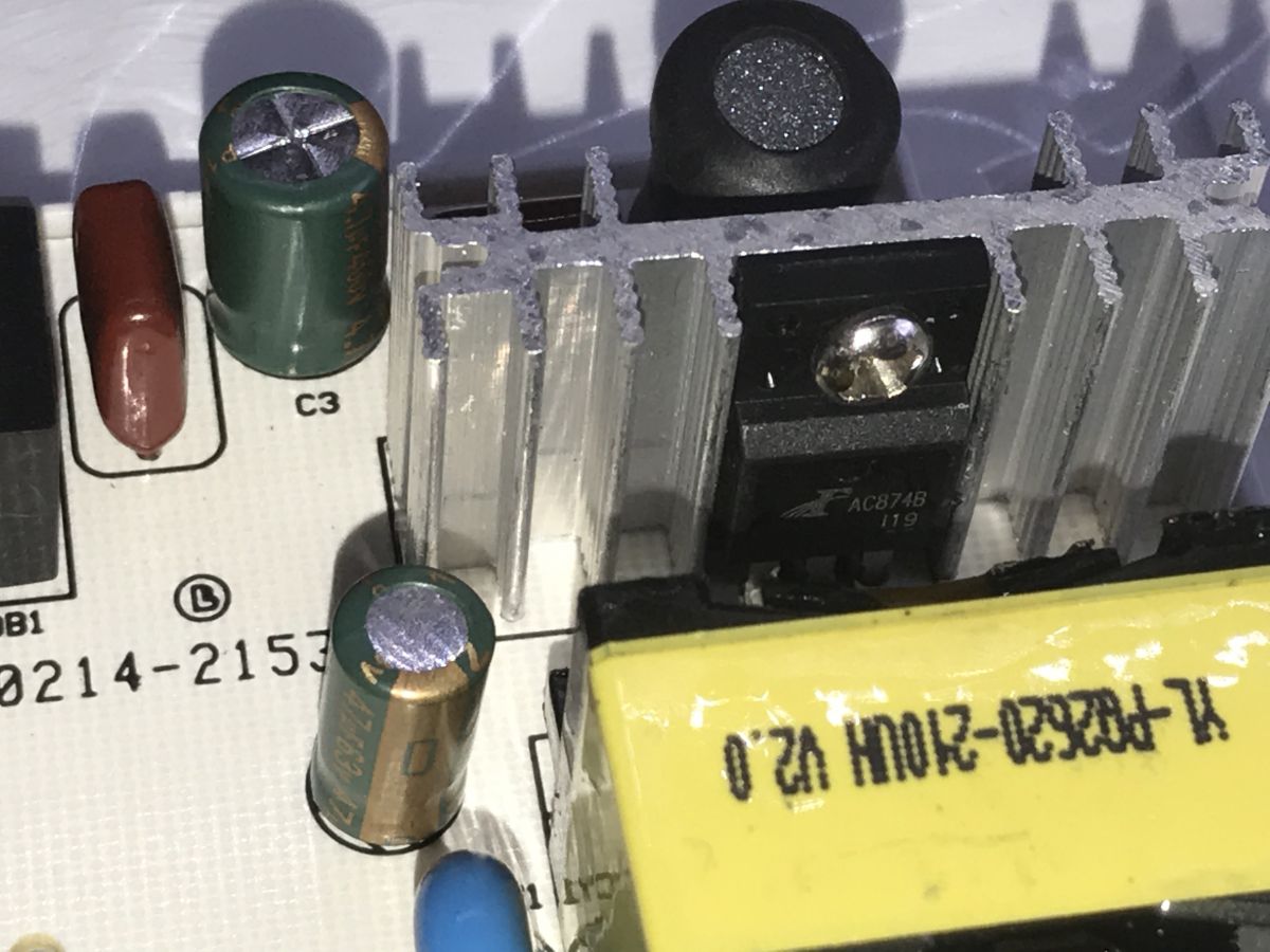

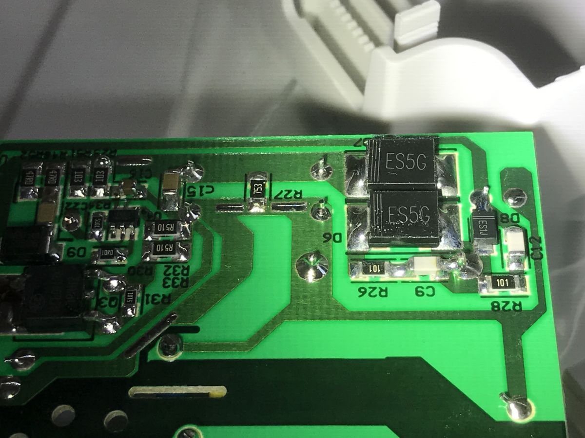

    Close-up of a circuit board with electronic components and two ES5G chips.
    This is the primary side of the already mentioned inverter, you can see the legs from the keying transistor and the components that are probably the fade from the primary winding, there is also the inverter controller in SMD:
    Close-up of LED circuit board with electronic components
    Circuit board with electronic components.
    I'm not sure of the designation of this inverter controller, probably not 5H5L? If someone wants to, they can look up and fill in the subject.

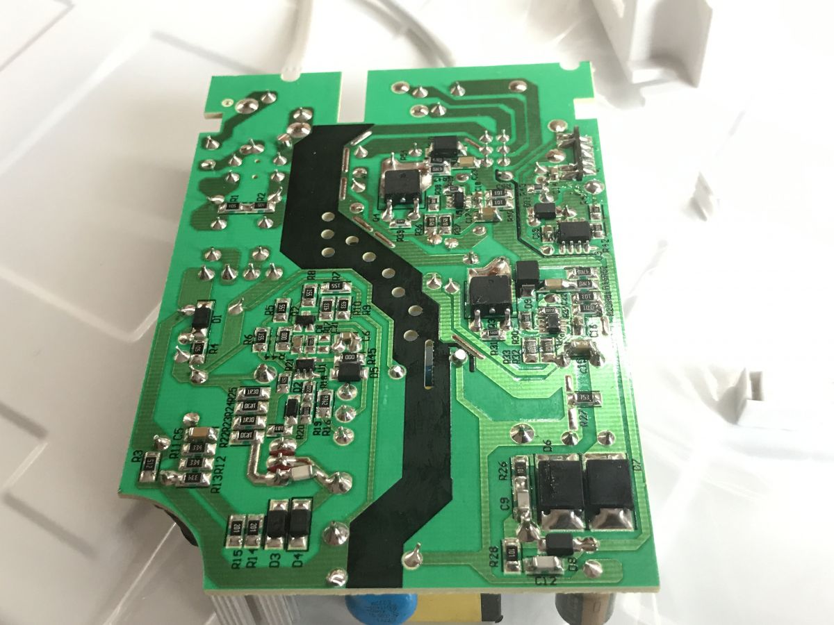

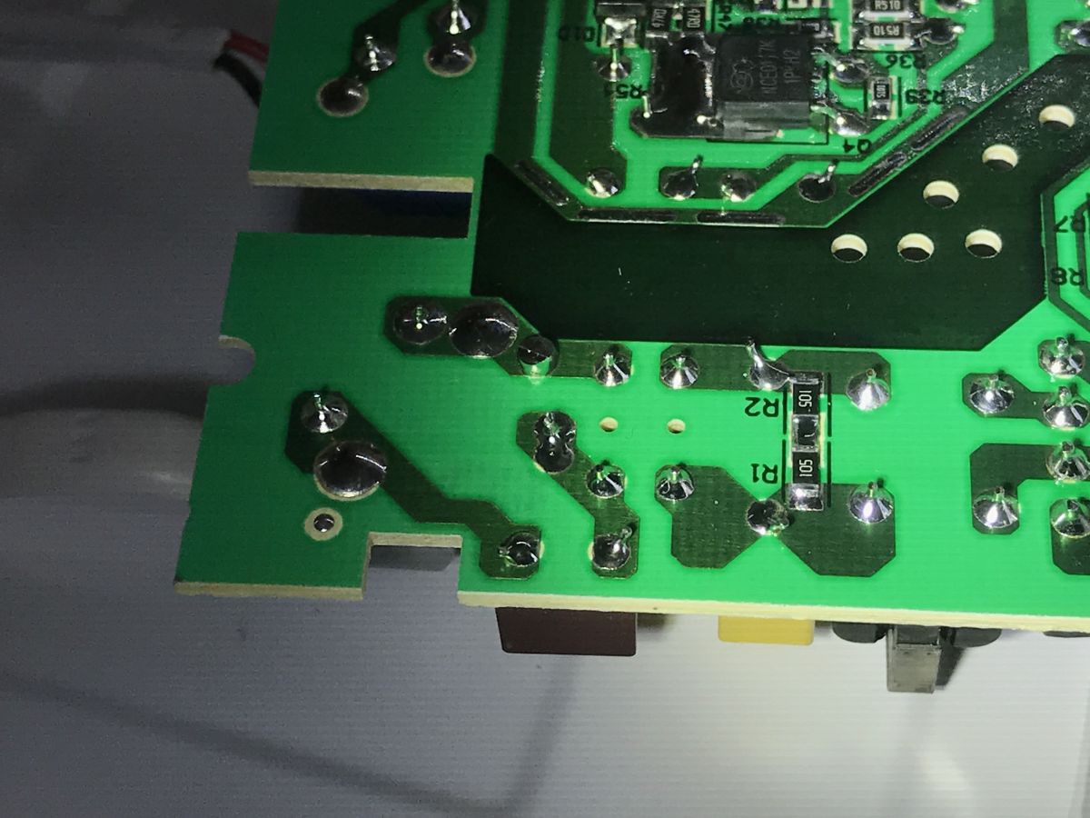

    Well, also the filter section from underneath:
    Close-up of a PCB with electronic components.

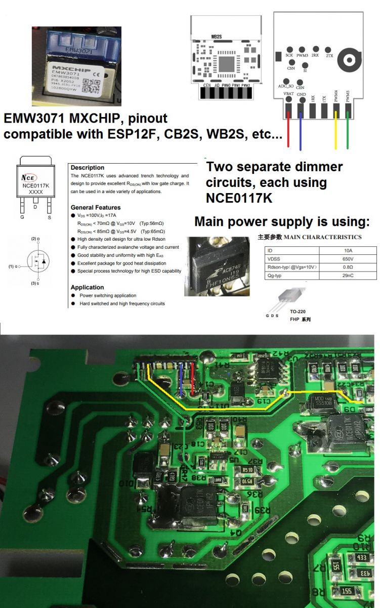

    How to make this device cloud free? At this moment there is no software for MxChip. I haven't managed to get a suitable SDK up and running yet.
    But a brief analysis of the PCB shows that TYWE2S or ESP12 will fit here. So just swap the WiFi module and set two PWM pins for it. Tasmota can handle it. Here's a quick rundown:
    Image of the EMW3071 MXCHIP WiFi module and circuit board with description.
    I will be doing this process and will describe it in the next topic.
