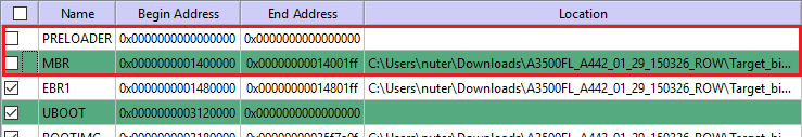

    SP flash tool (MediaTek) - Instructions for uploading the firmware
    The program will now load the files with our firmware.
    CAUTION: if you are not sure if the firmware you upload is 100% compatible with your device, uncheck the first two blocks.
