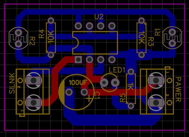

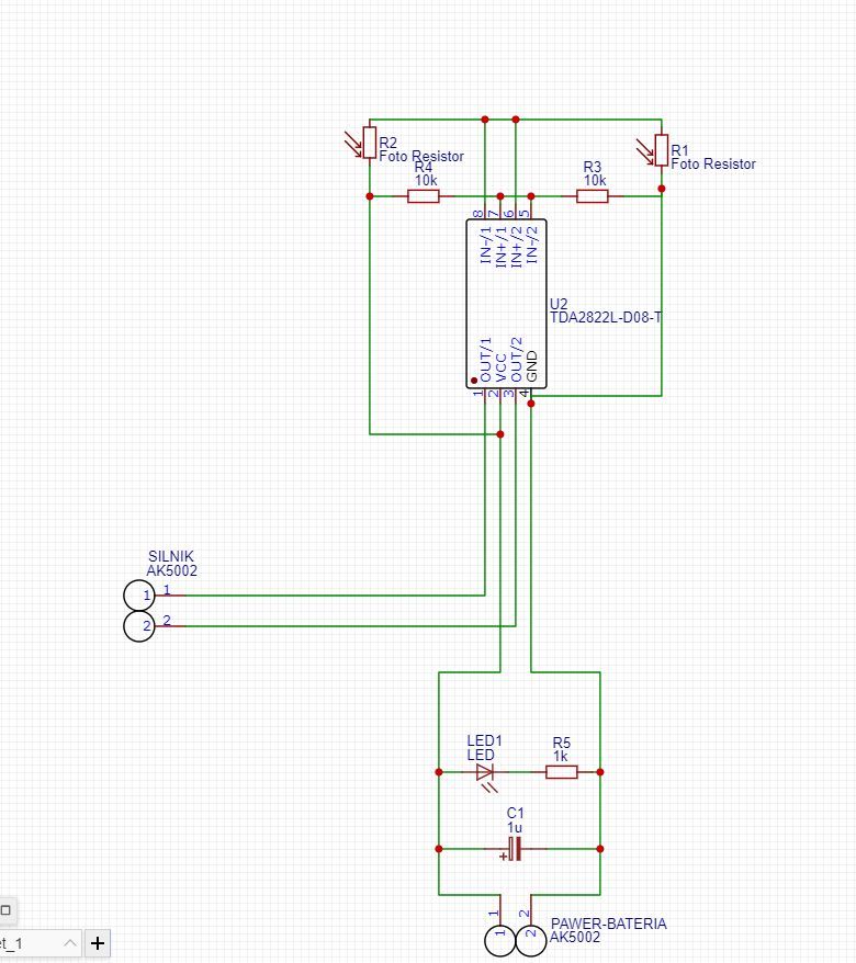

    I'm presenting the project SOLAR TRACKER based on an integrated circuit (TDA2822 amplifier). The SOLAR TRACKER PCB prototype and diagram were designed with sun tracking in mind, which allows the solar panel to charge electricity on sunny days.
    Is the PCB design and schematic correct?

    [/youtube] Solar Tracker circuit diagram with TDA2822 amplifier, resistors, photoresistors, and a motor.
    PCB prototype and diagram that I designed:
    Electrical schematic of a solar tracker controller with TDA2822L IC. PCB design for a solar tracker with components such as U2, LED1, resistors R1-R4, and a 100UF capacitor.

    weteranPL
    Posts: 451
    I routed the paths differently, is it better in this project?
    SOLAR TRACKER Project Prototype: IC TDA2822, PCB Design & Schematic Review Needed

    I understand this is for azimuth tracking. I would also add a second system to track the angle of inclination. I wonder how it will handle the day-night-day transition, but the concept is interesting. Let me know when you run it.
